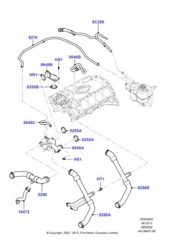

Hey guys, driving an 05 LS V8 and it seems my car is going down on me. I'll start with the story making it short,, my car overheated randomly driving to town..I only made it about 3 miles then it made a chime noise and i noticed it was really hot..never happened before. So I shut it off right away and let it cool..turned it back on and drove it back home and it went it's back to the middle temp range since. I thought that was good but now I have no heat. So I did the bleeding procedure tonight step by step...maybe got some air out? Not for sure but anyway I did get some luke warm heat at 90 degrees full fan. But once I did the 75 degree 2 minute idle then shut off to cool down and fill to proper level, I started it back up and it's as cold as ever. So I drove to town with no heat bought some more anti-freeze and drove back home. I get out pop the hood and my degas bottle is boiling! So I think bad head gasket because that's a big symptom. I checked the oil cap its clean and the stick it looks good not milkshake color. So I also researched on the DCCV but it looks like half the vents are warm and half are cold with that issue? All my vents are cold though..I grabbed the coolant lines. One is cold 2 are warmish but not hot. I replaced the 10A fuse under the dash for the DCCV but no difference. So I am stumped, praying it's a thermostat...I know it doesn't sound like one but I have one on the way anyways.
I'm asking this because the forums I've read on here, everyone says a head gasket is uncommon to be bad or never heard of it being bad. And that it's most likely another problem but what am I missing? It also has no leaks I forgot to mention. No heat, boiling antifreeze in the degas bottle..and all sorts of weird noises when I turned it off. Maybe it's got a lot of air in it? But something must be bad to let air in or no?
