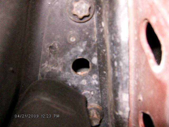

I want to ask people that have already dropped K , is there alinement dowels on the K that stick into frame to line up fast? Looks like I see them in the front of K. I feel lucky all 8 E-18's came loose no problem. :D
I think there is some kind of alignment pin/dowel, but I can't remember 100%.
As for the E18 bolts, I'm pretty sure I used a 6-point 14mm.....
No dowels or pins. Holes.
