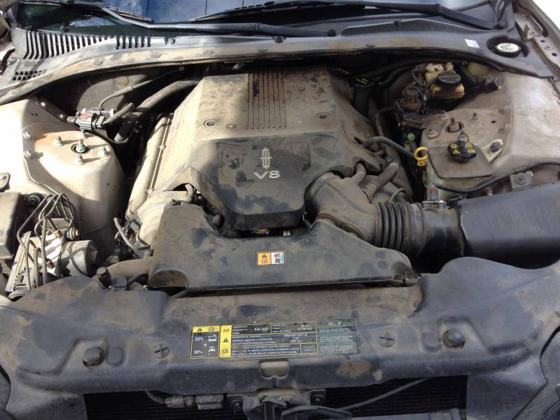

Oh good the Pictures work. Here is the engine when bought. 2005 Lincoln LS 006.jpg

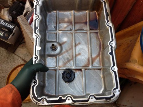

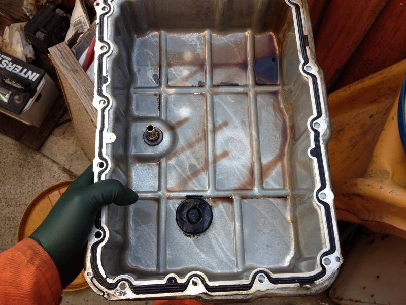

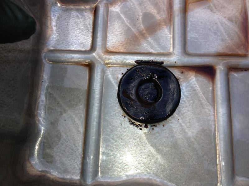

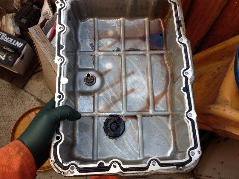

Also my transmission pan when dropped. Not good but not bad either. Plenty of friction material on the magnet but not excessive (particularly if it has never been dropped) and no shavings or debris.2005 Lincoln LS 028.jpg2005 Lincoln LS 029.jpg

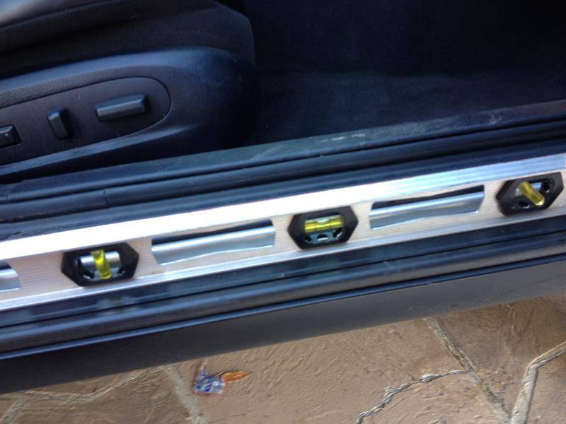

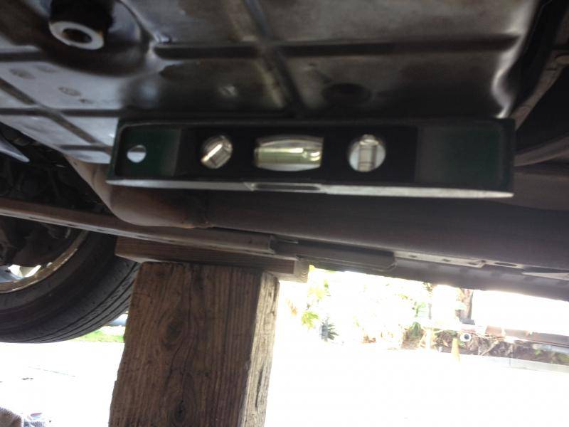

Thanks Don. So when I leveled the car to fill the transmission I leveled it using the door runners for front to back as I figure a lift will pick it up as it is oriented to the ground so that would be level. I also took a measurement at the pan and was correct sideways but it is over a full bubble out. The back of the pan is higher than the front by better than a quarter inch when the car is level at the doors. It is not a huge discrepancy but I found it noteworthy so I included it for discussion. Maybe I am half a bubble off myself2005 Lincoln LS 039.jpg2005 Lincoln LS 043.jpg!

Is it hard to get the front a little higher or the rear a little lower? Most important would be side to side because of the position of the fill tube. I'd say 1/4" would be good enough,since it's in the middle of the pan front to back. don-ohio :)^)
It would be easy, I just am not 100% sure which is right. Common sense says the pan but I am betting the chassis being level is correct. Don't ask me why. It just seems like things about this car are counter intuitive. Anybody know for sure?
Actually I used the 2-post lift on the four jacking points of the car and I didn't level the tranny pan. So you are probably right. OTHERWISE they would have to put different adapters on the front or rear . don-ohio :)^)

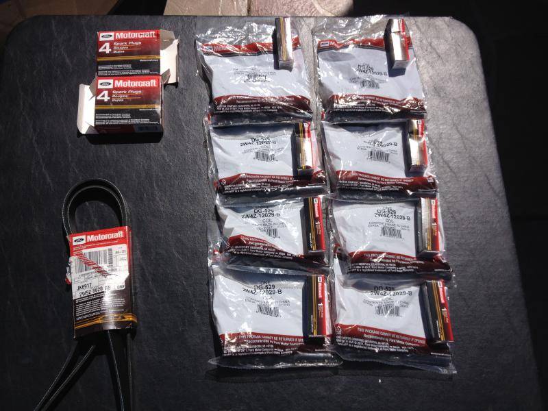

So Just a little reality check for me. Come this Wednesday when my coil packs arrive I will be swapping them out as well as eight Motorcraft spark plugs and my serpentine belt. I will certainly blow out the spark plug wells with compressed air before I remove the plugs , then I will do a compression test while I am that far a long. I was considering a Seafoam treatment before I change the plugs but I am hesitant. While I have completed the seafoam treatment several times on my equipment and outboard motors but I feel that it might be unwarranted on such a high tech gadget as my LS. I have laboriously searched the forums on this topic and there are pros and cons. My main concern being a new code has developed along with my original code of P0301. I know have an additional code P2196 O2 sensor biased/stuck rich. Well this is consistent with a misfire on cylinder one sending unburnt fuel through bank one exhaust and catalyst. I do not want to foul what may be a perfectly good sensor. I have barely driven the car maybe 75 miles since I bought it because I do not want to destroy my bank one catalytic converter. I have already noticed the rotten egg smell from the small amount of idling testing and driving I have done so I am very wary of forcing a bunch of wet sticky carbon smoke through the exhaust right now. However I understand now would be the perfect time to do it so I need to make a decision and I would appreciate all sage advice here. I fully expect my compression test to come back 100% normal and changing the COPS+plugs to cure my cylinder one misfire and stuck rich O2 sensor reading as well as to make my transmission shift better once I reset the computer via disconnecting the battery overnight. What do all of you think? Seafoam the hell out of it before I change the plugs/COPs or should I just forget about the Seafoam treatment all together?

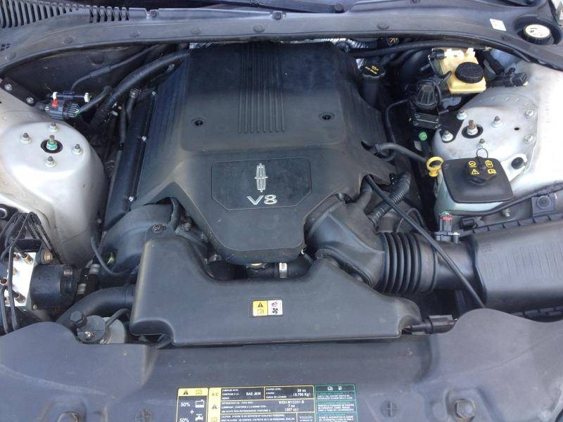

The plugs all looked pretty good/tan. They were plenty worn as the gap was 15-20% over 1mm except cylinder #1 which was a little fouled but if that is the bad coil pack identified by the pcm it makes good sense. Small amount of oil in some plug wells so I will order gaskets. Also I broke 2 retaining clips on the coil pigtail drivers side cyl 8 and 6. Dang It! I will probably use small zip ties temporarily. I haven't searched yet, anyone ever fix these? Anyway, my wifes car needed the love today in the order of new brakes so I will get back after the LS tomorrow.Lincoln LS 007.jpg

That is correct Joe, a picture of all parts used in post #90. Eight new plugs and coils. All Motorcraft. I will check the connector and wiring between 1 and 2. Would the PCM clean up like that intermittently? I will search how to test a PCM unless someone has a link...
