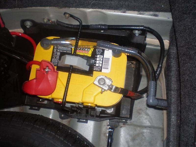

Anyway, these batteries we're discussing ARE NOT GEL batteries as someone stated. They are Lead Acid, Absorbed Glass Mat (AGM). The trunk is certainly NOT VENTED; that little tube the factory battery connects to does not constitute a "vented trunk". Gases follow the path of least resistance, and given the weather striping sealing the trunk... the path of least resistance would be to enter the cabin. So not only are you risking poisoning your passengers (and yourself), but you're allowing a corrosive gas into the interior of your vehicle. If you have no regard for safety/heath or the interior condition of your car... by all means, do whatever you want.

and it's fully sealed, no venting needed

Thank you for posting this "pektel",
I had to jumpstart my car tonight and I guess that means its about time to replace my battery.
I have a Red Top Optima setting in the garage that I think I'll go ahead and use. I printed off your picture and will be going to the hardware store over the next couple of days to go shopping for parts to make your custom vent tube setup. :D
