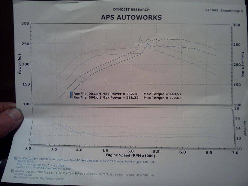

Baseline run piping hot after getting here 252rwhp on just the chip tune. A/F ratios around 12. Stay tuned...;)

I will have a WOT video soon. The car put down 268rwhp at 98 degrees fahrenheit :eek: Less than optimum conditions and the car wasn't spun on the rollers completely cooled down. On a better day maybe 275:confused:
There was a spike on the torque but we're guesstimating around 265. Both shifts complete at 6900 rpms and the torque converter lock-up was delayed until about 90 mph. It was originally set to lock up at 80 mph and I could just feel the bog that I have been feeling for so long with this car on the mail-order tune. Now it pulls A LOT harder into 3rd gear. :cool:

SAE correction I believe was 272rwhp
I'm not I guess absolutely certain about what's best into 3rd gear for lock-up at this point as far as the track but it was noticeably faster when we delayed it to 87mph and then when I finally suggested 90 mph. I am certain that the car is much slower with lockup immediately into 3rd at 80 mph.
So I've still got 30+ RWHP on you, guess I'm safe for a bit. :cool:
How does it drive? What A/F ratio did they set it to?
Are you going to post the dyno chart?
It drives much nastier too be honest. I like everything about the tune. :cool:
Here is the dyno chart:
BTW, the waviness up top was a strap on the dyno coming a tick loose and the car doing the bouncy bounce for a second. :facepalm:

Well, I'm glad that you're happy with it. Looks like the A/F is still a bit richer than 13:1, so they left a little on the table
That's what I thought also and when I mentioned it to him I actually misspoke and was talking about adding more fuel which is not what I meant to say. I may go back and have them tweak it a bit more. :rolleyes:

Yes, I agree the "YMMV". BUT looking at my graph I don't think it should vary this much. I do agree that the car is still a bit fat. At the same time, I was trying to stay in the 2 hour limit. They charged me for 2 hours for a total of $425 with a re-tune and I was there for 3. I'm just glad that I got to drive the car about 6 times and have him adjust it every time. A/F ratio tweaking is next. I got A LOT done for $425. :cool:

so where does your extra 25-30 hp come from? are you just a master tuner or does kirk not have imrc deletes or what?

He has IMRC deletes, canton oil pan w/windage tray, underdrive pullies, and better A/F ratios. And that's just off the top of my head. Datalogging has been a strong point for him.
