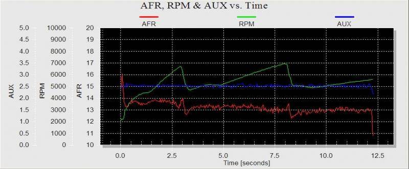

If you're able to datalog the vehicle acceleration rate at the track, dialing in the shift and lockup schedules is a snap. While it may sound like the engine is "bogging", earlier lockup usually translates into a better E.T.
Somebody look at my graph again. That spike followed by a warble on the graph was when a strap slipped on the dyno. The tq/hp are both spiked to get those numbers so my average is more likely to be 255rwhp. I think I'm not happy now. I should have noticed this earlier. :mad:
I can't remember if he let out of it or not at that point when it happened, I was just like oh :q:q:q:q. Maybe the car still would have climbed a bit more on the curve if that hadn't happened? :confused:
It's more likely that the spike is your TC locking (it happened on both runs). But I agree that your HP and TQ numbers aren't really as high as you thought they were. I just didn't want to rain on your parade earlier. Looks like HP~260 and TQ~255 to me.
p.s. And if you look at the graph, you'll see that your TC is actually locking up sooner on the last run than it did on the first, which in my book at least, is a good thing. :cool:
3rd gear lock-up is delayed to 90mph. What you are seeing is before changes were made in those parameters after driving the car and the car almost falling asleep when it hit 80 mph.
