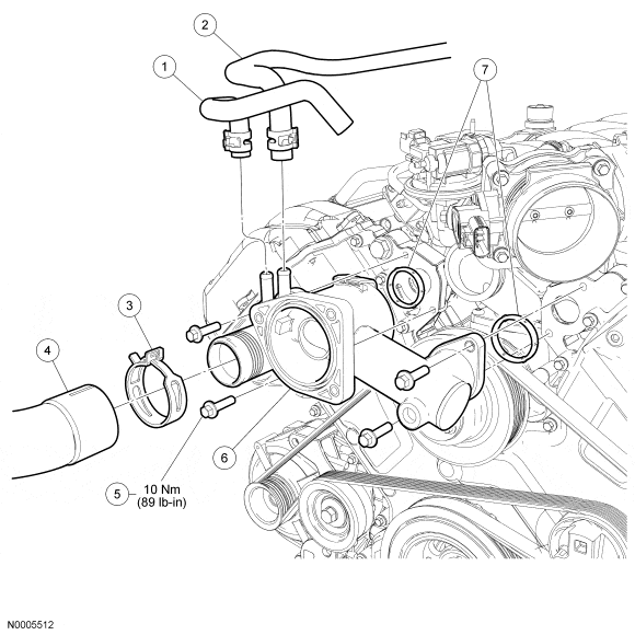

so, shocker here, but the end cap just blew off of my coolant outlet pipe
item 6 in image below
now for the question, I though I've seen a lot of you guys are getting a lot of these brittle @ss pieces of plastic from rock auto. and I for the life of me can not find this part on their site, does anybody know the part number they use??? or how to find it???
also open to other alternative places to pick one up, as always i would like to avoid a trip to the dealer on Monday if i can!

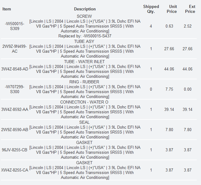

I've pasted a picture of the invoice below of what I ordered. I recommend you replace, at the minimum, everything listed. If you order replacement seals/gaskets like I did, order two 8255A. I accidentally ordered one but you don't necessarily need any of them. You can re-use them.
The invoice replaces these three plastic components -- thermostat housing and both inlet tubes:
Do a search for coolant issues and you will find many threads on this including a basic walkthrough on replacing the components I listed. You will have to cut two bolts off for the second inlet tube (which is the one that failed on me).
Ignore the item with 0 quantity. They had to remove it because you can only order it in a pack of 4 and I don't need 4.

another question, i see that in your diagram, there is a part that does not have a number on it.
in this image, it is part number 23
on the Deneau workshop manual it list both part #23 and part #15 as the "coolant outlet pipe". it looks like it connects the main coolant outlet pipe to the water pump, but it doesn't say anything about removing it from either the instructions for removing the outlet pipe or the water pump. what is the deal with this, is it a separate part? does it come with the outlet pipe? or do i just have to get both pipes? it also looks like the bolts for it are under the throttle body, does it have to come off too to get the rear coolant outlet pipe off ?(this is what I'm going to refer to it until some one give me a better/proper name for it)
EDIT: is this part, the "Tube ASY" in your parts list?
It's a separate part. The part number is 9N499. It's a common failure point and is the issue that I had. The ring plastic ring at the front that is part of how it seals with the outlet pipe became brittle and a piece cracked off causing a leak.
It's a bit of a bitch to replace but definitely recommended. It's under the throttle body so you'll have to remove it which is a bit of a pain. The bottom two bolts for the throttle are a bit hard to get to and even harder to put back in. Like I mentioned in my previous post, you'll have to cut off the two rear bolts for the outlet pipe and replace them with a new, shorter version that you either make yourself or buy somewhere. I just ordered a pack of replacement bolts with the rest of the parts (the SCREW listed on the invoice) and, as suggested on this forum, cut two shorter as a replacement.
You'll need a Dremel to cut the bolts out. I can't imagine anything else exists that's small enough to get in there to do it. If you don't own a Dremel, pick up a cheap one or borrow one from a friend and then buy a pack of cutting wheels because you'll likely go through a handful.
