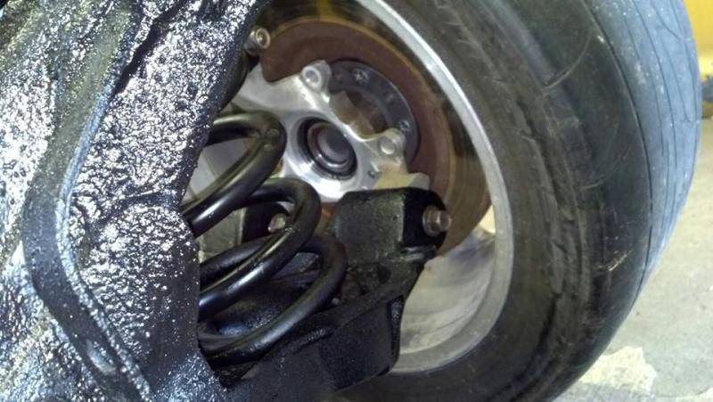

hows my rear hubs coming? ;-) lol
you need to put an axle stub shaft and nut on there.
these bearings have been known to separate without the clamping force from the axle nut.
Thanks all.
I've rolled it around like that for 10 years Chris like that... <shrug>
I dont remember the rear tires being drag radials! when did you put the 555R's on there?
Those are the wheels from the SVO. I had them on the truck when I put the Bullitts on the SVO to see how they looked.
