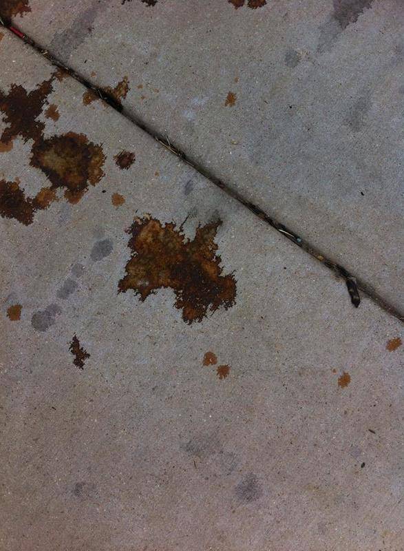

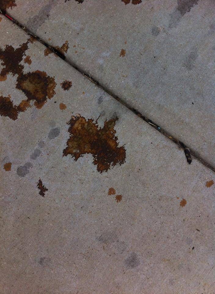

I looked on the pavement outside what I thought had been oil from changing my oil before the trip and it might be the hydraulic fan fluid. I looked at the reservoir and it seems there is none in there and at the bottom of it the other pipes seem to be covered in whatever is on the ground. Do you think the fan motor is fried? It's kind of a yellowish color.
wade0731;2037357298... Do you think the motor is fried?[/QUOTE said:
No. Running with the reservoir empty won't hurt the fan motor. However, the hydraulic pump may now be toast (which would keep the fan system from working). I'd clean it up and refill the reservoir. If there are no immediate leaks, then start the engine and see if you can tell where it is leaking from.
That is what it looks like on the ground.

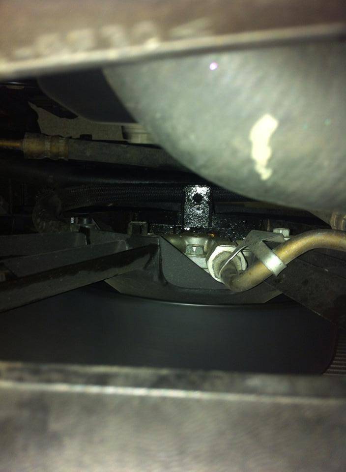

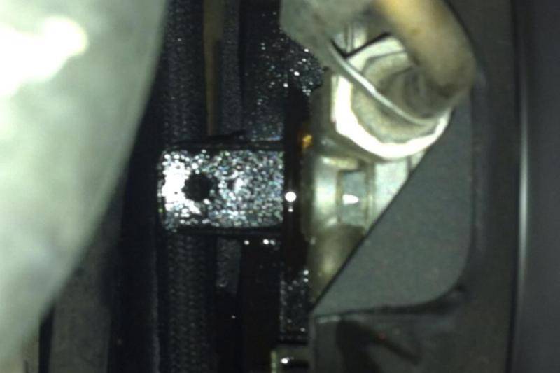

Okay yep, that was it. Filled it up and the fan ran again! Hallelujah! However it has definitely been leaking. I have pictures of where it is leaking by the nut in the middle of the fan shroud I think.

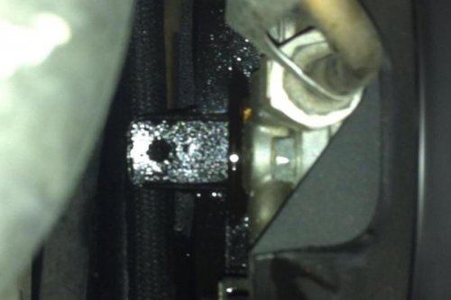

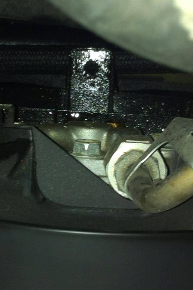

Here are pictures where it is leaking I believe. 10570975_10152218421116759_87657908_n.jpg10588605_10152218421121759_359587204_n.jpg
Not so much. You'll have to tear into it and find the source of the actual leak. What you are looking at, could just be where it is dripping down to. Use brake parts cleaner to get it clean enough to find the leak if you can't see it coming out.

I did do that. I have pictures of where it is leaking above.
Hard to tell from pics, only you will be able to see where it's actually leaking (it could be from anywhere above the pic). Do you see it leaking from the assembly itself? If so, you answered your own question.

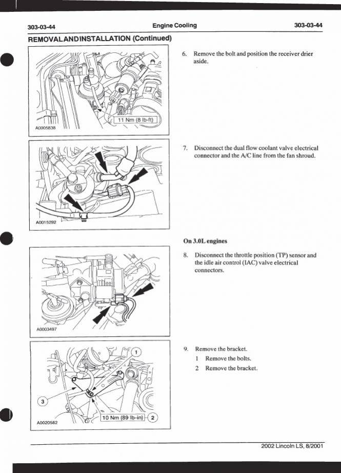

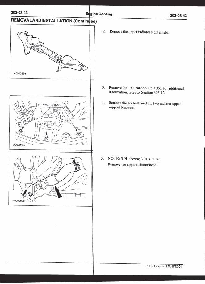

I was reading this post:http://www.lincolnvscadillac.com/forum/showthread.php?77269-hydraulic-fan
And Quick LS said in that thread: here is a hydraulic hose running from the pump to the fan pump - and it always breaks right at the neck of the coupling on the pump.
Where is this loated exactly?

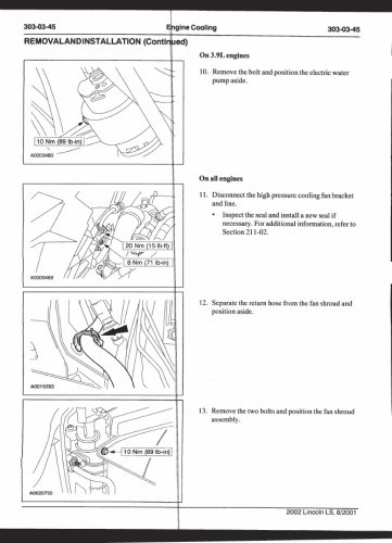

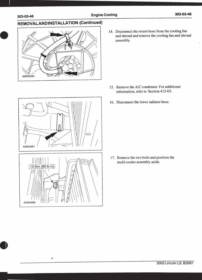

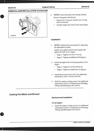

from your 02 OM, downloaded in the Tech articles.

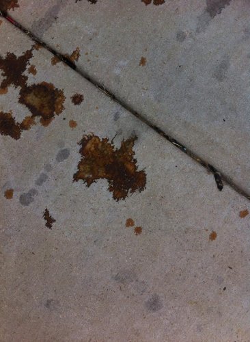

That is what it looks like on the ground...
Hmmm ... corroded rusted out GM DEX-Cool orange drippings ?
