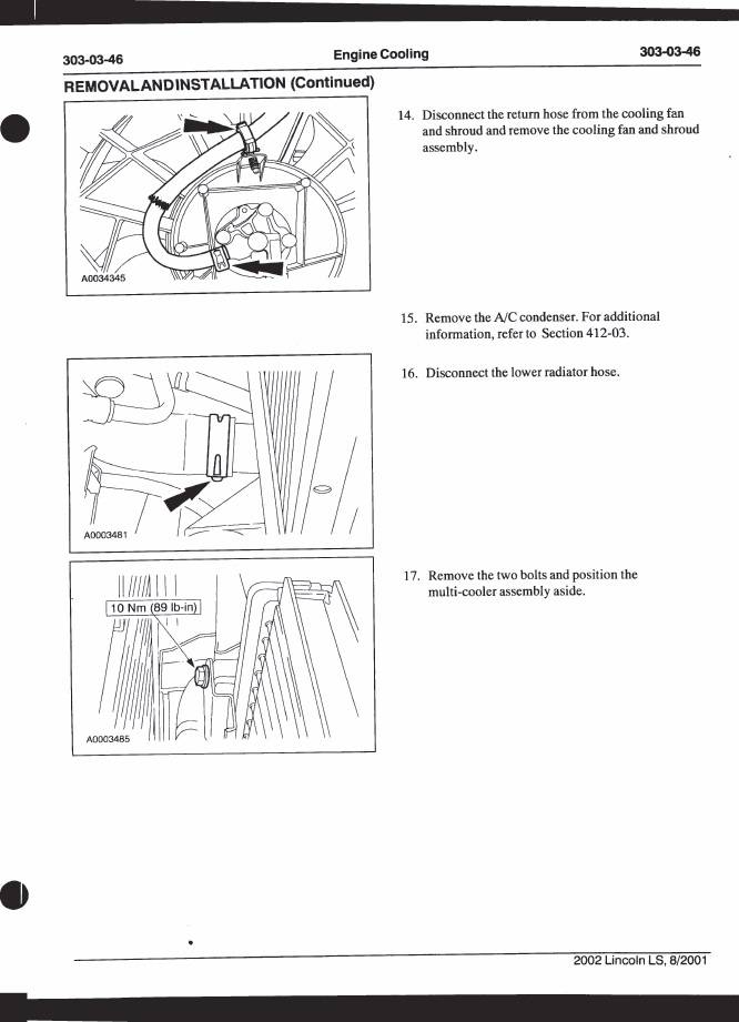

@Joegr Whatever is in the following picture, pump or motor on the top left of this repair page is what I took out and put in. Sorry I don't know exactly what it is called, I'll try to stick to one word. I had took everything out and there was tons of hydraulic fluid all on the bottom so I thought it was leaking but I guess not. I cleaned everything up pretty good so I'm going to dig into it again and see what is going on. As for the coolant issue what do you recommend? I didn't even see a fan pump motor, where is that even at on this car?
That's the fan "motor." The "pump" is bolted to the passenger side of the engine. I don't think that the little bit of death cool that you put in will be a problem. Of course, a full flush of the cooling system (even if you had not done that) is not a bad idea.
