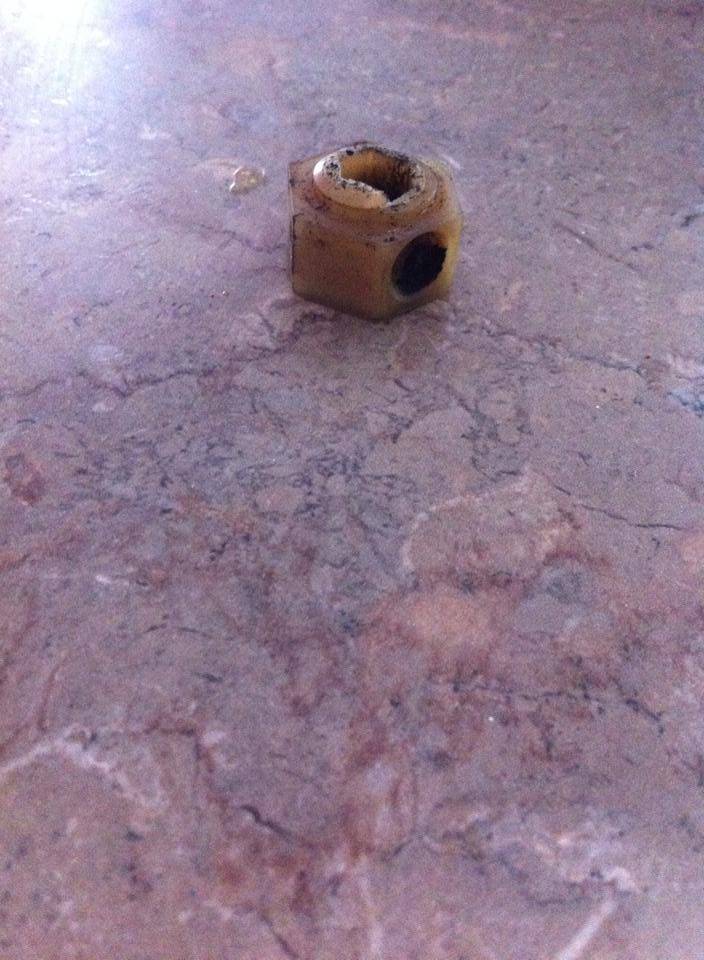

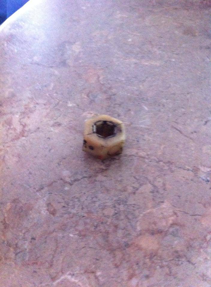

Also Joegr, you know at the bottom of the passenger side where you let all of the coolant out of the cooling system (degas bottle cooling system), I was tightening the hex bolt head and it snapped off but iI had it tightened enough and it doesn't leak out of it. How do I replace this part?

You're not talking about the radiator are you??? That would require a new radiator. Any pics???
Yeah... I'm not using them again. Really ridiculous. $300 for labor to put it in. I'm going broke lol. Here are some pics of what I was talking about. It broke off when I tightened it too tight. It's where all the coolant can be drained.

10621086_10152236655406759_676203422_n.jpg10602851_10152236655721759_1908847796_n.jpg
Why do people keep doing this. There's no reason at all to get it very tight. It just needs to be tight enough that it won't vibrate loose. The tightness does not effect the leak sealing. There's an o-ring for that. The plug just has to be screwed in far enough for the o-ring to be in the right place.
You might go to u-pull-it type junk yard and recover a drain plug from a radiator there.
Yah well, learned my lesson I guess. Theres no part you can order online? I need this to flush the system don't I?
