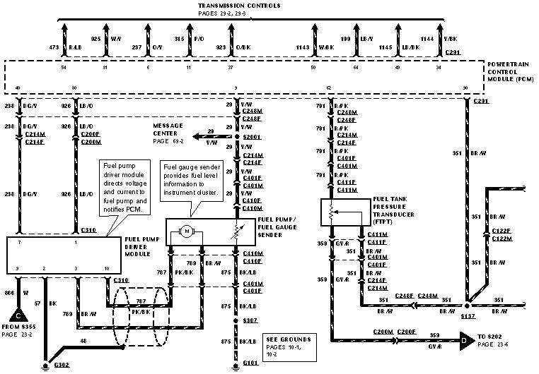

Check your FPDM. It's bolted to the support brace on the right side of the trunk behind the liner.
most likely its the FPDM i used the highly technical advanced search option and read about it so Rich is sending me one....Thanks Rich.

I think there's a couple of wires connected to the FPDM in the trunk that you can jump to see if the pump turns on
You can bridge the wires at FPDM plug to test the pump. No need to replace the unit only to find out it's something else.

how do i jump those wires cobrastar?
Disconnect fuel pump driver module and jump power and ground to the brown/white and pink/black wires.
