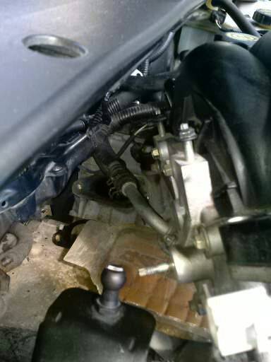

Do note that there is a hose connected to the bottom rear of the Intake Manifold. You will not be able to remove it entirely until you disconnect this hose. Here is a picture of the hose.
Also be cautious when removing this hose, for it doesn't like to come off easy. DO NOT scrape or dig into the metal line that it's connected to. If you do, there's a good chance it will leak. If you need to, step away and yell at your dog because it's his fault. Then when calmed down, continue. Be patient, don't break stuff.

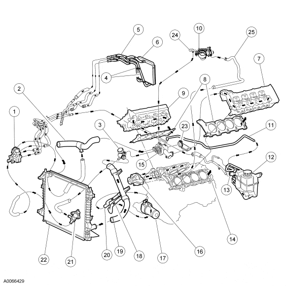

Where does this hose at the back of the manifold fit into this diagram:
And if it's not here, then what does the hose connect to? Around the driver side of the engine and back to the thermostat housing "tree"?
...And if it's not here, then what does the hose connect to? Around the driver side of the engine and back to the thermostat housing "tree"?
It's not on that diagram. It's a vacuum hose that connects to a check valve that connects to the brake booster.
