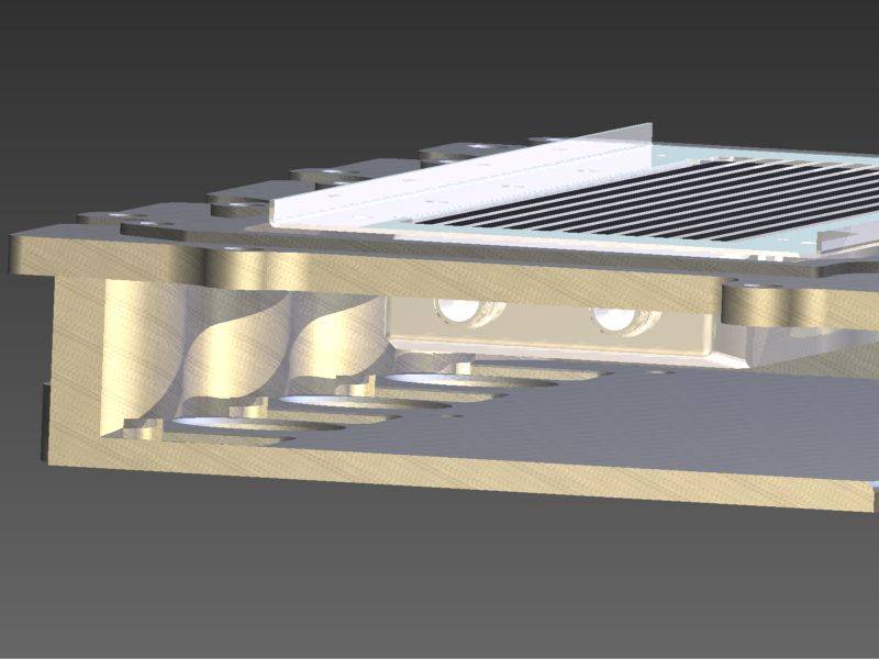

See that is exactly what I am saying could be intergrated into the new setup hes trying to make. If that smaller heat exchanger could be mounted so its fins cover the entire blower opening then it would be the same air to water intercooled setup.

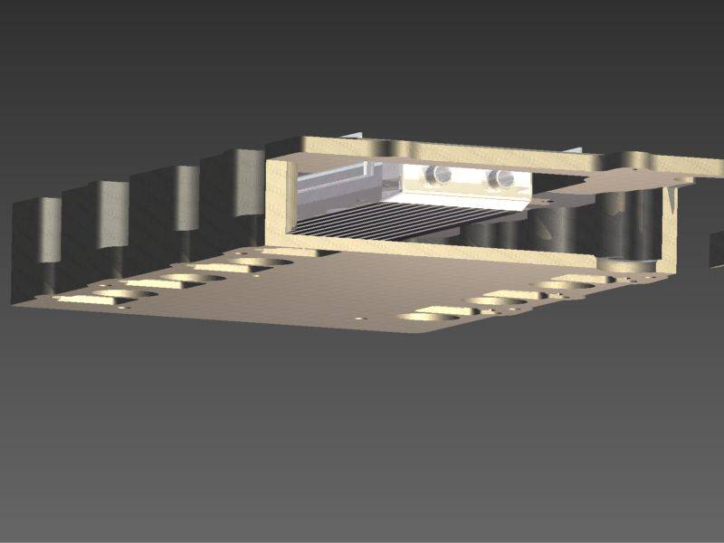

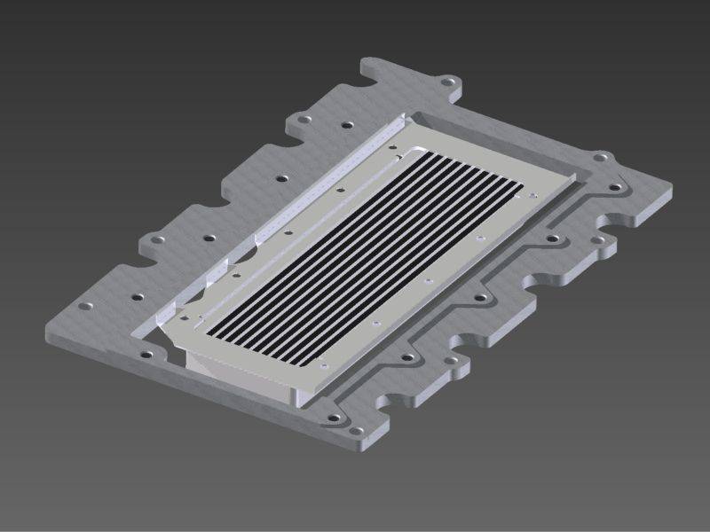

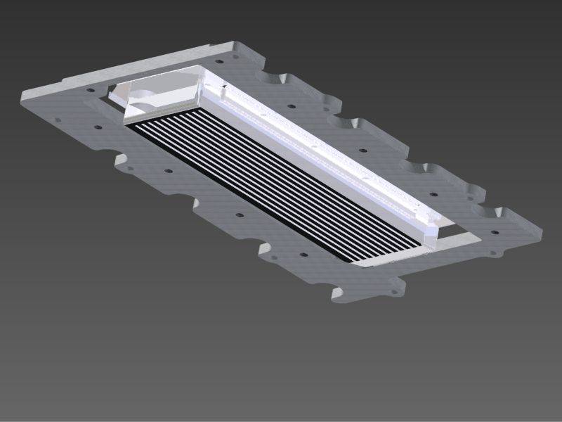

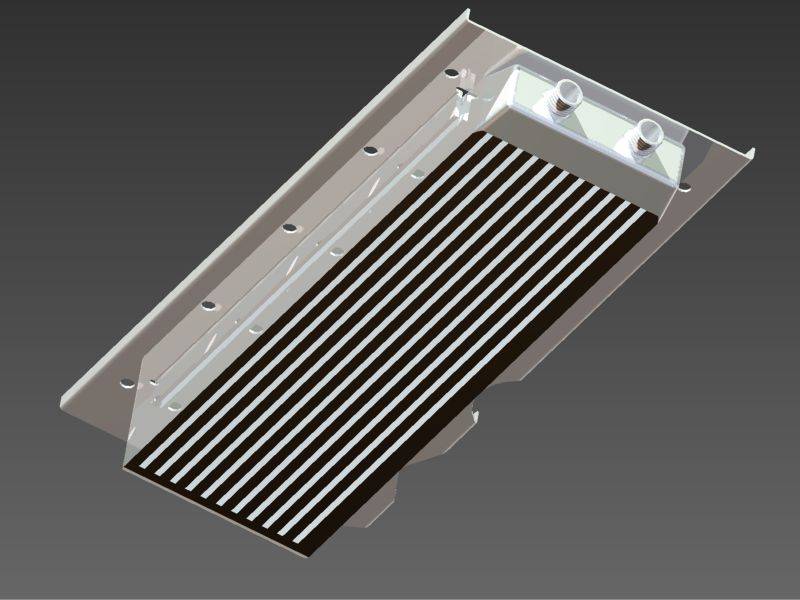

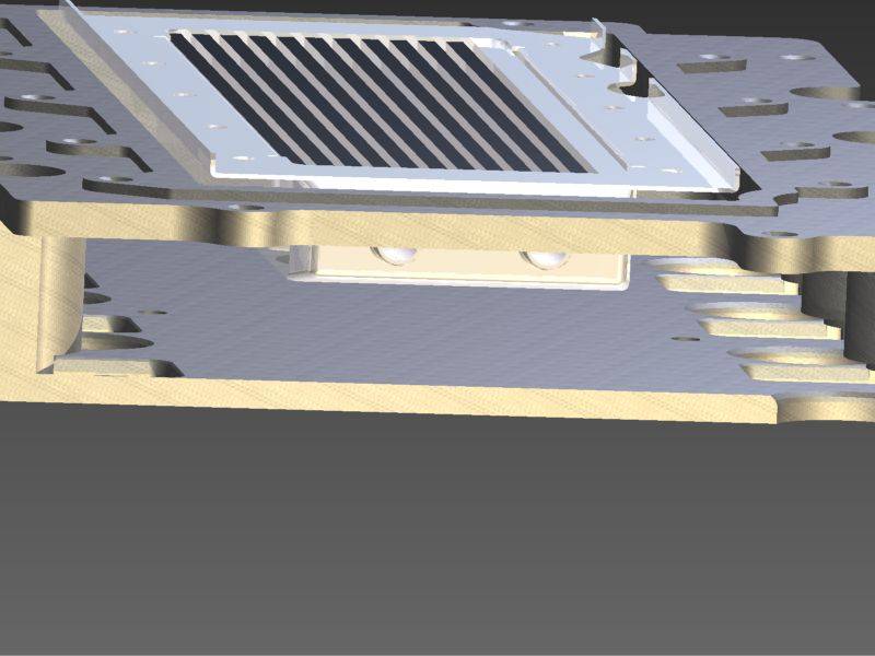

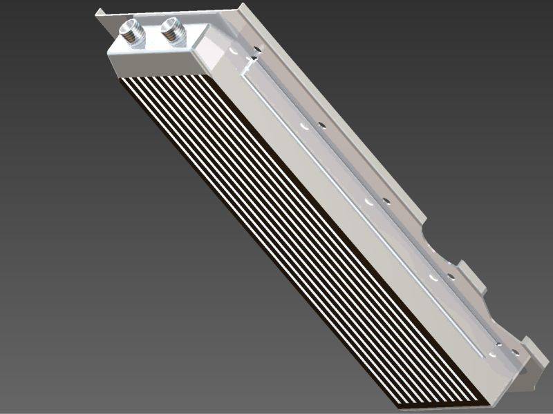

Anyway, after alot of phone time with Bell intercooling, I found a core tha will work with what we need. I know I am going to get people saying that it's not big enough, but I'm not very good at cramming 300 pounds of :q:q:q:q into a 2 pound box.
The core pictured measures 12X3.7x2.25, and will leave plenty of room beneath it to flow air. I'm thinking that wilth a HVHP water pump and an efficient Heat exchanger, it should do just fine. Anyway, I still have alot of work to do in designing the end tanks and finding a cost effective way to have them consturcted. (I'll probably end up TIG welding them myself, so we will have to see.)
But anyway, Here is a preliminary rendering.

The 03/04 guys and Ford has called them intercoolers for years, but they all cool the charge after it has been pressurized.
That is just how I was thinking. You could use that larger one I posted as the front mount heat exchanger. Its slim and long and would fit great behing the bumper more like a Cobra then the SuperMark. Canton makes a small coolant catch can for the cobra that would work well in this application.
http://www.lethalperformance.com/03...cobra-intercooler-expansion-fill-tank-p-11463
Cobra pumps are cheap on ebay too.
Another alternative to mounting a front mount heat exchanger would be to use this instead. http://www.lethalperformance.com/03...id-03-04-mustang-cobra-killer-chiller-p-25018
It hooks to the A/C and would really cool the system down.
I have a guy that would be willing to help with the welding, he makes intercoolers for very high boost systems so his work can be trusted. It would be free also.
