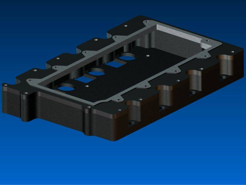

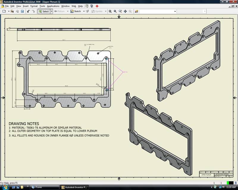

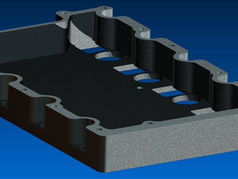

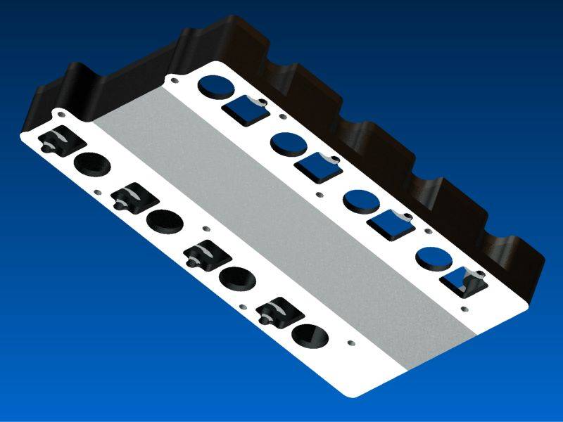

1: You guys SUCK. :D :D :D :D It's my fault obviously BUT I have a hard time believing you did'nt notice the intake ports were not correct. I had to completely redo the design. Notice the new renderings versus the older ones. That was a few hours worth of time toredo the model. PLUS another few hours for DWG detail and dimensioning drawings .
2: My graphics card shot craps, so I had to wait till I had a day off to install the new one before continuing. My onborad graphics will NOT handle Inventor's needs.
Anywho.......sending the NEW files to the machine shop tomorrow.

How thick is the rear wall of the plenum?
I am wondering if a meth injection nozzels head is long enough.
keep up the good work man. like many others i am VERY interested in this, keep us updated. kudos to you for stepping up to the plate and doing this.
I'm sure it will be fine.
IF needed, I could have the meth injector holes counter bored, that would be enough I am sure.

Will the dampener turn the supercharger? I ask this because if it will the supercharger will have to be moved aft a few inches.
I apologize if this has been covered, but are you going to be able to produce these for others? Your "flat torque curve" has me interested, I enjoy seeing your progress..
Also, if you're worried about hood clearance for the inter/after-WHATEVER, cooler, have you thought about a dry sump oil system? Maybe our K member restricts the idea?
No room to drop the engine enough to clear, so dry sump is out for me. The sc WILL be turned by the dampner, I am doing a custom re-machined Eaton snout and driveshaft to make it work length-wise.
