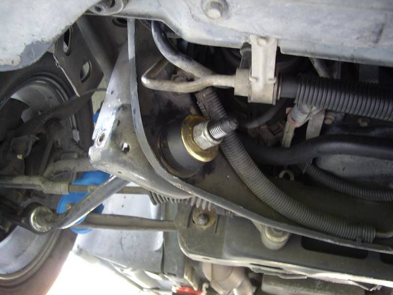

BTW: Anyone know the nut size on the end of the strut rod? Is it 32mm?

Can anyone tell me which bushings are the outer ones and the inner ones in this picture?

So can anyone tell me in that picture which strut rod busings go on the front side of the frame and which go on the rear?
I think the two that are in the same package are the rears. Anyone know?

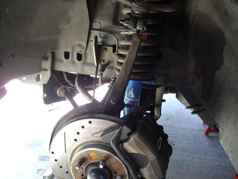

So here is where we are at.
Replaced the new strut rod bushings and installed the new Tokicos all around as well as new poly sway bar end links. One of the rear shock mounts broke and I had to fix it but it came out great! Made a huge difference and handles great now!

My front support braces have not shown up yet but when they do I will post some install pics and give a report.

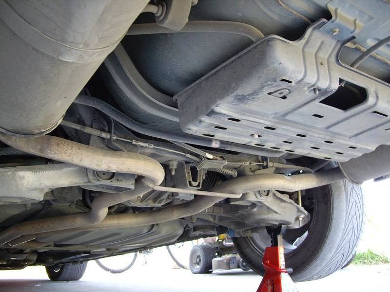

The best part is my shop that I trust (the only one really) is only going to charge $200 for the diff and gear install with it in the car! :D I just have to make sure he has all the parts. That was another reason i figured I would get the master kit.

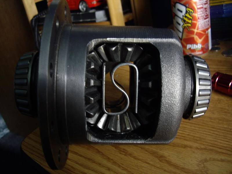

Here is the diff:

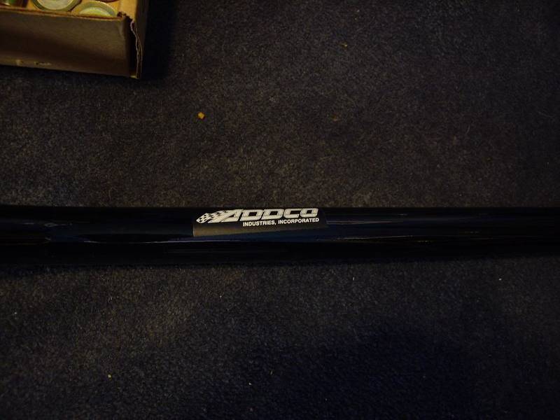

Also today I ordered my Addco 1.25" rear anti sway bar. That was another excellent deal at $134 shipped. :wrench
I should have the sway bar in next week so I will post pics and give impressions of it.

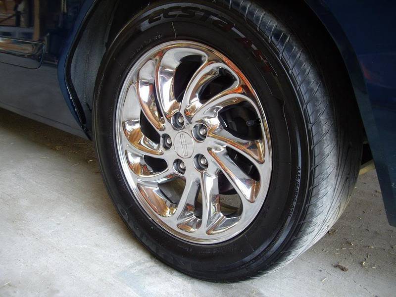

Something to be said about a freshly polished set of 10 spokes. :D
Car looks good! That color coupled with the chrome ten spokes makes for a good looking car. IMO, having no sunroof just adds to the clean look.

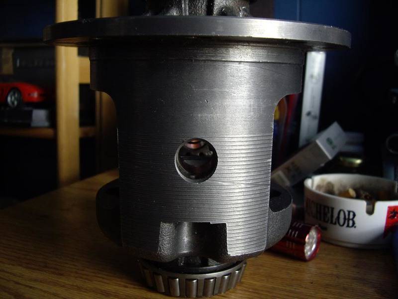

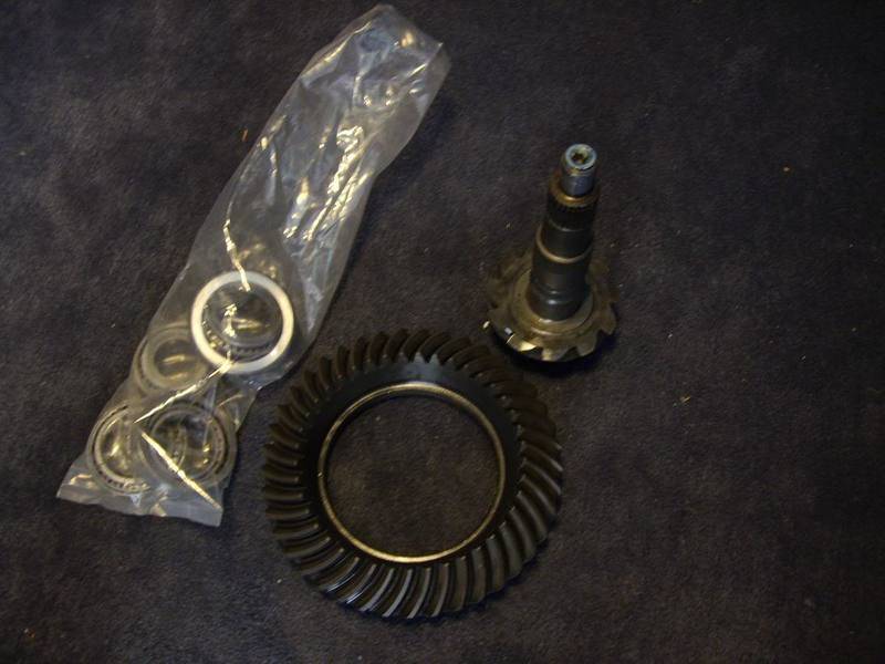

The Diff showed up today! :wrench Cant wait to install it. Quick question, isnt there supposed to be a shaft that goes through the hole in the second picture to hold the gears in place?

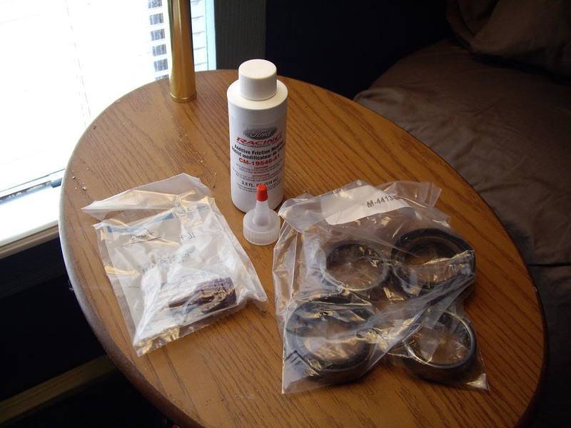

I just have to say that Max is the fukcing man! I have had good customer service before but his is above and beyond! I sent my strut rod bushings back to him (he practically insisted) since I couldnt use them last week. I needed the axle seal/bearings, VSS spedo gear and a bottle of Motorcraft Friction Modifier and gave him the list and asked for him to call me when he gets the return parts so I can give him my credit card for the price difference.
Well MAx never called me and UPS just showed up... with all the parts on my list! That really amazed me because I know these parts had to be a few dollars more money.
Max, you rock! Thanks so much. I will be calling you Monday to order the rest of my stuff for the gear install. Thanks again mang! :)
So just the one picture update with some minor but very important parts.
BTW, the friction modifier is sealed but still is just horrific smelling. :ack:
So some more new toys showed up today. Got the gears which I may send back as one of the pinion teeth has a chip on it. Its not in a contact area so I am not sure.

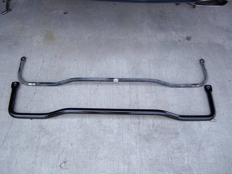

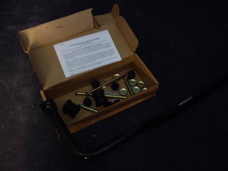

Also the Addco sway bar is here and in about 30 minutes I will go install it. :D
So the good and the bad. Gear pinion has a chipped tooth and some nicks. Fortunatly the seller said he would replace the gears on his own dime or refund me 100% and pay for return shipping. I told him as long as he has a good pinion then he can just send that to me.
Now on to the good! Got the new sway bar in, was a slight PITA getting the new bushings to bolt in but after some swearing they made it. :lol:
At first I didnt think there was any difference (other then the new bar is 3x heavier) but then I went through the turns I know well and saw that the oversteer is gone. Then through the long sweeping corners the corrections are fewer. Dont have to comensate for the rear wiggeling now. Through some slalom driving was a big difference. Before you would turn and the car took a moment to "set" and then would have slight oversteer as you go around the cones (or reflectors in my case :D ). Now it "sets" as soon as you turn and no drama as the tail rapidly changes direction.
Also I have a section of road that sunk down the center of the North bound lane about 2". The car used to hit that and the passenger side would drop and the car would dart to the left some. Now the passenger side drops but the car does not try and go left. Very nice, very nice indeed. The ride has not been compromised at all eaither. It is more solid but not harsher at all.
Only downside is the mount bushings squeak a little. I will give them a little time to set in and if they continue to squeak then I will spray some lube in them.
