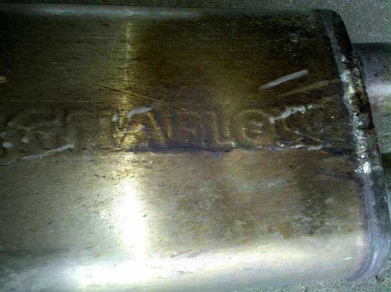

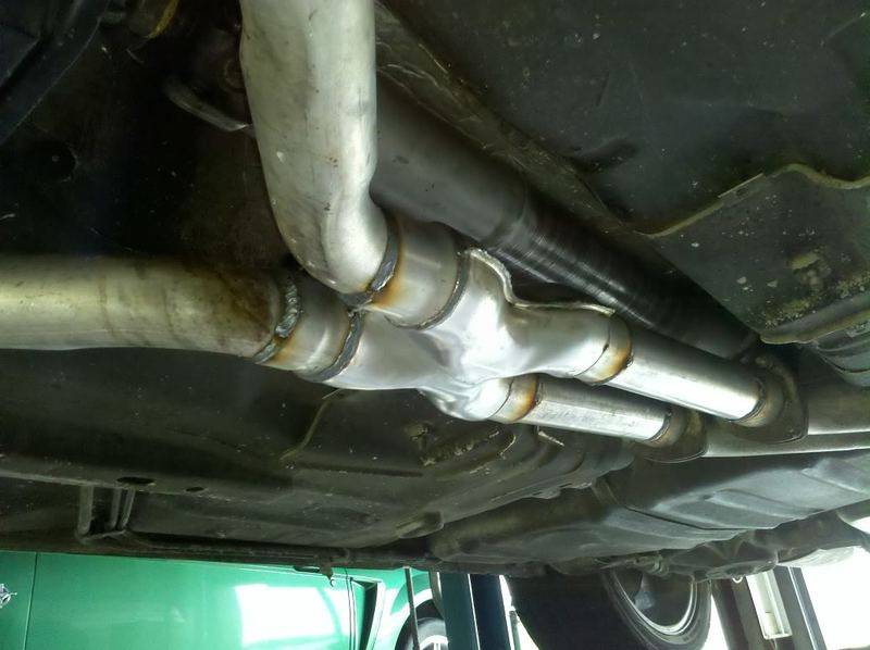

Went and had the crappy Magnaflow x-pipe off and had a standard one welded in its place. What a freaking difference! No more obnoxious drone, car is quiet when cruising around and I am very happy with the tone. Only went with one x-pipe and dont see any reason for a second one.
Must have had a breeze in the shop blowing some of his gas away...pin holes all in the welds :-( I need to get another mig soon so I can do this stuff...i really wish I had the
money for my own shop, anyone willing to help invest in a building gets free labor :)
those welds arent bad whats wrong with it? i have seen some real classy pictures of exhaust on here in the past, that looks mint compared to some of the stuff that has come through here!!! thats a pretty decent job for 25 bucks. 25 bucks barely gets you a good meal at long horn!

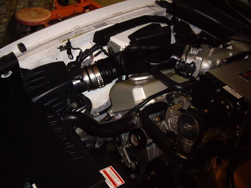

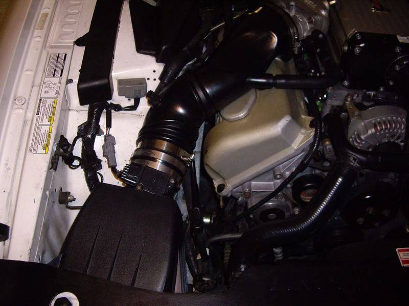

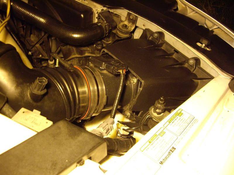

Been a while since I did anything to the car but reading another thread tonight gave me an idea for a semi-CAI setup. With the blower my IATs are always a worry and I wanted to fab up some heat shield. I have no fab skills though. :lol:
So I hacked up my old air box and made a cover for my cone filter. Still need to clean it up some but I kinda like it.
I am gonna find some rubber mating that I can cut to shape and epoxy to the back to close it all off and still be able to wiggle everything out.
You should buy the 03-04 Cobra intake tube, and mate it to a complete airbox with 90maf in there.
I had a picture of one of my cars on here somewhere, it fit like a glove.
The 96-98 fits like crap in the m8 engine bay, as it hits the shock tower and a/c lines.
That's what I've got coming to go with my Cobra Intake...
I may look into that in the future. For now I am leaving it in cause while driving I see a 12* drop and when sitting in traffic I see a 25*+ drop in my IATs. Every little bit helps.

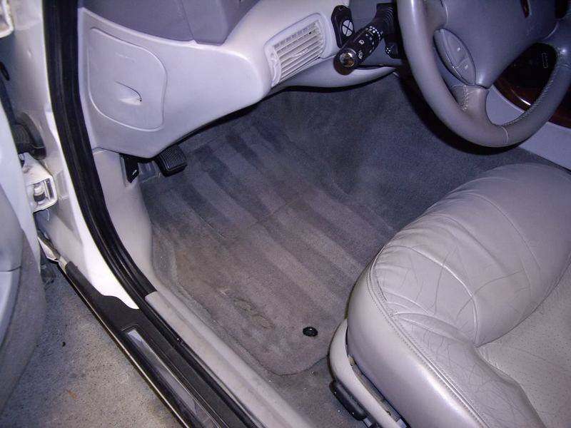

Yay! Fixed several issues for a dollar! Sapperfire scored me some nice parts from the JY for $1. Got some real LSC mats that I just cleaned up, new working fuse panel door and the end cap by the passenger air bag. Mine had a chip in it that always bugged me. :lol:
Now gotta find ya a seat panel and some bolt covers, and remember to get the seatbelt bolt cover from the yard

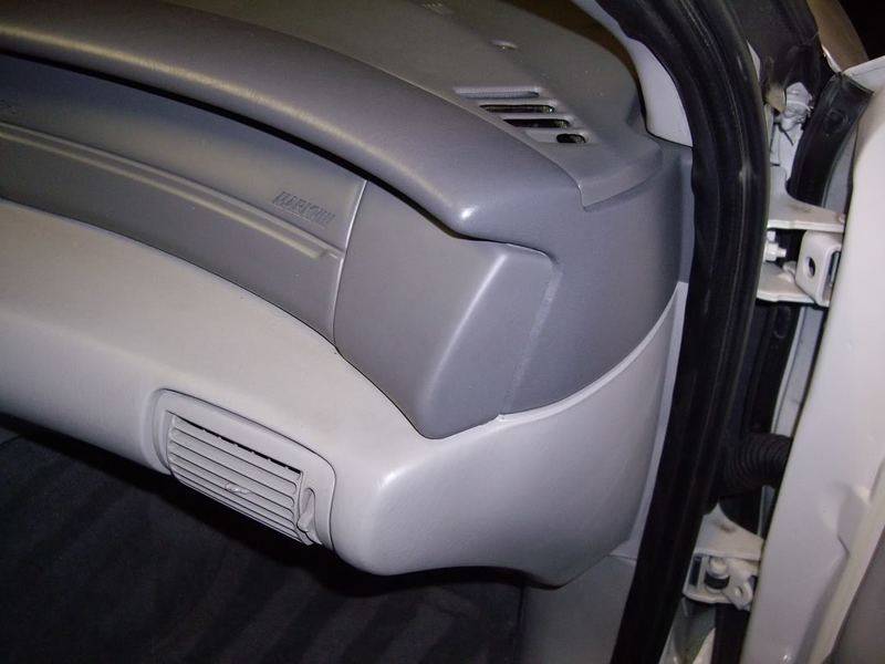

Yay! More goodies!
Sapperfire scored me a flawless controll pannel for the fuel/trip computer. Mine had some knicks in it and pissed me off. Also finally got a seat belt anchor cover! Sometimes its teh simple things. :D

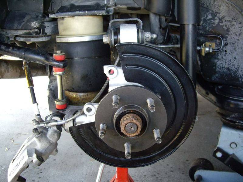

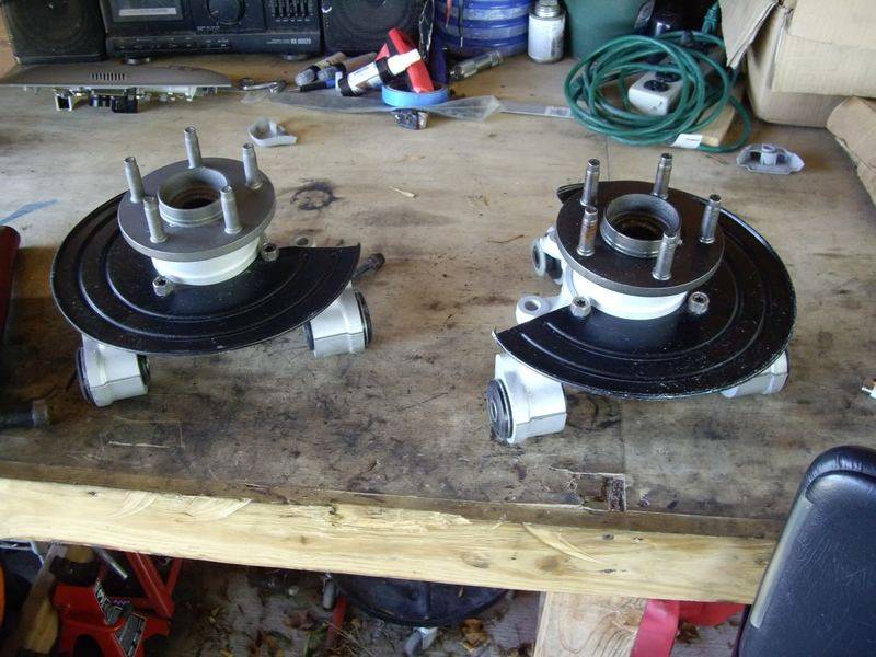

Also decided to swap in my new spindles. Had a slightly worn wheel bearing and SVO loaded up a pair of my old ones with new Timken bearings and cleaned them up. They been sitting on my shelf for several months now though. :lol:

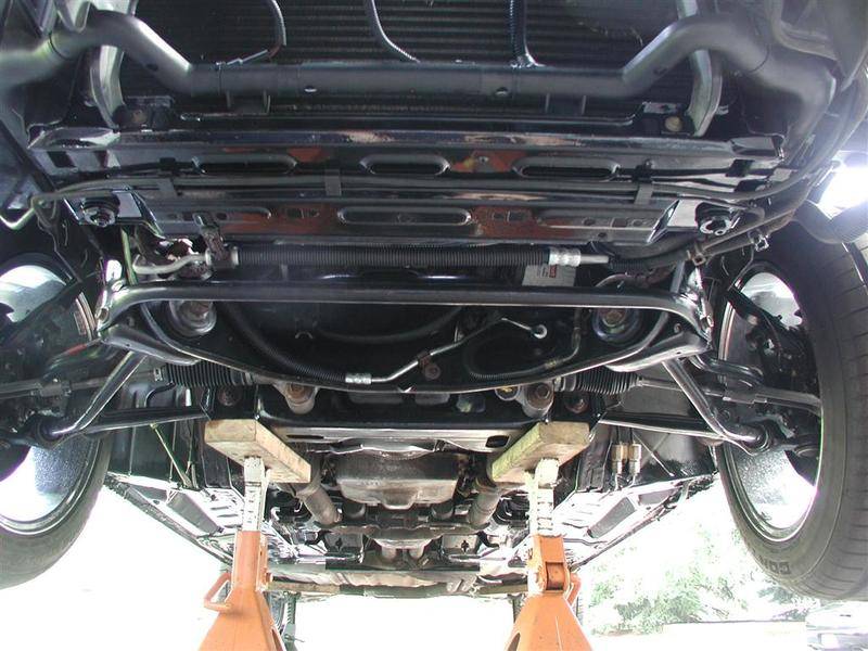

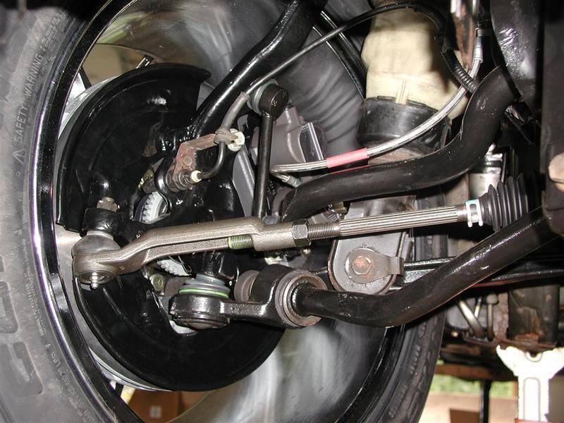

God I love the look of nice shiny parts. Next spring I may end up tearing my entire underside apart. Jeremi got a real good head start for me this past summer on the front. You'd sh!t a brick if you saw the "before" pics. The man is a miracle worker.
Sorry, didn't mean to hijack, you just got me dreaming again.
EDIT: Added one more. Yes I know that sensor bracket looks terrible. That's basically the condition the rest of the front was in.
Nice job man, that last pic, you'd think it was a new car. I hope it handles better with all the new hardware.
