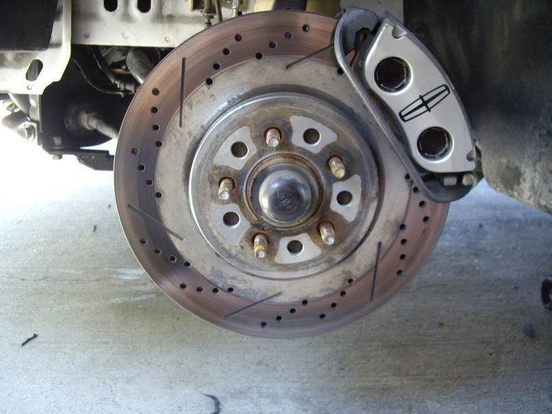

I also dropped my slotted rotors off at the machine shop to be re drilled for my bolt pattern and just ordered some EBC Yellow Stuff brake pads.

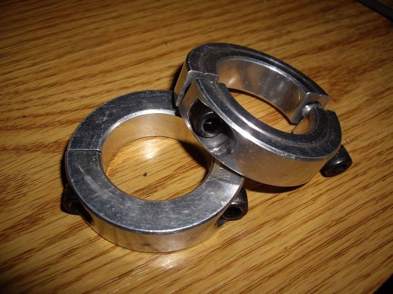

Front sway bar lock collars. My front sway bar was always sliding over to the drivers side and hitting the dust shield and the passenger sides link would get pulled in to the strut.
Called up Addco and they sent me a set for free. :D

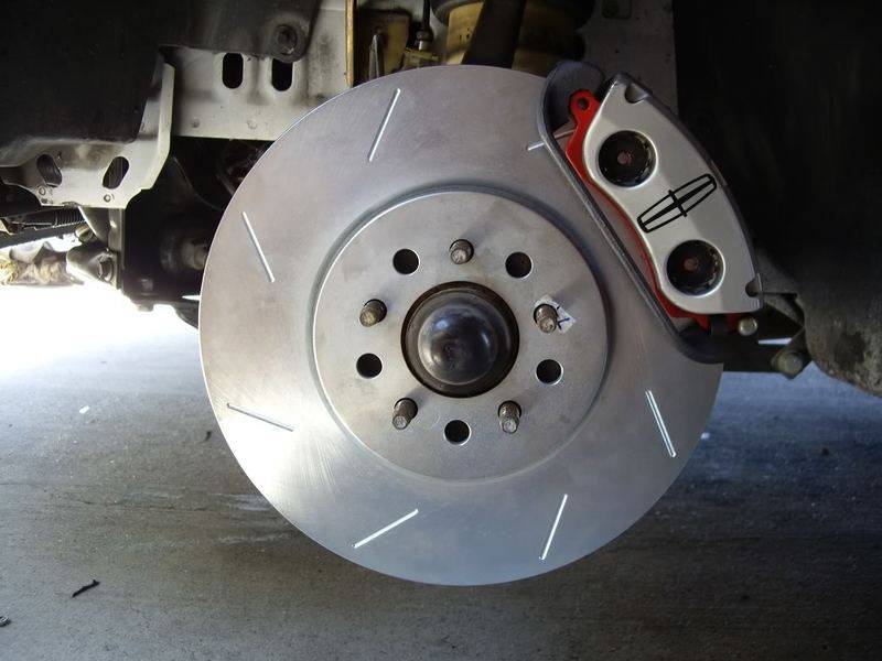

Replaced my cracked to crap drilled rotors and worn OEM pads with new slotted rotors and some EBC Red Stuff pads today. I have to break in the pads still but just normal stopping is DRASTICALLY changed!
Good choice on just slotted rotors... the drilled and slotted combination seem to crack ALL the time. I plan to do Poweslots and Hawk pads on my GT once I get some projects finished... looks good..
