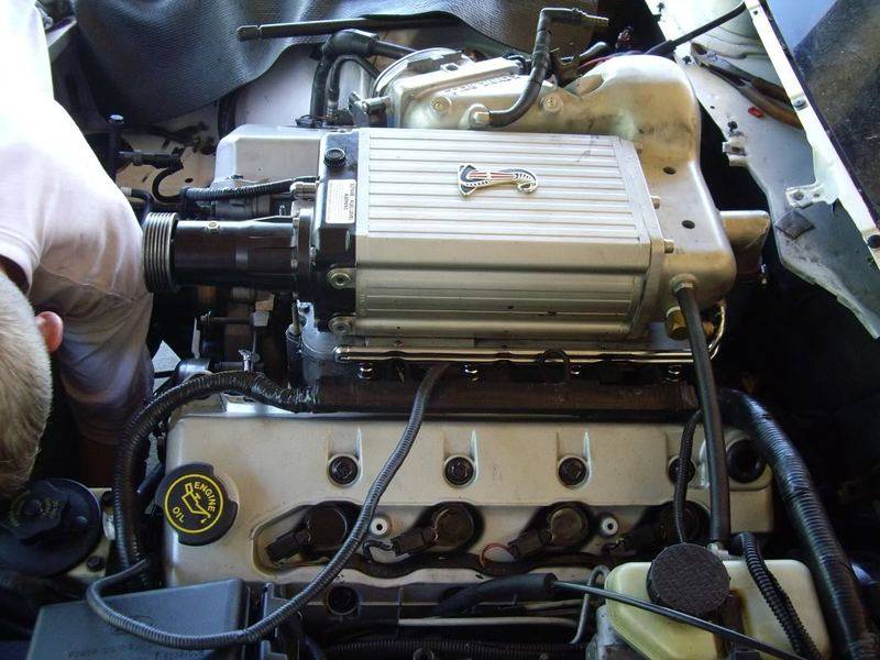

Wow! What a day! First have to give a big prop to Sapperfire as he really busted arse to help me. Also thanks to everyone that made the swap possible!
Started at near sunup again and got the wires sorted and hooked up. Then I cleaned off that unusually strong tape Jamie used on the intake runners. Set the new plenum gasket in place and just kept going until it looked like an engine again! :lol:
So I added all the fluids to it and we attempted a first start....... didn't look good. Engine didn't want to fire. After a few attempts it fired and just ran like total crap and kept stalling.
That pointed out issues 1 and 2.
Jeremy said he smelled gas. I was very sure the injectors and lines were not leaking as I checked and checked and checked. Then I checked again! :lol:
Then I saw the two gallons I just poured in the tank was all over the ground. :( Tilted the tank down and saw I neglected to properly seat the hose which would explain why the plastic lock gave me so much trouble. :lol:
So I fixed that and as I did I saw issue number 2. Forgot to bolt together the exhaust after the H pipe. Thought I had an exhaust leak.... guess I was right! :lol:
Got it all back together and then tried to start it again. That was issue 3. Soaked spark plugs....... sooooooo we let them air out for a bit.
Finally got her fired up and it couldn't hold an idle for crap. Ran great after 1200 RPM though. Engine is quiet and smooth....... just cant idle. So I checked the obvious and then knew it was a massive vac leak. It only can maintain 2lbs vac. I figured that the lower gasket must have popped out or maybe the gasket maker wasn't thick enough in some spot.
By this time it was 4:00 PM and the sun was blasting away and the engine was hot from trouble shooting. I figured I will get up early again and find the leak.
As I was laying on the floor with my head on the AC vent I was going over and over in my head if I missed anything........ when I got to the memory of torquing down the plenum bolts I was thinking "He did all 8 of them to spec........ all 8 of them to spec....... isn't there 10?" :lol: I went back outside and located the two bolts that are for the inner part of the blowers plenum. :doh:
So tomorrow I have to pull the blower off and correct that. Should be all good after that though. A couple of 8mm wide holes would cause one hell of a vac leak!

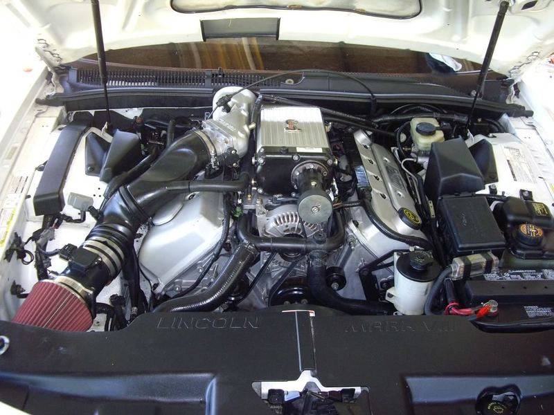

Yay it's finally alive and my first blower install ;-) kinda

Anywho, once again started bright and early. Got the blower off fairly easy and saw my two holes. Put the bolts in with a dab of gasket maker just to be sure. Got her all back together and she fired right up! Smooth as silk and sounding good.
Trans is still low and some how I grabbed Type F trans fluid so I asked granny to get me 5 quarts while she was out and about. I shut it down to make some adjustments and hook up my gauge vac line then tried to restart and no go. :( I couuld tell right away there was no spark. :mad: After futzin around a bit I discovered the crank angle sensor is bad. Guess when the engine heats up it causes the sensors magnet to stick. I have another but not sure how I am gonna replace it. The front most bolt on the AC compressor is now completly blocked by the sway bar. Can only back it out 1/8" and that just aint enough. Oh well, I will figure it out somehow.
