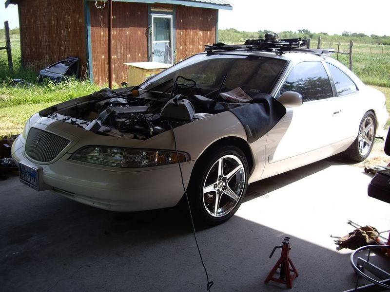

HOLY CHIT!! I cant believe the hoist didnt tilt with the car on it!!! I know they can do like 2 tons or whatever but that is nuts!
I had to save that picture to my computer lol
Actually the lift in front of the car kinda was a PITA, once the load was on the lift it rolled under the car more as it balanced itself, there for a few seconds it was at a tilt..
I wanted to work on it today but slept too late and its been too hot out. Every part of my body hurts. Plus I cant seem to drink enough water so I guess I was pretty dehydrated. Ill get it going this weekend though.
Actually the lift in front of the car kinda was a PITA, once the load was on the lift it rolled under the car more as it balanced itself, there for a few seconds it was at a tilt...I would much rather have had an overhead crane, but we made do with what we had...
So there's PROOF!!! 2 guys CAN change a motor, in a carport, with NO air-compressor..and this one will have a Blower installed..no more excuses fookers...
Get busy!!!
Oh yeah! I forgot about our biggest (well my biggest) follie of the day.
Fired up the compressor and it went to 100psi but wouldnt fill any more and started to get very hot. I shut it down and found a seal had cracked. Well in my infinate wisdom I put a wrench on this 1" cap bolt and tightened it. It was still leaking so I backed up not even a quarter turn to re-seat and the 100psi in the tank SHOT the cap off the tank. I am very lucky as my face was just in front of it. Also I am lucky the cap was facing out into the yard cause it would have really hurt Jeremy or my car.
We never did find the cap so all the work was done with hand tools. Ever try removing a crank pulley bolt without one? How about k-member bolts with no impact? Yeah, we had our work cut out for us.
