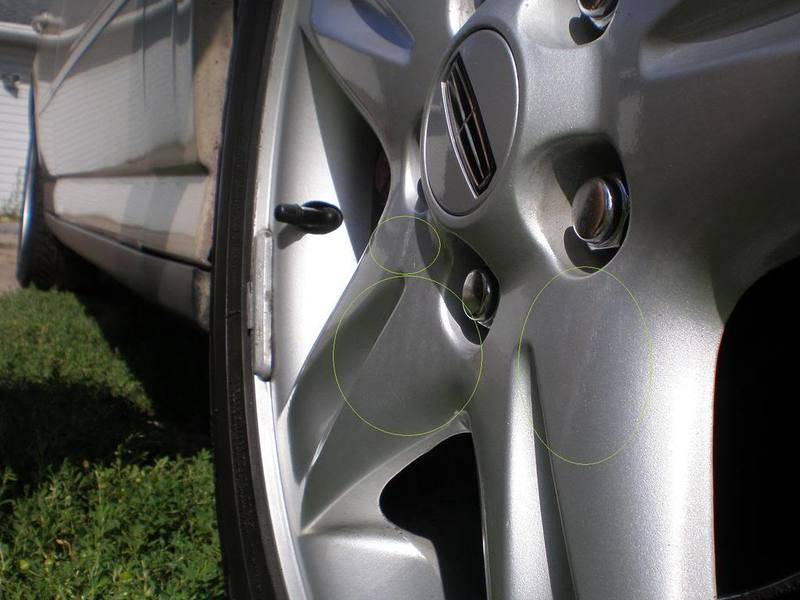

Well it's not your normal streaking. It's like someone used a cleaner that was not meant for painted wheels, sprayed it on, and where it ran down the wheel, it chemically damaged the finish. I even tried ssr3 with a mf applicator pad, and while getting it toned down, it did not completely remove it. I'm getting a set of these same wheels in chrome in the next couple weeks, and these will be retired to the garage until the winter.

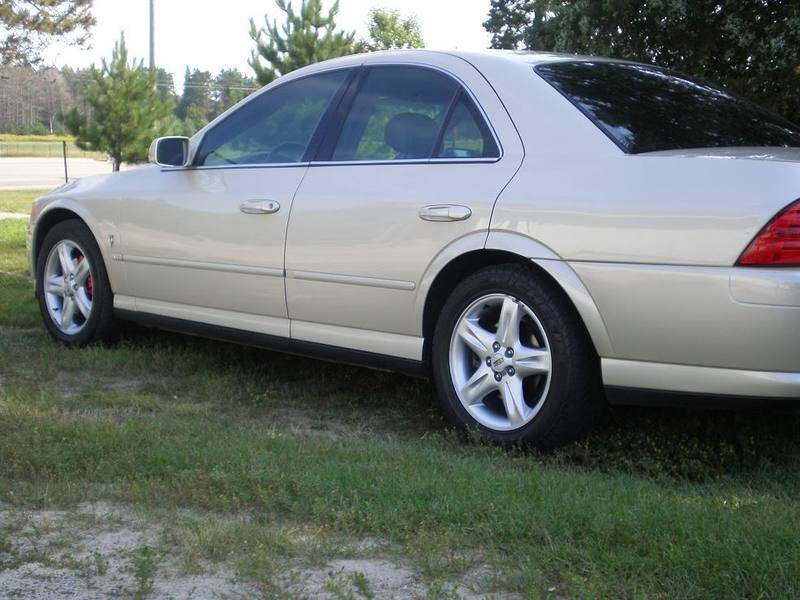

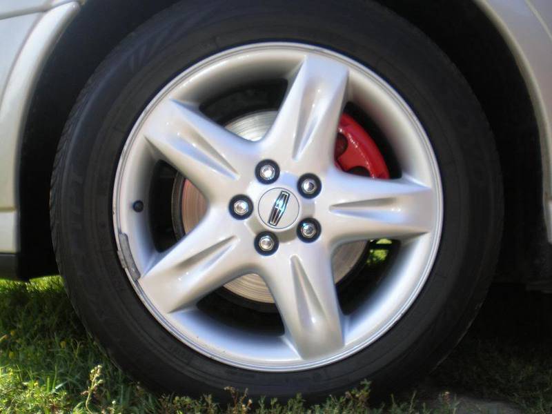

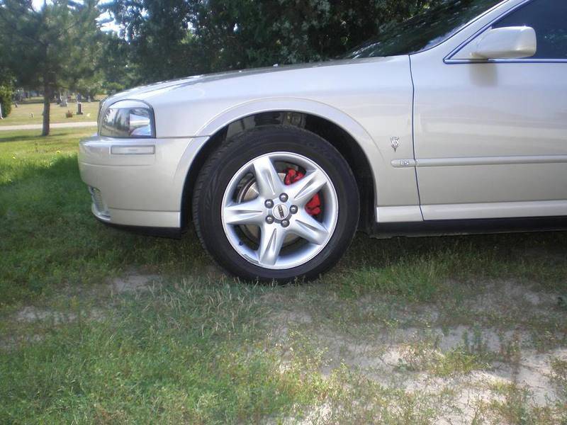

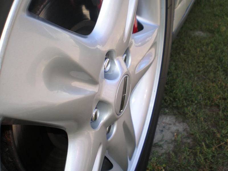

Okay, Kyle. Here's a few pics. There are many defects on the wheels that can onlyl be remedied by refinishing, but apart from those they turned out pretty good! The pic with the green circles is the areas I couldn't completely remove the streaking:
have any recommendations for the wheel weights? I HATE the ones on my wheels because they are severely chipped. I'm wondering if I should clean them up the best I can, then paint them...
Oh, and notice the new lug nuts on the first pic. I have them on just the front wheels now. The backs will be changed out when I do the caliper paint. They look SO much better than the stock ones. A few of mine were stripped when I changed them, but I used a breaker bar with impact sockets. For the ones that were stripped, I used the next size smaller (IIRC 19mm) socket, and hammered it onto the stripped lug. Didn't take long, but make sure you don't miss! :D
