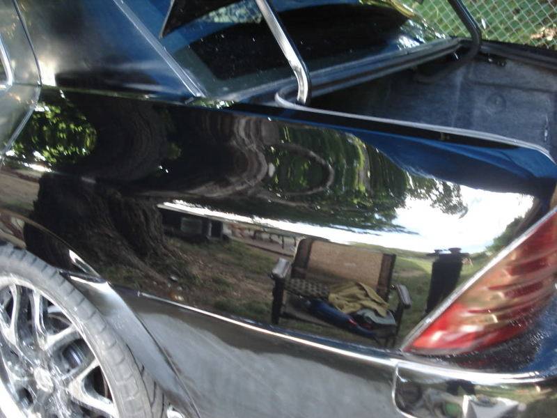

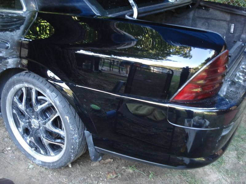

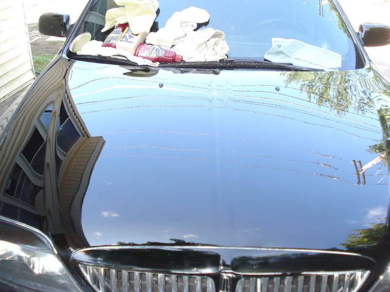

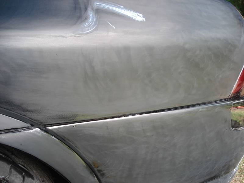

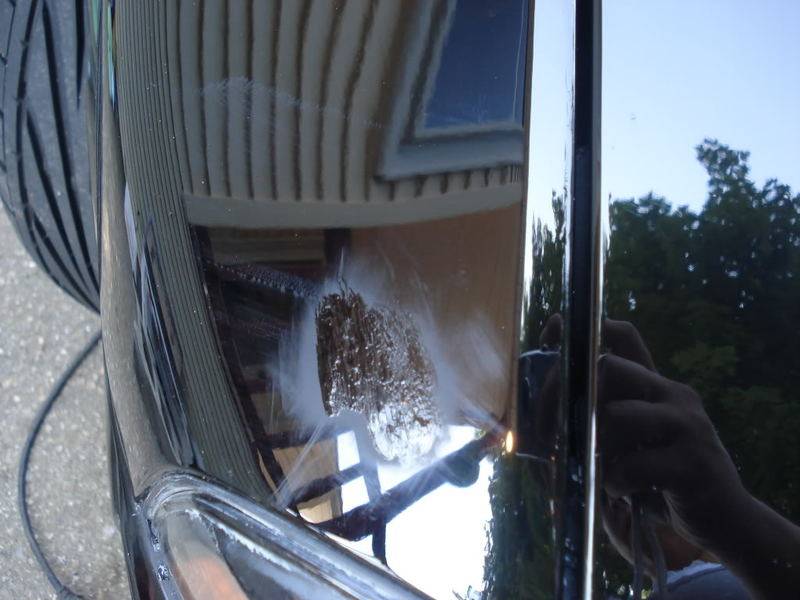

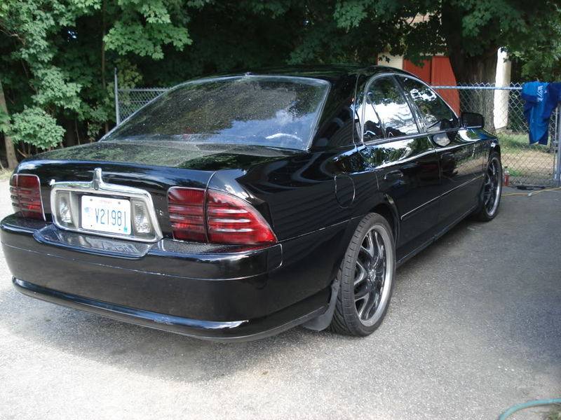

I forgot about this thread.... here are some pics while mine was getting her week or two of love
had to build up the paint a bit
all done
That wetsand turnout looks great. As far as glaze, I like EZ Creme Glaze and a lot of people like Danase Wet Glaze. EZ has micro micro micro abrasives to bring out a little better shine.
