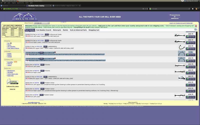

Got my UCA's today. looks like i got a better deal then i thought i did. I thought i was getting just plain old moog uppers however it turns out i got the problem solvers which makes the deal even better. Rockauto sells these for 61 dollars each i believe. I scored both with shipping for 75.
You are not exactly right but I just got these. Stamped the same. You got a better deal though. Where did you get them again?
MOOG Part # K8598 Problem Solver
Front Right Upper; Incl. powdered-metal gusher bearing to allow grease to penetrate bearing surfaces; Incl. bushing
$46.79
MOOG Part # K8596 Problem Solver
Front Left Upper; Incl. powdered-metal gusher bearing to allow grease to penetrate bearing surfaces; Incl. bushing
$47.79
Silly me. I was comparing them to the price of the normal Mark VIII UCA. I got them from ebay. glad to see either way i still got a deal tho.
so u got both UCA's for 75..shipped? where's that link???
Sorry I lied. it was 78.58 shipped. I don't think he had anymore. If you want the sellers name ill be more then happy to get it for ya.
