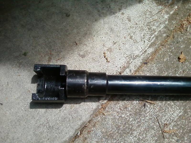

For the tie rods just knock the outer tie rod ends out of the spindle and then loosen the lock nut and remove the outer tie rods from the inners. After that cut the band clamp off the inner boot and slide the boot off. Locate the locking pin and screw a drill bit into it (by hand) and pull out the pin then use your wrench and unscrew the inner tie rod.

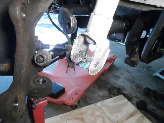

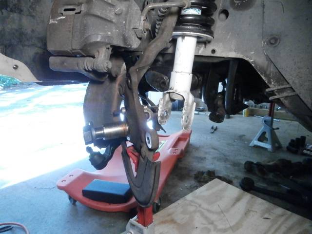

yea we aready took out one of the tie rods. there was no pin in it. everything looks factory on this car which does not surprise me at all. we are still working on the drier side. getting the 30mm bolt out... just went and got a giant breaker bar.. as for the spindle arm. yes. somewhere i have pictures where i grinded it. i want to replace it new but im not in a hurry. i can always do it later i guess..
correction. i just went out and monkey fkd the bolt with 400 lbs of ass and it cracked loose. back to work. sadly its to hot and im to much wanting to get this over to take pictures. so ill probably just snap one of the parts that have been removed so ya can see how bad they are

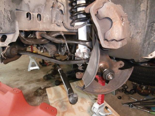

here's some pics of mine as it sits, maybe it'll help?
btw, I'm not r/r forward SRB's but i do have new sleeves for them; free if somebody needs em
UCA and inner and outer tie rod ends already replaced
looking at it now after sitting for a month, I'm like, "what goes where again?" lol
yea we are all good. the only bitch we are having is the bushing in the top picture on the far left looks like some string hanging by it.. those.. i got new ones and i thought the sleeves were two peice but i guess they get destroyed removing them and you need ot make new ones or something
