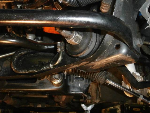

this part. the one thats grinded.. what is the actual name for it.
That's the spindle. You shouldn't need to replace it if that's just some surface grinding
You are very possibly correct. however I would still like to find a new one if possible. maybe one thats in better cosmetic shape as well. some of the grinding is just ugly. and would need to be treated as it has already started to show signs of rust.
I thought spindle was a generic name for it. I take it you cant buy these at vatozone. probably a dealer part or a junk yard part ?
Its the spindle. Dealer no longer sells them. Cant get them at any autoparts store. JY you can get them from any mark or T-bird or Cougar, they are all the same.
A little surface grinding is ok. Just pull it off, knock off the surface rust and dirt then spray with Rustoleum undercar black spraypaint and they will look better than new. sapper just did his in matching silver with his brake caliper mounts. looks good but when the car is on the ground you will never see it again.
