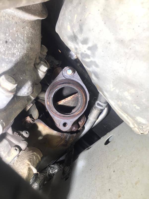

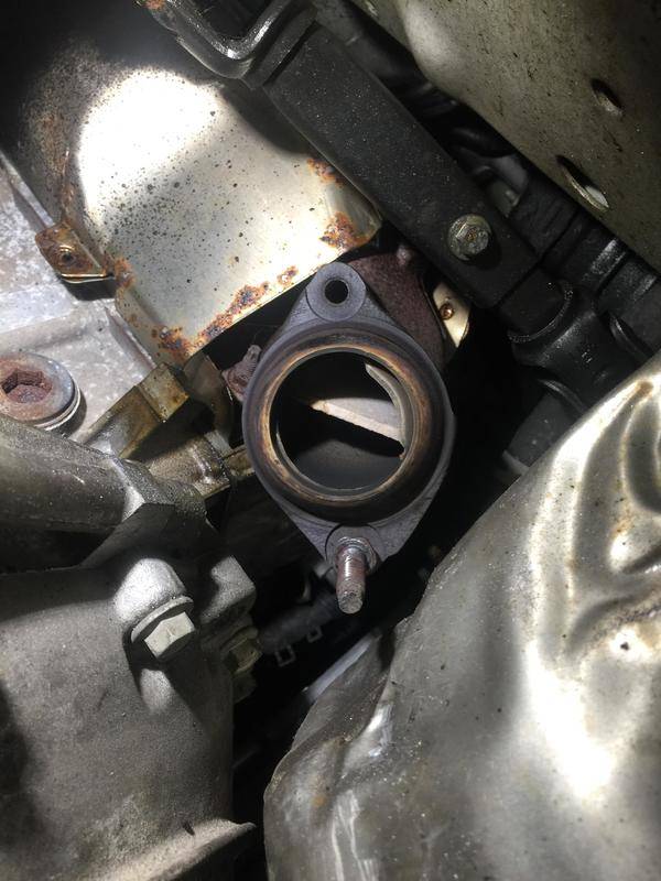

Anyways, I made good progress today, found an opening to get a long saw blade in and cut the cat off right after the flange, then was able to hit the bolt with my torch and get it off. The bolt came off the stud so I have to get that off, but so far so good.

Anyways, heres the drivers side (You can see the stud bent, i'm assuming that was when I was trying to pry the damn cat away to get the bolt before I cut it off)
Heres the pass. side:
Kind of bad angles, but it seems like I *should* just be able to hit them with the torch and unscrew them. (HOPEFULLY!)
