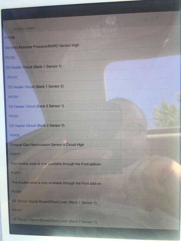

word of warning, if you go with non OEM cats, there is an extremely high chance of the CEL coming/straying on. there have been a lot of guys that tried different brands and very few worked (well enough for the light to stay off)
That's a bummer, but oh well. I'm not paying the insane price for OEM cats. Thanks for the heads up though. Any idea why?/what code it throws?
The downstream O2 sensors only do one thing and that's tattle on you when your catalytic converters are no longer scrubbing the legal minimum of pollutants from the exhaust gases. I imagine they are calibrated to such a degree that only the strictest catalytic converters scrub enough out to keep them happy.
Of course the solution there would be to buy dummy downstream O2 sensors and calibrate them until the CEL goes off. If you have to pass emissions however that probably won't work.

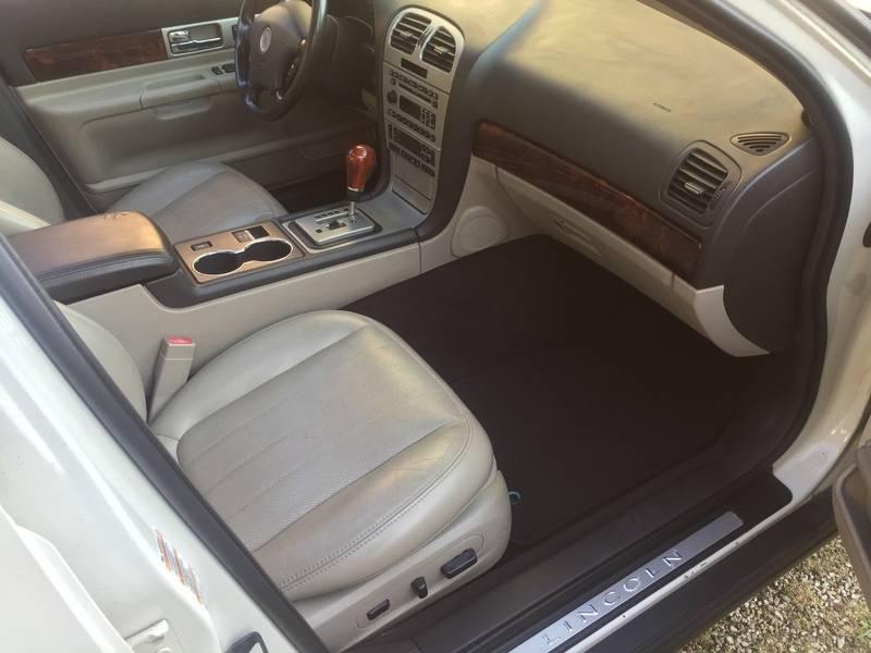

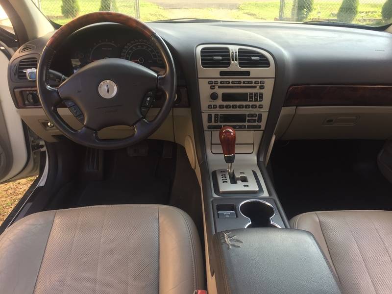

I spent the last hour or so out cleaning the interior. Was gonna start tackling the VCG but just lost interest in wrenching today, lol.
She cleans up really nice. Gonna shampoo the front carpet today or tomorrow still but just a decent detail did it wonders.
Drove her around the block too, the looks when people hear an ungodly loud vehicle coming and then see this nice, clean Lincoln LS is hilarious.

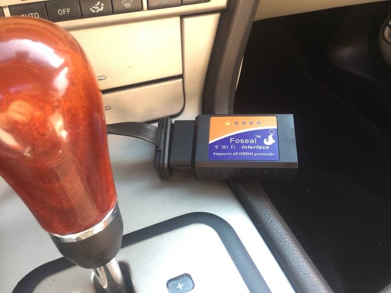

Plugged in my OBD2 adapter for my iPad and pulled the codes. I had to buy the $9 2003 Ford pack of course, but oh well.
Seems like most/all of those codes are related to the cats being off. (And no O2's currently) This was the pic before I bought the pack. I think one or two of those "??" codes were from when I set the alarm off and it disabled the ignition or whatever when the battery was really low.
