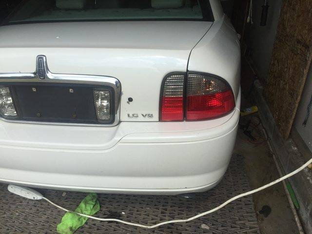

These taillights are one of my favorites on any car of the LS era. They look so damn good.
Flap flap flap flap

And nothing like going outside for a mere 7 minutes to swap out a taillight and coming in completely drenched in sweat. Gotta love these 100 degree, almost 100% humidity days. NOT.
The corrosion on the trunk lid irritates me. A lot.

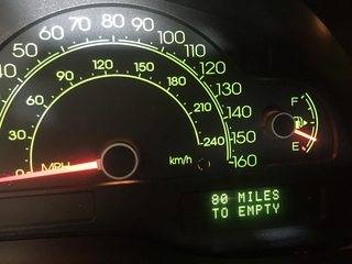

I was sick of seeing "LOW FUEL LEVEL" and "LOW WASHER FLUID" every time I started it, so I grabbed my only gas can I use for my mower, emptied the 87 into my Explorer, then ran up to the gas station and got about 3 gallons of Premium, and a jug of washer fluid. All is well now. Fresh fuel in it, plenty of washer fluid, no more warning messages.

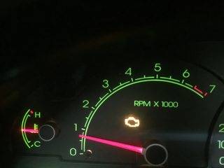

Psssssssssttttttt.... Your check engine light is on...
I REALLY miss the a/c seats in my BMW!!!!
I've owned so few vehicles that actually had owners manuals I forget they exist sometimes.
And no that's not a check engine light it's just telling me the engine is in fact still there!

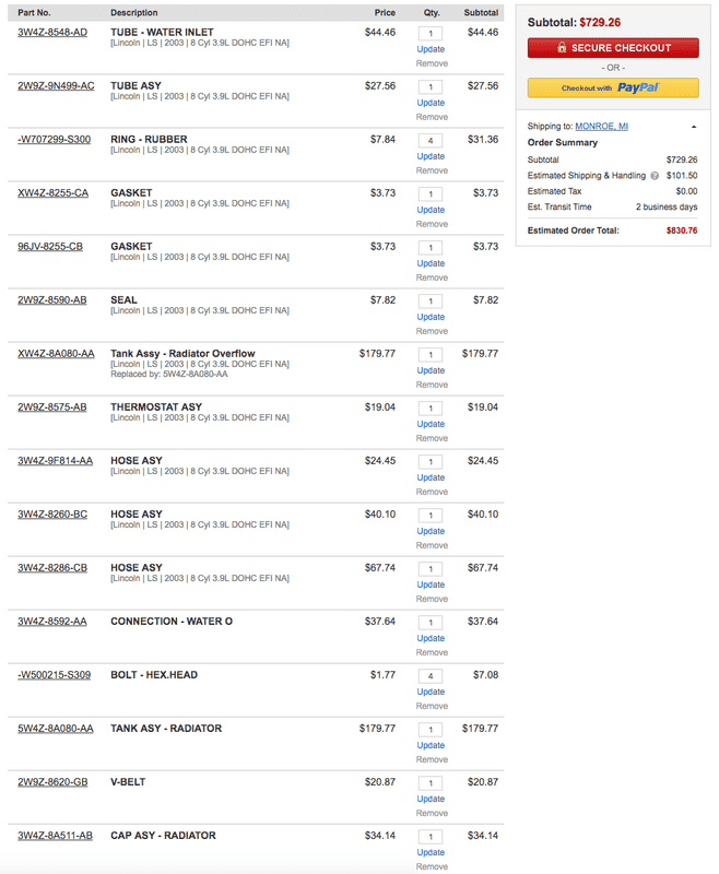

Finally made a shopping cart for the cooling system from FPG.com. Over $800.
Please tell me I have things I don't need in here...

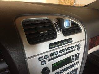

Question for the tech guys. I got my wire harness, and radio kit today.
The Metra harness has 3 plugs. The main power/audio plug, then the plug to retain the factory deck subs, and then a plug that has only a blue and brown wire coming out. From some searching, ive found that the blue is for the antenna (its a powered antenna I assume, and needs a trigger wire like an amp, right?) but the other is "cell mute." What the hell does that do? Will that mute the aftermarket radio when I hit the "Mute" button on the steering wheel, or was that for the Lincoln Service or whatever the gen 1's had?
It's a powered antenna, but no signal/power from the radio is needed for it. There's no connection for it at the radio harness connectors. The mute button and all the other steering wheel buttons come in on one wire (okay, there is a ground return too) in the big connector.
Note that you will lose the RAP (radio will now turn off when the key is turned off, instead of when the door opens). You can get it back by running a wire to where the signal does exist.
Just got back inside from using my DMM to see if RAP would still work and found out it won't.
Bummer, but like you said I'll just tap in somewhere that has it. Anywhere in the stock harnesses right there? In my Explorer, I had to tap into the fuse that kept power to the windows. Wasn't bad but it'd be nice to have something right there in the harness.
