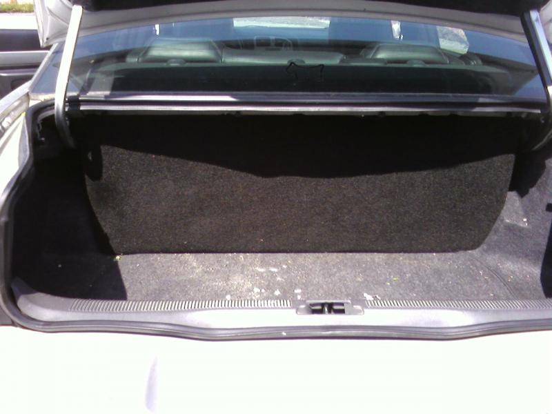

My new custom enclosure.

So I started creating a faceplate for my enclosure this past weekend. I am going to create a template (hopefully pdf) for those who are interested in making one. I still need to cut out the holes and glue the carpet in place, but it seems to fit nicely.

Is it possible? Yes. But you will lose precious volume when you add port (those boxes only allow what, 1 cube gross per sub?) And you have to add the proper length to tune it right.
Yeah they are .94 cub ft. My sub specs ask for .57 to 1 fr sealed and .75 to 2 for ported. I have about a 1.5 ported. I'm sure my subs won't sound as well in this enclosure but I need the space.
Just looked at the ebay ad. Each sub has it's own chamber. That I think would be pretty tough to even find a place to port. I would just build my own box. The enclosure is VERY important to how your sub will sound.
air space is crucial to how a sub will preform. i dont think these boxes would port very well (two subs of course) if you really need the space, go with a sealed boxes. or just get one good sub and build a ported box for it.

Ok so this thread has inspired me quite a bit. I grabbed some mdf and made the front of the box, similar to what is posted here. next I made the box (12"h X 12' d X 32" w) to attach behind it (sealed). I plan on putting two 10's in there and taking the 6x9's out to allow the air to move freely into the car. the question I have is will I get better results having the subs facing the taillights like many have posted so far, or facing upward toward the 6x9 openings? In theory it, having the subs facing upward makes sense, but I was curious because everyone has them facing out.

And you are down to not very much volume. Can't remember the specs off hand, but I don't remember them having the construction/volume requirements to fit any type of big boy sub.

I'd check mounting depth as well. I don't remember those prefab boxes being very deep enclosures. You should also check your woofer specs to make sure that the recommended volume is reached. Most 12's I've seen have a recommended 1 ft^3 sealed per driver after displacement.
Some quick info on the ebay box. I had sad previously it was 1.6-1.7 but after a closer more accurte measurement it is 1.57. I have measured in many diff ways and that's the most I could calculate out of it. The initial 1.6 to 1.7 came fcrom the company itself. It is a good loking box and would work great for a single 12, but after displacement would give you about 1.4.. cuft.
If your trying to run sealed this is more than required for most 12 in subs. If your going ported, most of the higher wattage 12's require 1.5 after displacment. To me that actually seams small, big boy subs will be better off closer to 2 cuft. Note that some of the measurements given for the space the sub reqires are usually minimum required not optimal.
If your not looking at running too much wattage then this box will work well but remmember that the box is made out of 3\4 mdf except for the back and front which is made out of 1\2. If you plan on putting a 60+ pound sub on 1\2 mdf, I would try to reinforce in some way. This would be a great for many subs though.
Depth at bottom is 12.5" and 6.5" on top
I measured from center of sub opening to back of box and its about 9 1\2"
