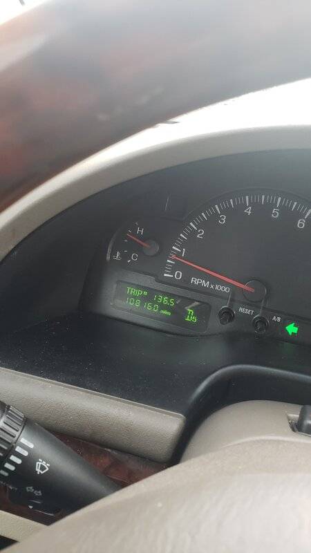

Well boys, after throwing away over $5000 that I dont have, she did it!
Left me stranded with my kid brother in the car....and that's something I can't forgive.
If it was me, fine. I'd call AAA and wait until 12 am like they want me to. But not with my kid brother in the car.
Engine got too warm huh?
Hopefully you shut the key off when you were alerted by the message center on the other side of the dash.
Did the engine lock up? Will it still turn over? How is the engine coolant level in the degas (overflow) bottle?
The shady Fla dealer probably rolled back the odometer. I realize age is a factor on parts wear... but No Way should a car with that milage have this many problems all at once... unless it was severely neglected.
$5k ?!?! Is the extra $1500 just for the steering rack work?
Between fees and repairs, it totals 5k.
And the odometer isnt rolled back, I checked the CarFax and it reports 100k miles before I bought it, which lines up with the 108k it had.
CarFax isn't always accurate. Especially if the vehicle crosses State lines (or Country Borders).
It's been a number of years since I used this... but it's accurate. Last I knew it was like $6.50 (a decade ago).
Probably more now.
she still fires up. I shut her down as soon as I noticed it, it never went into limp mode. Had to start her back up to move to an intersection and a dumb attempt to drive it home that resulted in me moving a couple feet down the road before I noticed the needle slowly going up, and to get her into the driveway
Then it is most likely age of parts... and you bought a ticking time bomb.
Does the engine still turn over when you hit the key?
