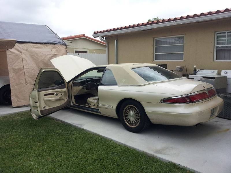

We're still searching high/low for a donor car. We want the whole car, not just some random motor with god knows how much mileage or abuse. We want a motor that we can start & listen to.

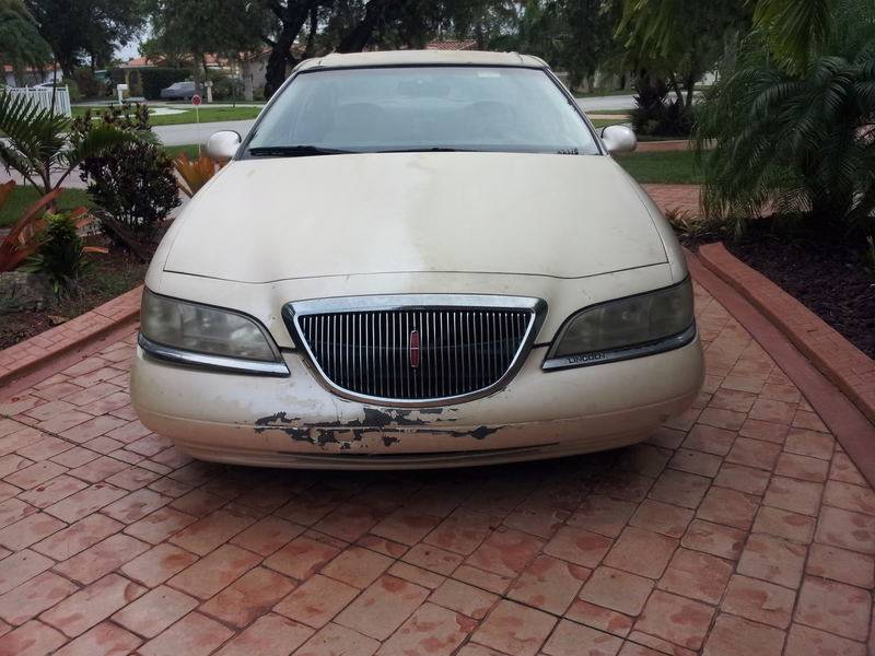

UPDATE: She's home! Donor car found.

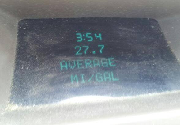

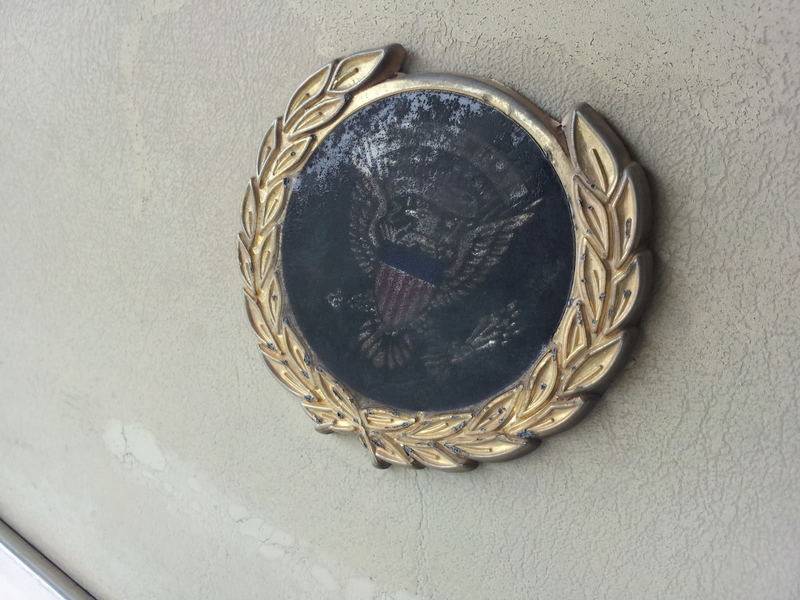

She's a "Presidential Edition" Mark VIII with original 115k on the clock. I know it's original because I drove her from the place we bought it to my stepfather's house (91 miles) at 75-90 mph all the way & she ran like a true champion. It was the last run in her life & she let me know she is good for another 100k. She ran just as smooth as my prairie tan '97. I was shocked. Aesthetically, She's seen way better days in her life. Many of her parts will live on in our Marks. DO NOT PM me at this time for parts. I will be parting her out but in July. The drive train needs to be pulled out from her then she will be cleaned thoroughly before we part her out. :)

Yes..... Its actually more than ugly... But hence the name donor... The presidential editon mark 8 engine will go in the barn find mustang....
By the way, very important. I forgot to mention that this car was made possible by Mr. "98cobraLSC" aka Robert. Thanks for finding this gem. Robert, the car isn't as bad as you think. It's just DIRTY!!! I plan on cleaning the hel outta the car so you see how it was actually in great shape before we part it out. I need to literally get a bucket with water & heavy duty soap so I can clean the interior but it's just stains from years of not cleaning the car.
