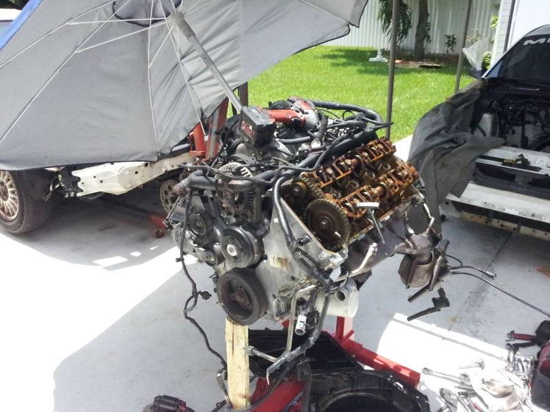

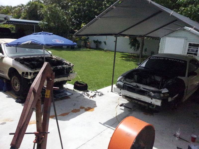

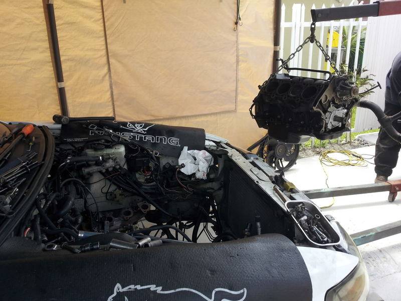

Well guys so far this is going way faster than I expected. This is where we're at as of last weekend:
Just pulled out both motors this week after these pictures were taken. Gotta take pictures of the pulled out Mk8 motor. Don't have pics of that yet.
Next step, chroming the valve covers & powder coating the intake black. Not planning on switching to the Cobra intake until much later.

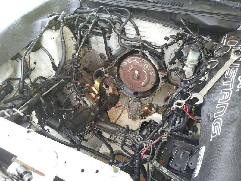

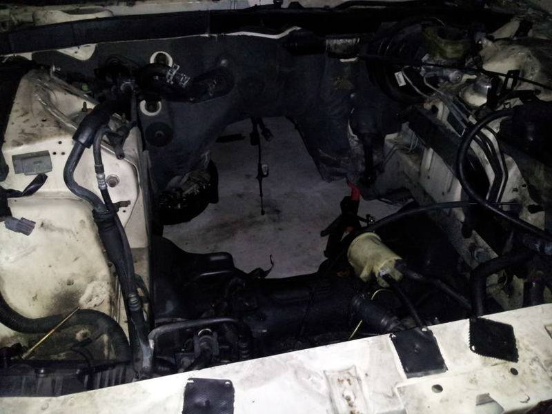

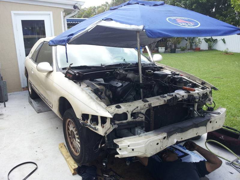

We hired an "at home" mechanic. Guy comes over with his tools (NO AIR TOOLS) & with my help & my stepfather, in 3.5 hours the motor was out, tranny was out, drive shaft out, gas tank was out & exhaust was out. I went over there tonight. Took a picture of the engine bay on the Lincoln for you guys to enjoy. Can't believe this was a perfectly driving car & now it sits heartless. :( One less Mark on the road.

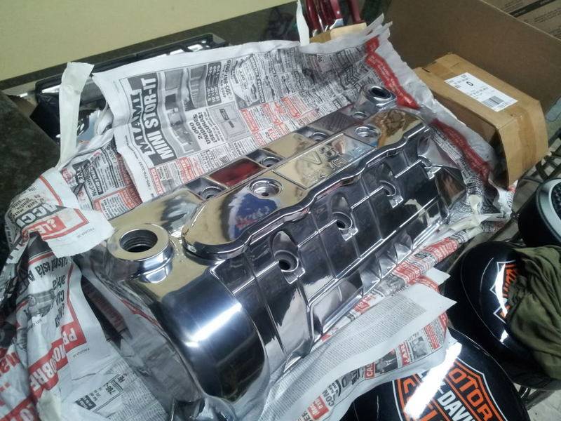

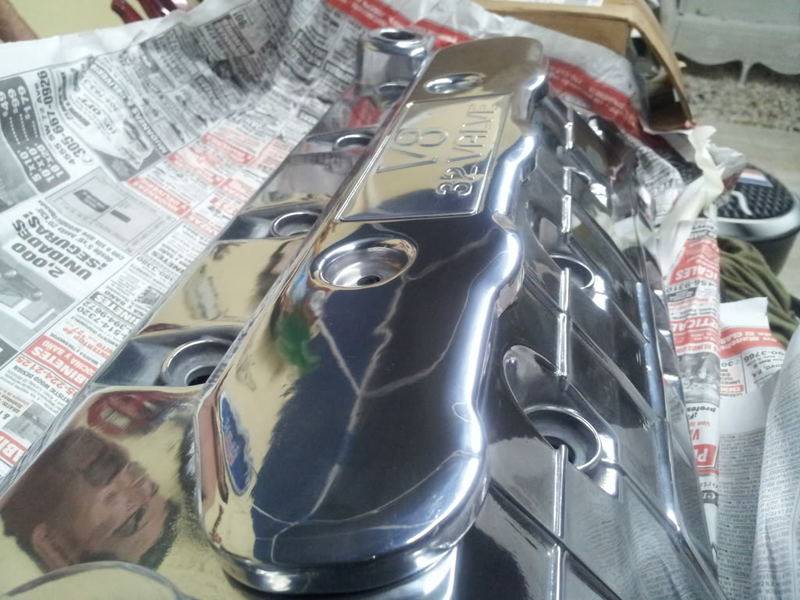

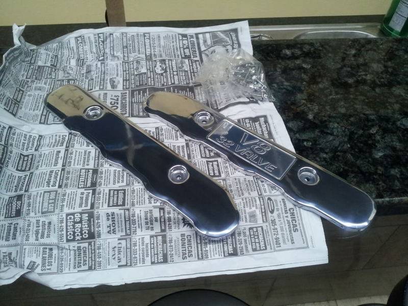

Hey guys, this is where were at now. Things are lookin good. I get the feeling that by this time next weekend the Mustang will be running but I don't want to get ahead of myself. It's been an interesting road. Not the easiest for sure. Finding OEM Cobra headers proved itself to be one of the hardest things of the build. Ppl upgrade to racing headers & just toss OEM's. We finally got a set yesterday after I posted a WTB ad on Craigslist. Headers went on this morning & so did this valve covers. Engine was supposed to go in today but we noticed we bought the wrong torque converter so it will have to wait another couple days.
Anyway, enjoy the pics. PS: The polished valve covers? I'm SOOOOOO doing this to my blue Mark very, very soon.
You said polished valve covers I wasn't so sure, but after seeing them, incredible! love it!
Same thing I was thinking when I saw polished, they look like they have been dipped or like they are actually aluminum that's been polished up. I'm jealous and want some!
