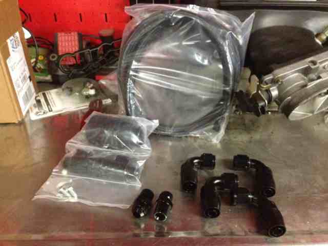

Look what I got today!!! Finally!
I am off Friday so the build shall begin...

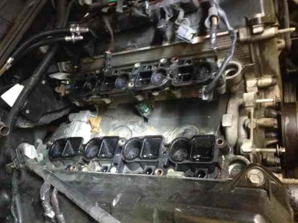

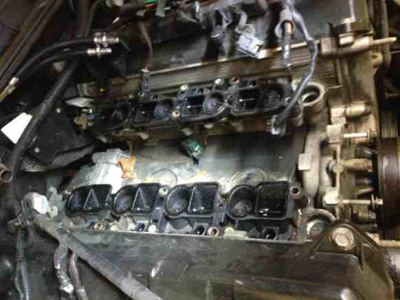

Intake, IMRC, motor and module off. Man were those things nasty! For the life of me I cannot understand why you would leave these **** collectors in....Well, the module is a real mother to get out so that may be a good reason.

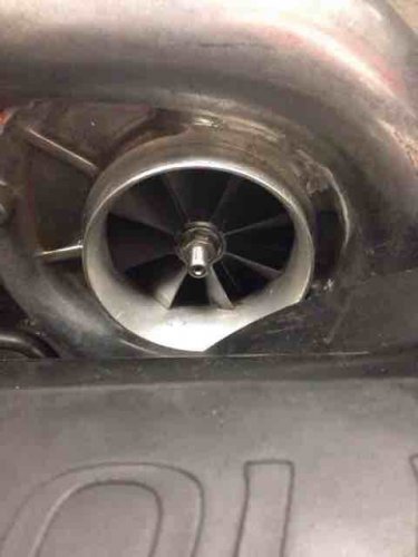

Is there supposed to be RTV between the two housings? I loosened the bolts to turn the housing and I see it has RTV. I thought i read that these are machined and no sealant or gasket...
The out/exit/impeller side I will call it and the main body. I have to turn it from the 6 o'clock to the 9 o'clock.
I started to clean off the rtv. Then read up a little and no one talked about rtv. A Paxton instruction document in particular mentioned it was clean with no "seal" or sealer.

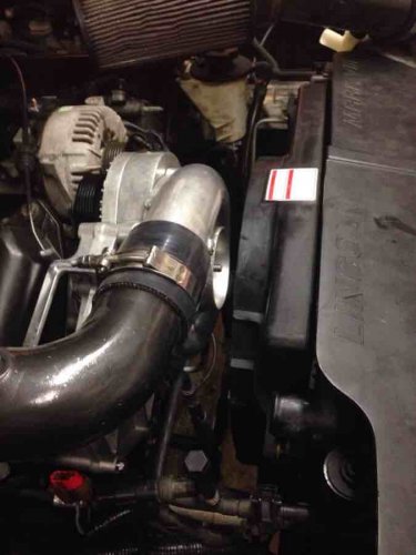

Got the fitting the oil pan and the air pump pulled from the left fender well.

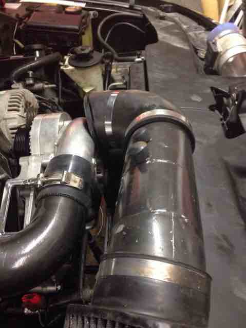

Mocked up the sc and bracket.

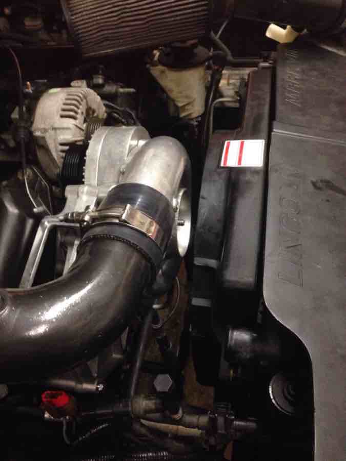

Slip the radiator fan up from underneath. Then we have a problem :(
Any ideas? All the reading I have done prior I didn't notice the problem.
All ears.
Maybe this shot helps a little.
You can modify the radiator mount and gain almost an inch.
You can trim the shroud and gain more room as well.
If that's not enough, you might be able to use a low profile carb hat.
These are all from memory of what I've seen in the past.
I think it is time for a beer....

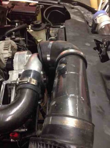

I pulled the upper mounts for the radiator and gained a 1/2" or so. It then hot the head of the bolt for the condenser, I pulled that bolt and gained about 3/16".
I have another elbow that is significantly smaller than the ass sucker I have in the pic.
At this point I have enough for the elbow but it will rub on the radiator fins.
