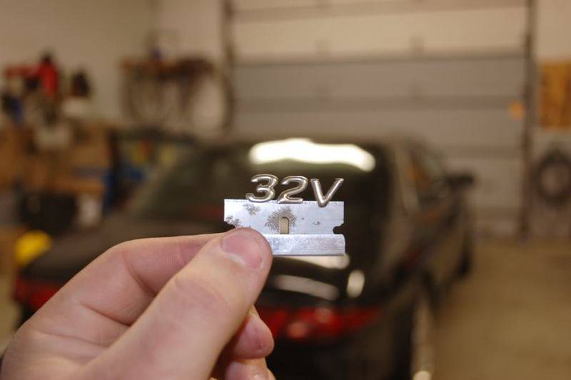

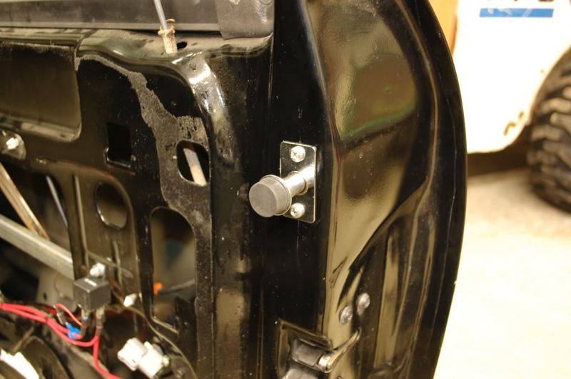

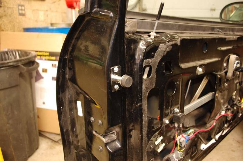

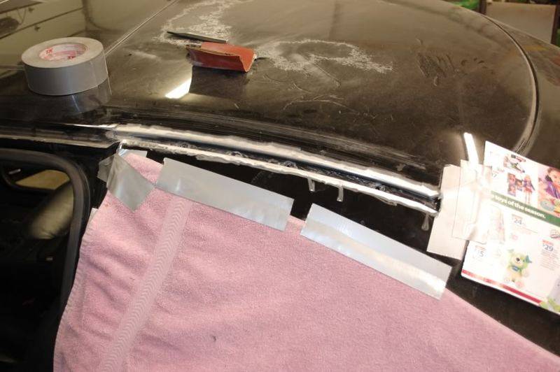

Finishing up the shave... installed the poppers.

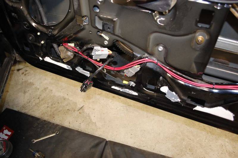

Had to reground the passenger door, was shooting sparks out of the hinges :D

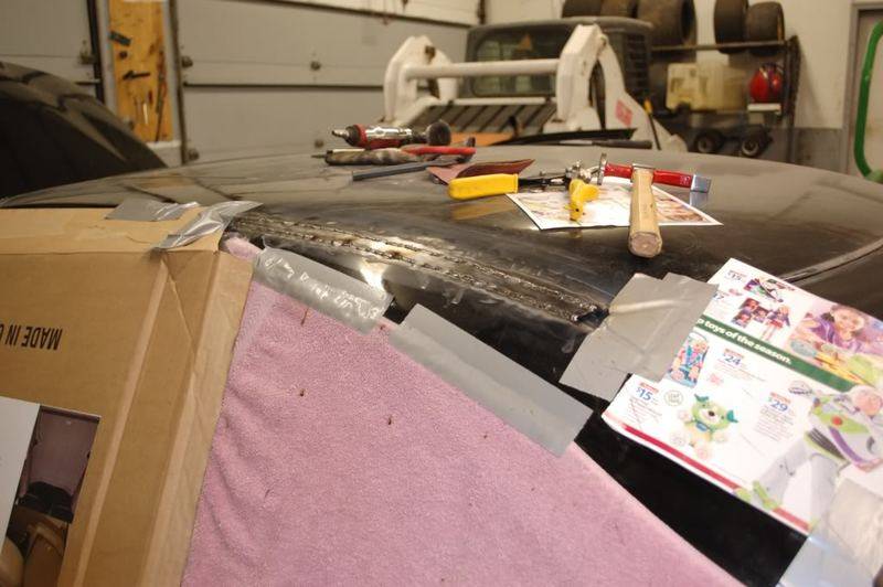

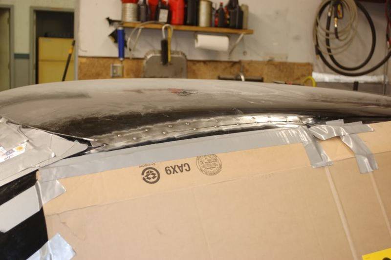

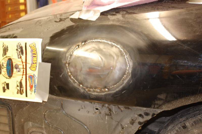

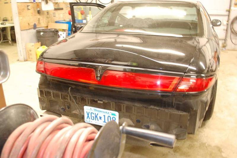

Cleaned up the tail...

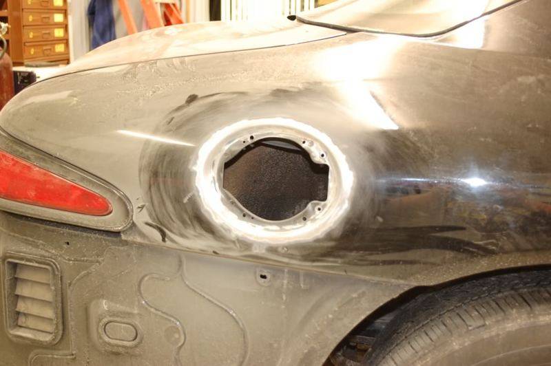

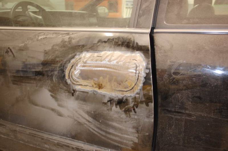

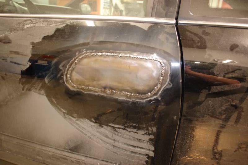

Grind off the paint..

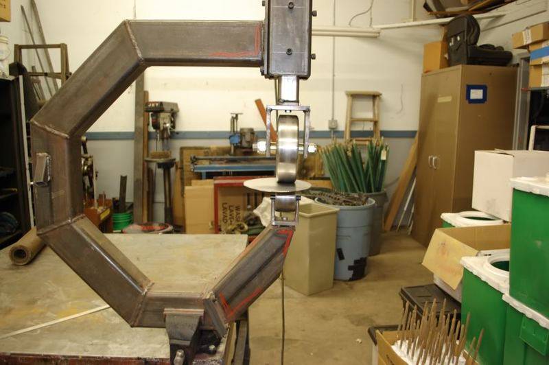

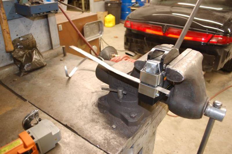

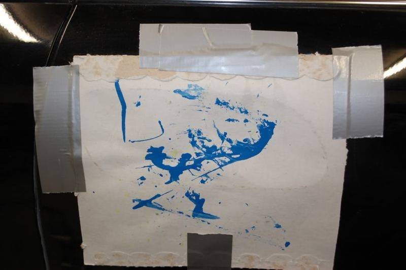

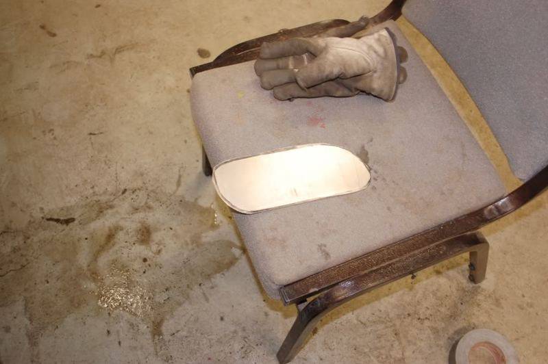

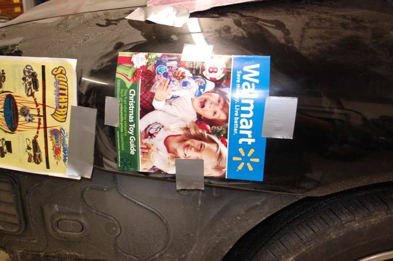

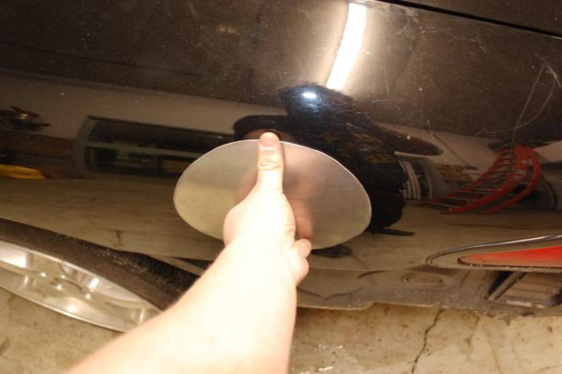

Make a pattern...

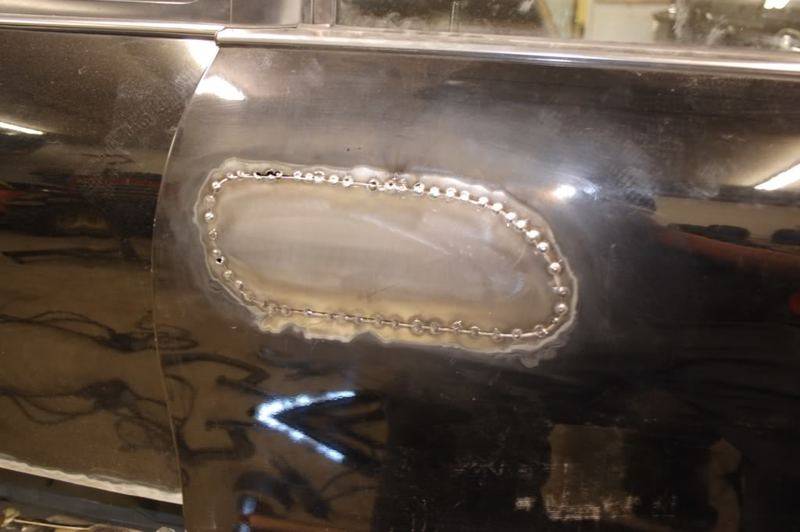

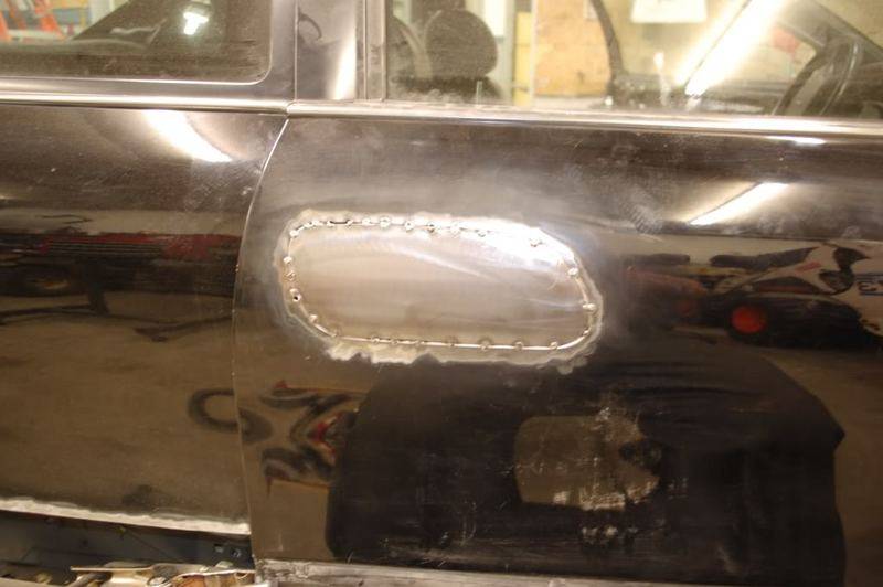

Cut it out of metal...

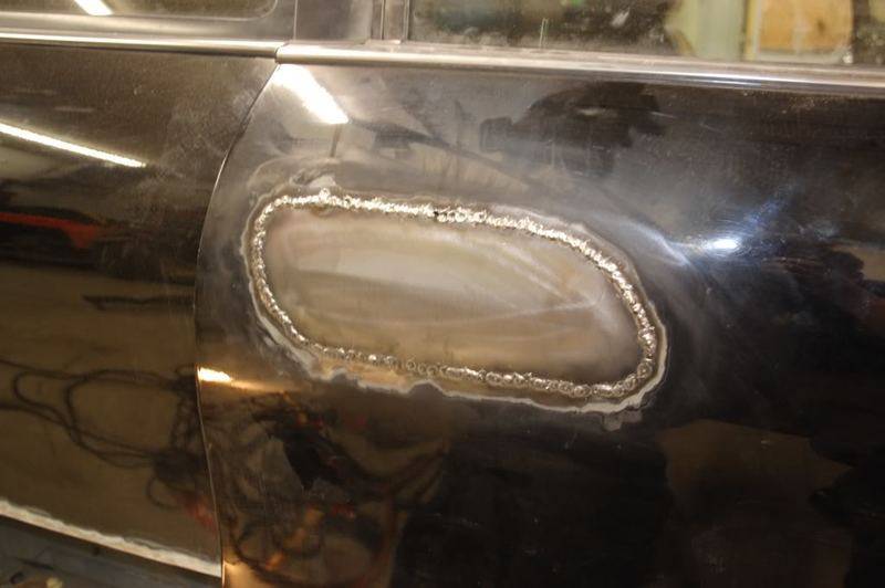

Weld it in!

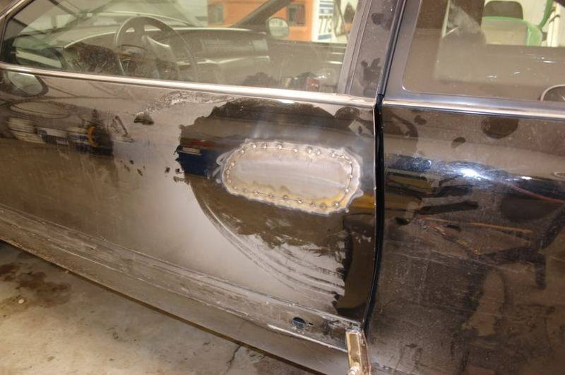

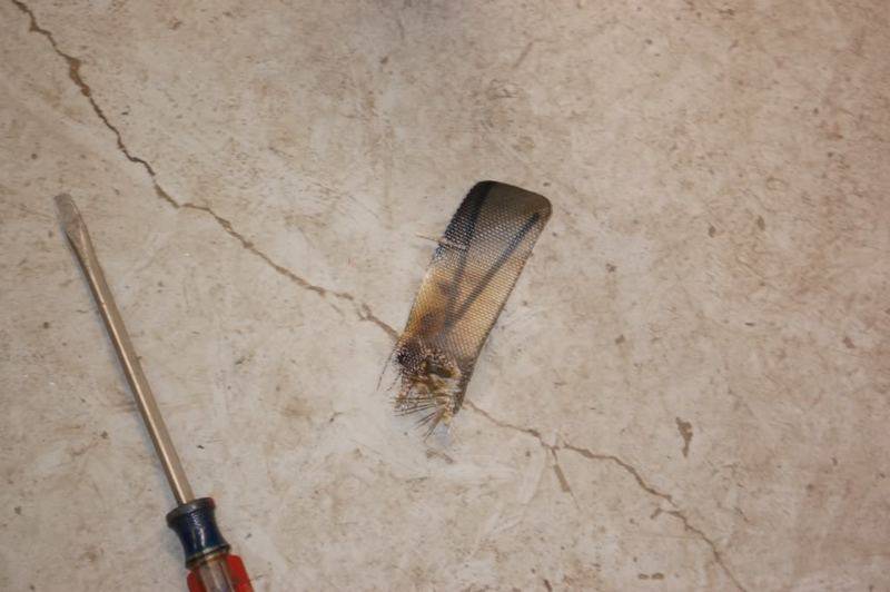

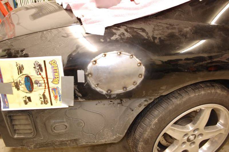

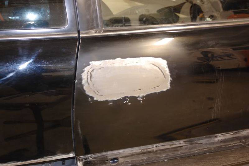

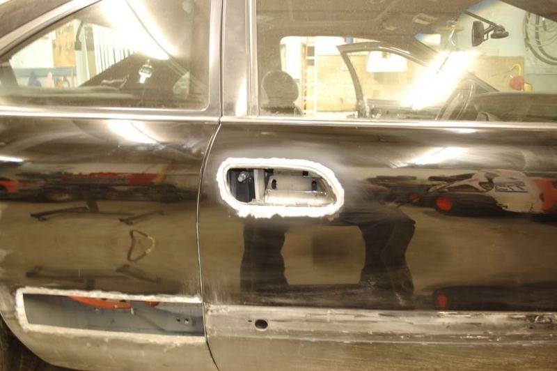

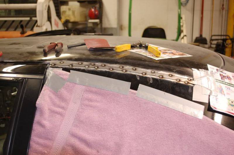

I was getting these weird contamination in my weld... so I looked on the other side and there was this bs sound deadener that was melting and ruining my welds so I pulled it out on the drivers side.

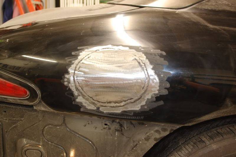

Fuel filler... ran into the same bs as the door handle with some tar based stuff contaminating my welds, unfortunately you can't get to the back of the filler so you can't do much about it...

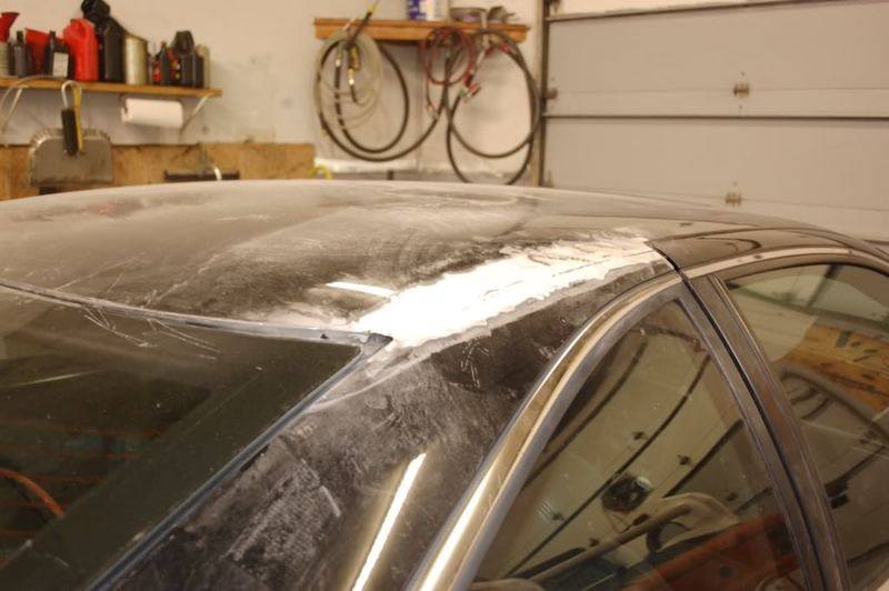

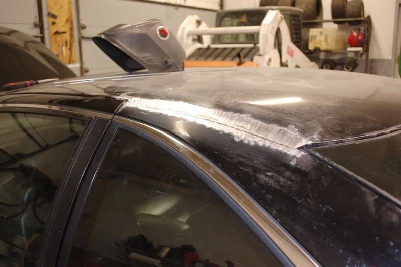

This next mod is something I've always wondered why the hell Lincoln didn't do at the factory... I HATE that stupid ill fitting trim...

You're confusing the solenoids with the poppers! The solenoids are nothing more than a giant electromagnet that when power is applied, pulls a plunger. Hook the plunger to the door latch and it opens the door. The popper is just an adjustable spring that pushes the door open once the latch is pulled.
Putting the solenoids in the car instead of in the door, keeps them out of the weather but also makes them easier to wire. You need to run a second wire from the inside of the car to inside the door for a good quality ground. If not it pulls the ground thru the painted hinges, sometimes it works, sometimes it doesn't.
Moving the solenoid into the car and using an extended pull cable helps extend the life of the solenoid because they're less likely to get wet and dirty and also keeps the installer from having to mess with snaking the extra wire thru the wire boot. Granted you still have to get the pull cable through there, but it's the equivalent of about a 8 guage wire. It is however, less flexible!

If they're in the door, they're going to get exposed to moisture and dirt! Notice the little drain holes on the underneath side of the door to let the water run out. Water gets in there and ruins those solenoids, I'm sure they're not fun to get to, I know mine aren't and I don't want to be replacing them alot.
