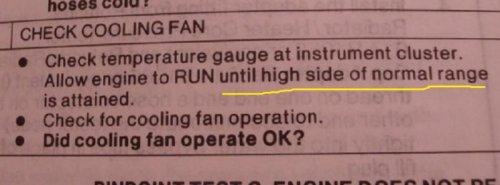

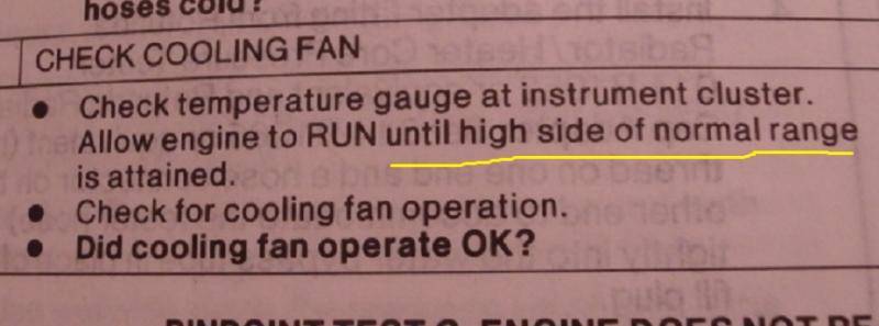

found this interesting tidbit in the fact servi man
