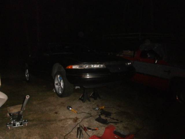

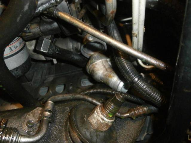

back to this task; after work today, jacked it up
removed the tstat (then ran of time)
I LOVE SPRING CLAMPS!
after work tomorrow I'll get some regular hose clamps and put it back together
there's just one o-ring to replace right?the orange felpro on the bottom of the tstat?
the one in there looked just like the new RT1085, so I dunno if putting a new oem tstat in will change anything
dumb question #519:
can I put my old and new tstats in a pot of hot water, bring it to a boil and compare when/if they open? i.e. maybe my old tstat is not the problem?
