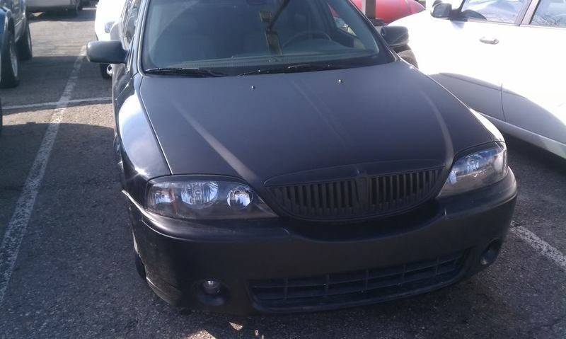

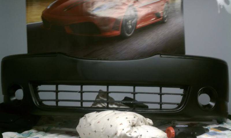

Both surrounds are done.. as well as front bumper which will need to be redone!

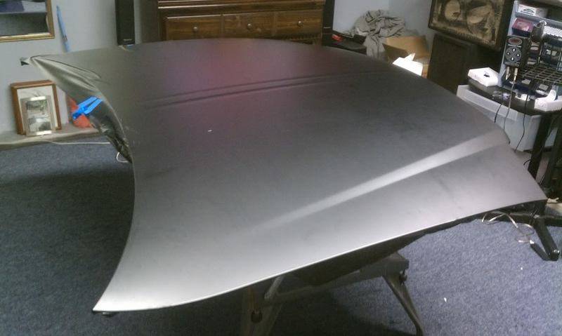

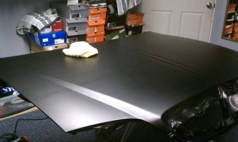

Attacked the hood in the garage and it was near impossible battling heat with the 25 degree weather, got about half way done and ripped the vinyl. Went to the gym blew off some steam. Ended up taking the hood off and wrapped it in my room..

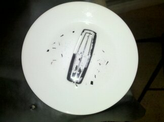

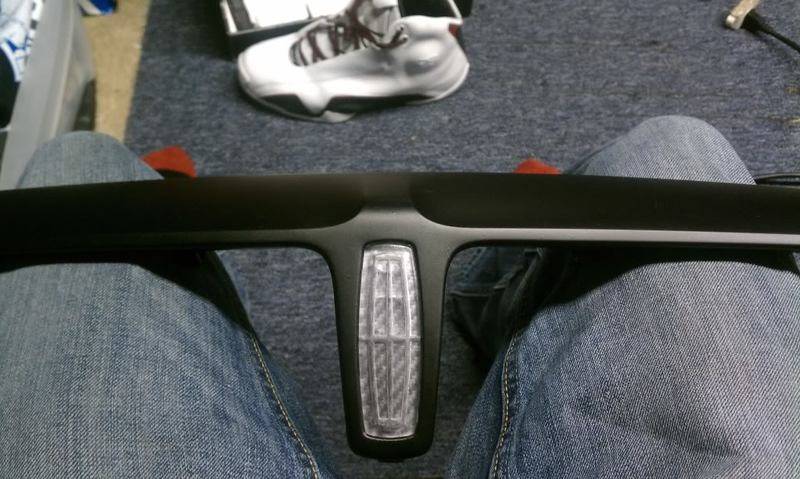

Just curious though, How did you do the emblems?

Anywho thanks for the comments! I'll keep posting, and updating. What works best for myself since I have been doing this all solo w no help is doing wet applications. It's way to hard to pull up a piece that is 4 feet, heat n stretch and smooth out.. so wet application allows me to lay it down and really squeegee the liquid out. It's kinda tough at the start but also helps me from not ripping or over stretching the vinyl. Guess its all personal preference!!

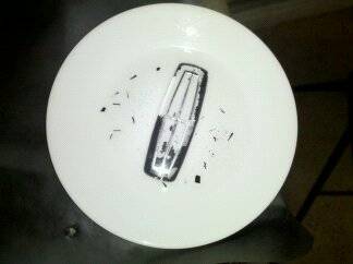

Soop, where did you get the clear Lincoln emblem?
It was a regular emblem I just took all the glue and paint off the back.. wasn't fun
quick tip for removing paint off the emblem. let it sit in acitone or nail polish remover for about 10 min and that will do all the work for you.
this is after about 5 min.
and soopa panels are looking great. keep it up. working on mine today im almost done.
Sweet tip for the emblems.. I have this paint remover stuff that is WAAAY to harsh I mean it till eat away at the plastic forget the paint haha..
