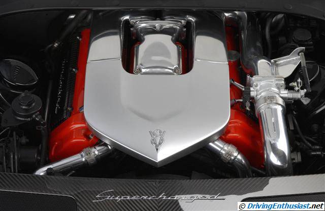

Ford's own concept supercharged T-Bird below. The supercharged engine was discussed w/the media for both the LS and T-Bird, then never delivered. Understanding is that Jac Nasser has(had) one for personal use. Roush also developed a T-56 conversion for the car.

I too wonder what all was done to the Thunderbird concept to get the 390 hp/ft.lbs of torque rating. It appears from the writing below that the headers were the only thing added to the engine. This leads me to believe that the stock 3.9L internals should be pretty strong!
FORD THUNDERBIRD SC CONCEPT:
With 390 horsepower on tap, the Ford Thunderbird 3.9-liter supercharged V-8 engine transforms the vehicle's character from a grand touring car into a performance-minded sports roadster. The supercharger setup offers peak horsepower at 6,000 rpm and 390 foot pounds of peak torque at 3,500 rpm, giving the Thunderbird concept car impressive power and acceleration capabilities.
Ford's powertrain engineers began the supercharged concept's transformation with a stock 3.9-liter DOHC modular V-8 engine from the standard Thunderbird. Then, all-new aluminum headers were fitted along with a Roots type supercharger to provide the necessary thrust.
"Achieving 390 horsepower from a relatively modest 3.9 liters is a testament to this engine's efficient use of technology," says Dave Szczupak, Ford Motor Company vice president, Powertrain Operations. "The raw power of this most powerful Thunderbird ever is intoxicating to sample, but our designers have made the Supercharged Ford Thunderbird just as exciting visually as it is to drive."
In the end, there was one built for show, and alledgedly one built for Nasser to drive. That's all we know for sure. The show engine didn't even necessarily run... and Nasser's engine didn't necessarily have to be built to the usual longevity standards.
Presumably, there was one mocked up or built much earlier, when it was discussed in the press for the Lincoln LS (just after it's launch in 2000). But sometime in the year 2000 the decision was made not to use the DEW98 platform as the platform for the new Mustang... and within 2 years the DEW98 platform itself was dead-ended for the North American audience. Note that there were at least two show LSs built with superchargers, but not with Ford parts or intended for production (1 of them is on my site, along with the S' T-Bird and several other things).
So it's all moot from them...
