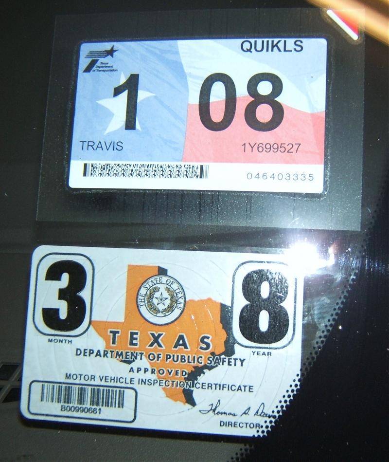

I went for my inspection 'emissions' test last saturday - failed.
- no codes - good thing
- out of the 12 sensors they test - I had three in 'not ready' status - EVAP, CATALYST, EGR SYS
so I failed because you are only allowed two in 'not ready'. Since I do not have an EGR - we blocked it at the PCM layer - so I will always fail that one - the other two are more complicated....
We do not know if I failed because of not enough drive cycles or if the tune is blocking it.... I don't think I messed with the EVAP or the Catalyst - so I should be able to pass this.....!!!!!
Torrie sent me a new tune this morning - thinks maybe he blocked more than the EGR - I uploaded it and will drive this week normally back and forth to work.... hopefully that meet the drive cycle requirements - then I'll test next weekend.
The place I found was awesome - car guys - clean shop - overlooked some 'things'....
After I pass emissions - then dyno - promise.
Catalyst Monitor on a Ford will not run until all other monitors are complete, so if your EGR monitor doesn't run, unless you change the conditions for catalyst, it won't run either...
The best way to make an EVAP run is to start it cold and let it idle for 15 minutes. Its looking for a >6hour cold soak, a startup with low fuel slosh.
If you havn't completed a full drive cycle, you should have had P1000, if you had no DTCs I'd say you have a glitch in your tune as a P1000 won't clear unless all monitors have run...

well - 'should' be soon...

TTTTTAAAAAA DDDDDDDDAAAAAA!!!!!!
all legal like. I passed with only two sensors in 'not ready' status - EGR and EVAP.
I do not have an EGR - so we block it on the PCM - and that way it fails. The EVAP is the last sensor to show a ready status - so I am told it will always fail if another sensor does
now on to performance tuning - and then dyno....
