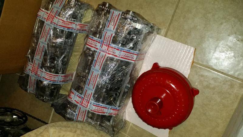

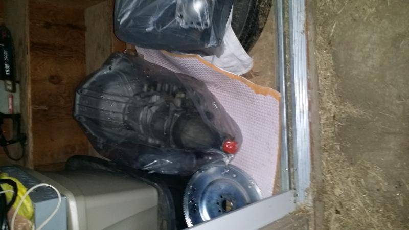

I picked up these parts over the weekend. Transmission is good to 900hp and the heads are one of a kind. Money well spent. I am a couple steps closer now and I can finally see the light. Now I need to hunt down a ysi trim to go with this instead of the v2 Sq trim I was previously going to run. Here are the ads to get some more info on the heads and transmission.

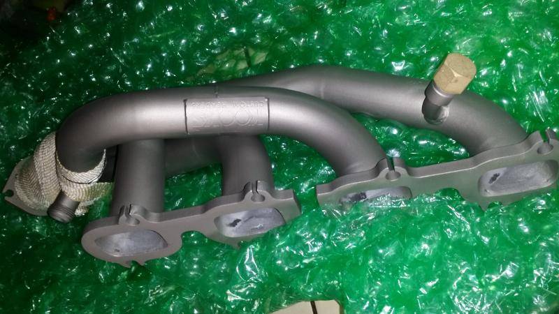

Kooks headers have arrived and I also picked up a traction lock from the great 97MarkJA. Thanks a ton.

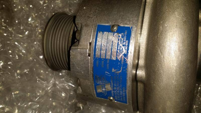

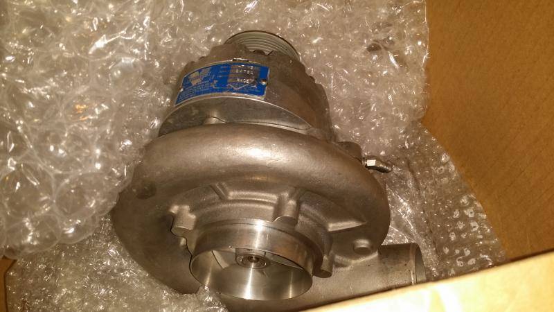

Well I thought since I have a forged engine block and some killer ported heads I might as well upgrade the supercharger head unit. A vortech V-7 YSI blower should be awesome on this setup. The parts pile is going too need a bigger room soon lol.
