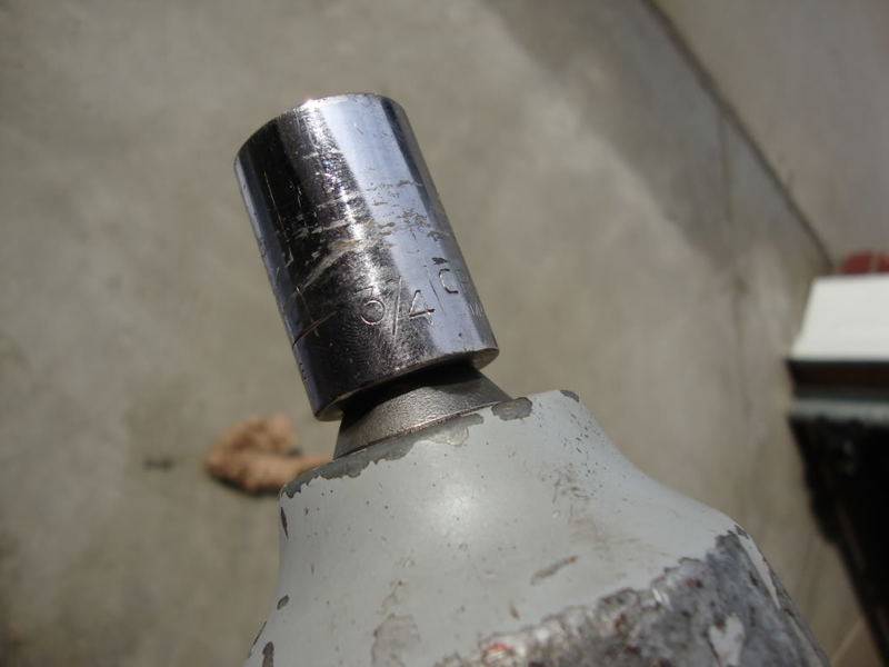

2. Impact and proper socket size (mine was 3/4) or lug wrench

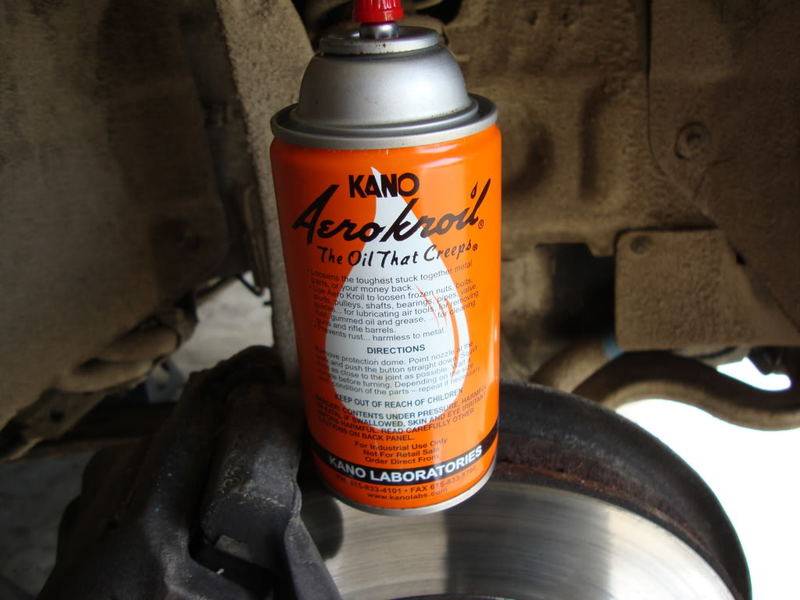

3. Penetrating Oil ( I used Kano Kroil, I think it's the best you can get)

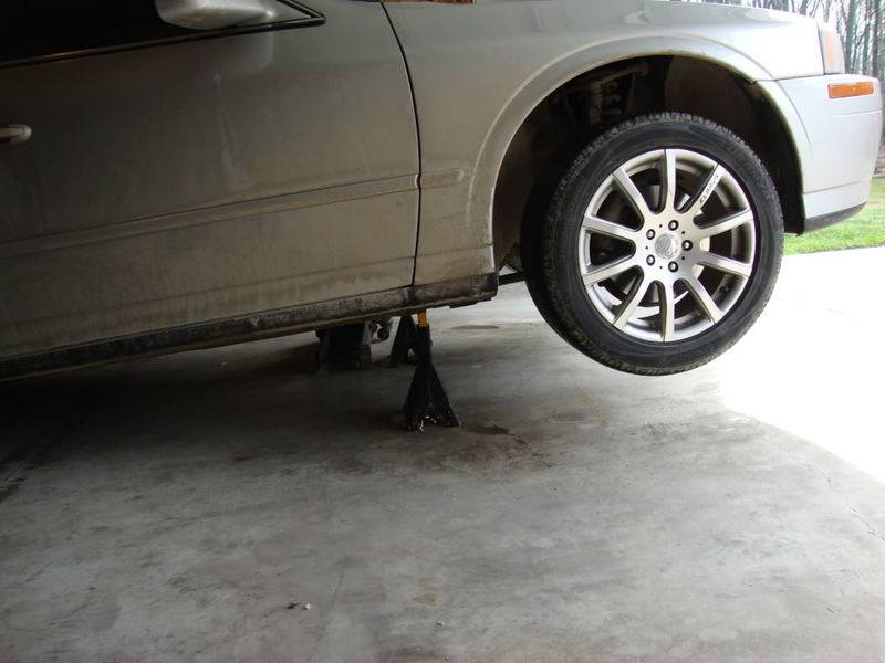

First thing you are going to need to do is jack up the car and make it safe and stable.
Then you need to remove your wheels.

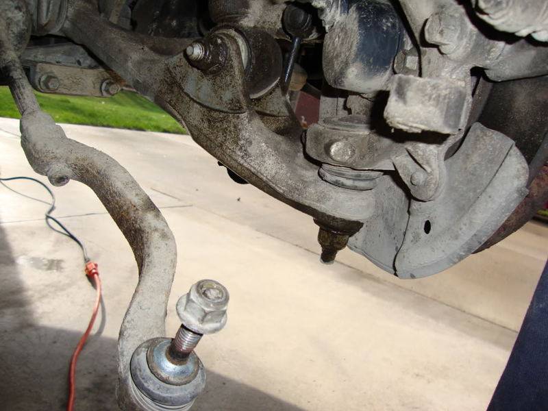

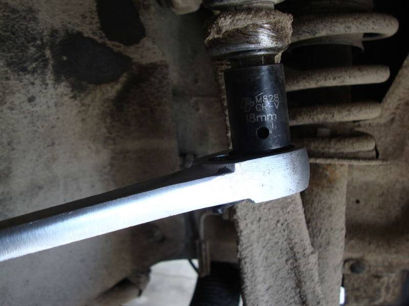

Next I loosened the upper control arm 18MM nut

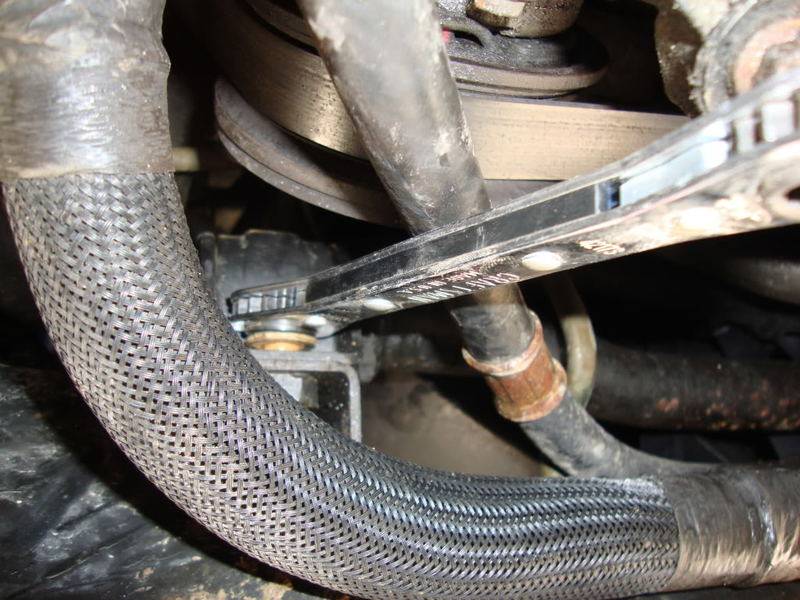

I then removed the pinion arm 18MM for better access to the strut bolt and nut (I ended up using the box end with the channel locks as a hold back to stop the whole thing from turning)
Then I removed the endlinks 15MM

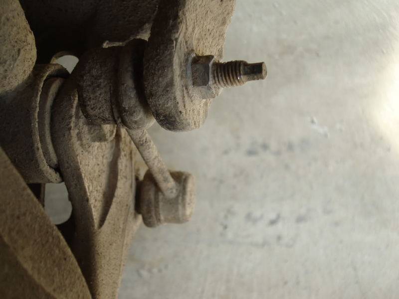

I then removed the lower strut bolt and nut (nut is 21MM bolt head is 19MM)

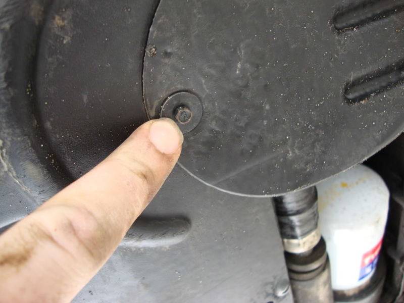

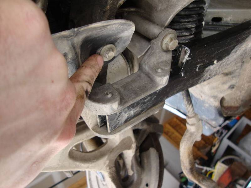

Then I removed all the splash shields, the large piece under the car and the smaller piece in each wheel well. There are 2 different size bolt heads 5/16 and 7/32
The small black ones are 7/32
The silver ones are 5/16
Now you can start removing your sway bar bracket bolts 13MM

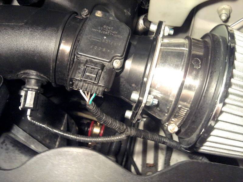

I got the driver side off with out any issue, I used the ratcheting end wrench for the lower and I used a long extension with a universal in the end (3/8 drive) the get the top one. Had to go in through the engine bay. The passenger side however was a little more difficult. I had to remove what I assume was the DCCV. All I know is that without removing the bolts and pushing it out of the way there was no way to get to the top bolt (sorry I couldn't get a photo). There are 2 10MM bolts that were very difficult for me to get to one on the front side and one on the top, to remove. I used my 1/4 inch drive for those. Again for the sway bushings I used the box end for the lower and the long extended socket wrench through the engine bay for the top.

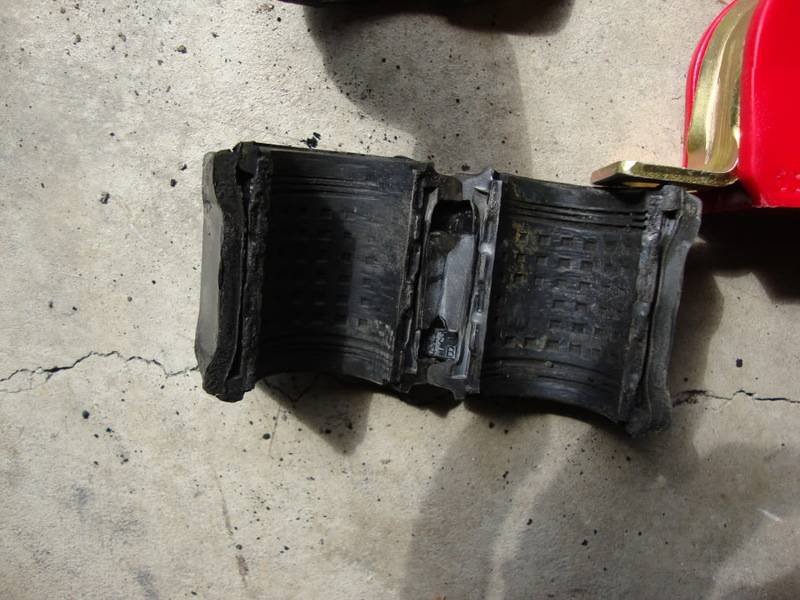

I just pushed the bar up a bit and took the old brackets and bushings out, they (the bushings) were totally shot.

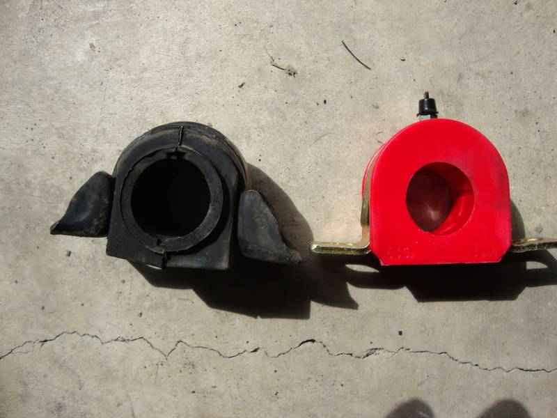

Heres a picture of one installed.
If I remember right it took about 4.5hrs with a trip to the parts store because I couldn't find my 10mm short socket. And it was a desperate attempt to find some ratcheting sockets haha. Not to bad of a job but my hands are still cut up. The gratitude of a silent suspension though. Priceless :)
