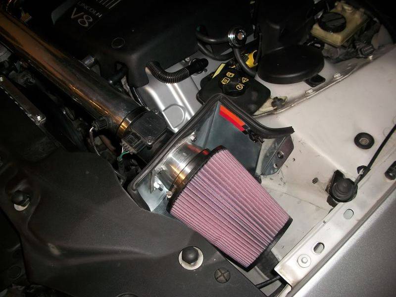

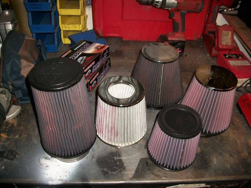

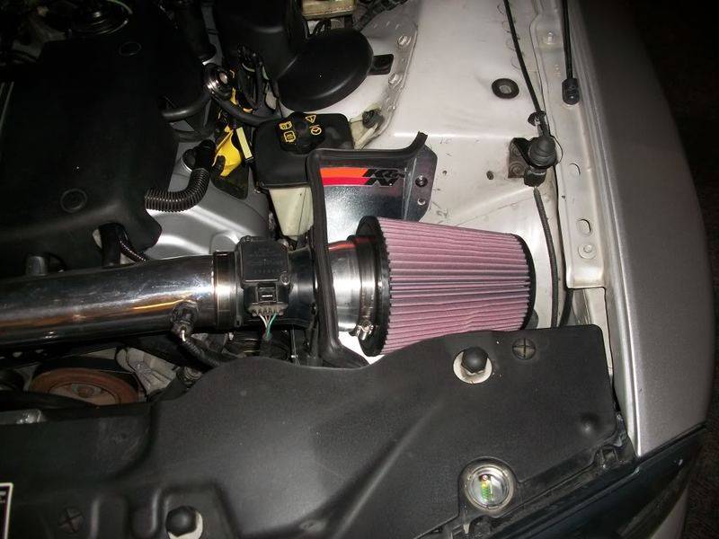

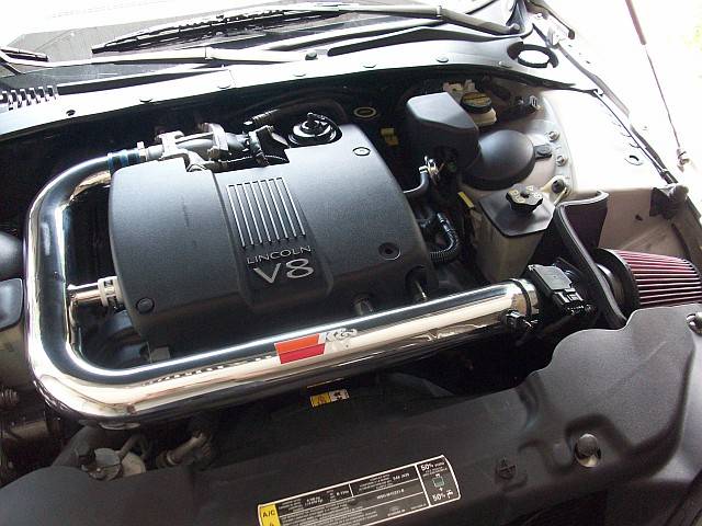

After going thru several cone filter trying to get the best fit for the LSK/AMSI heatshield I got the K&N RF-1015. It is the biggest K&N that will fit and looks great. The people who have purchased the heatsield for the factory intake tube have more options as the area outside of the heatshield is much larger. Here is a pic of the K&N RF-1015...
I have tried several different filters...lol
I JUST had a conversation with a buddy of mine saying my little RU2520 KN filter looks severely undersized. LOL. I have a Spectre 4 inch reduced on hand. Is this the part where I say thanks for doing the homework on what part number works best? LOL

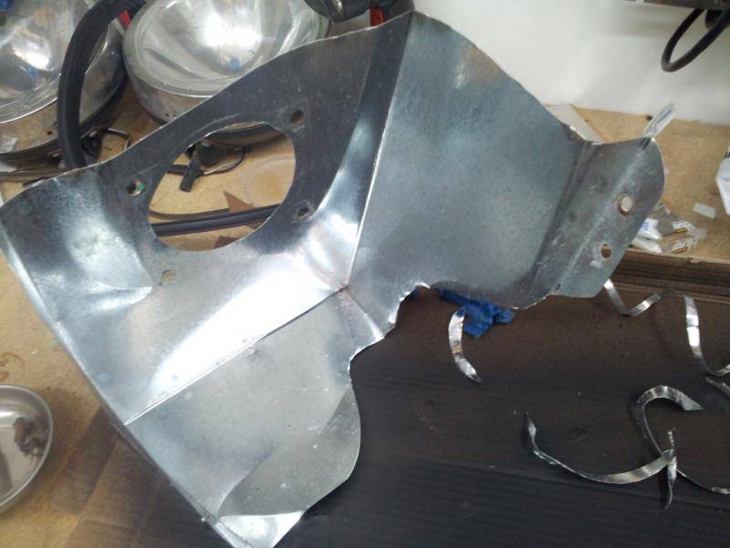

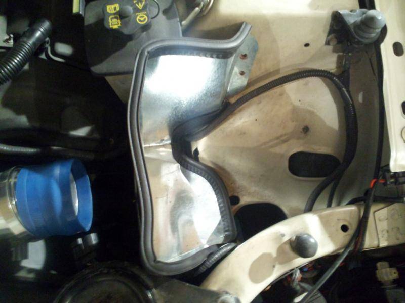

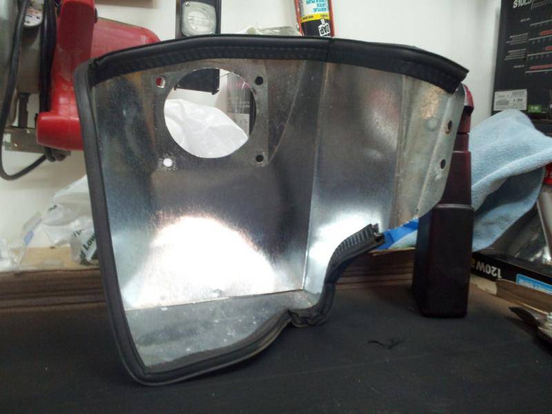

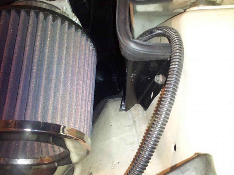

I was able to trim the LSK heat shield to fit a little better with the eBay intake tube. The first picture is of the heat shield installed prior to any trimming. The second picture is of the heat shield trimmed. I trimmed the side of the shield that sits close to the wheel well back to the rivet that holds the bottom on. I probably could have trimmed it back more but didn't want to take the rivet out. The rest of that side I trimmed about a half inch off, except for where it bolts into the car. I also trimmed about 1/2 inch to an inch off the top. Its best to test fit it and see what works best for your set-up.

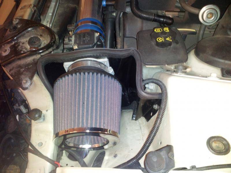

The rest of the pics are of the install which I painted the shield black with caliper paint.

That is what we were thinking, the heat-shield was pushing back on the tube, that is why none of the intake hoses were lining up with the engine cover. Some tin snips and about 15 minutes later it fits perfectly. It also looks great painted as opposed to unpainted.

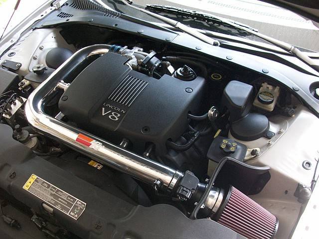

got all the parts ordered and awaited arrival.
Prepped the "HitePerformance" custom GEN I - LS heatshield
and finally got around to installing everything today.
~ sounds much better and gets up and goes a little quicker now.
~ throttle response seems to have improved as well.
