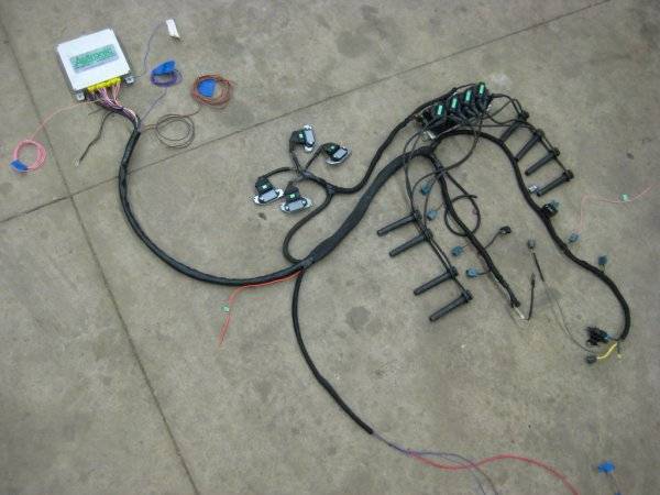

As soon as I can get back to working on this car, there will be updates. I just don't know when that will be... Right now Crab is being awesome and doing the little things that take up busy time when I get there. Between projects at work, he's been working out the ignition system. This includes Northstar engine parts, Diodes, Volvo controllers, etc. He believes he's struck gold on the correct dwell times and output. The last diode is shipping after many hours of research by Crab, and scouring the depths of the dark web for this part. After this and the flywheel (which isn't guaranteed to work), there shouldn't be anything standing in the way of firing this thing up. Haha!!!!!! (sorry, I just find that hilarious). Brian (Crab) sold his Creslaurel http://www.roadkill.com/fuel-getting-laurys-croissants-laurel-cressida/ this week, and posted a picture next to the weed support, I mean Lincoln; made me really want to finish it and do wheelies.
IMG_20391_zpsokm5fzuc.jpgSome Volvo truck parts, Toyota parts, Honda parts, very rare diodes, Cadillac parts, and Crabs "theory" on how to make this work, produced this. We are getting a group of people together for the 2 days I have off in February for a major thrash session. I want a burnout video by that Saturday. And by that I mean, the accomplishment of this car rolling 10 feet under it's own sputtering power.

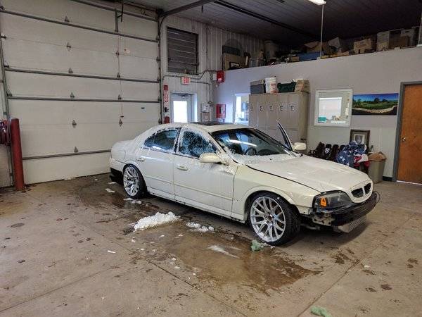

In order to actually work on this car, vacation days were taken and hopes were high. Brian and I started by pulling the car out of its outdoor winter hibernation spot. The light snow cover was brushed off as the doors were cracked. We were greeted with the wafting smell of mice, d-CON, and the still present smell of various burnt/melted items; ahhh, my car.

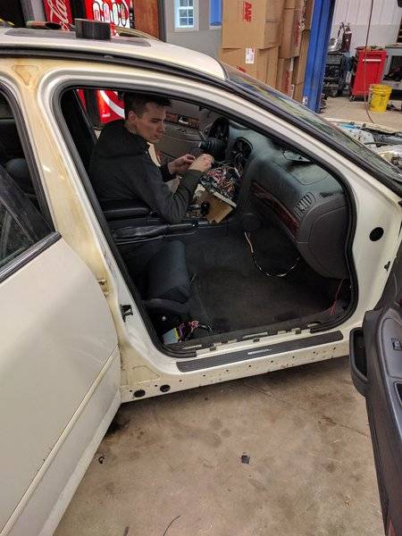

As with everything on this project, a 15-30 minute tasks takes 4 hours. Around 12pm Friday, Brian and I were joined by Mike, who was in town from Kalamazoo. Our main goals were: get the car all wired up and get the new flywheel in, so we can turn the car over.

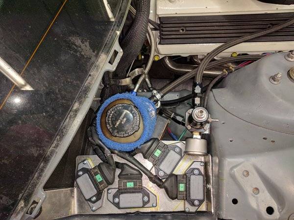

Sitting out in the sun wore off several important wire labels. That was addressed while Mike mounted the ignitors and coils. The engine bay is starting to get really crammed with stuff, so a bracket and mounting table was bespoke fabricated for the ignitors.

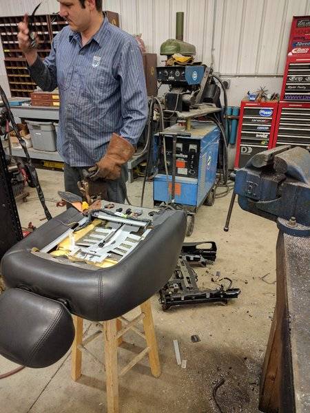

Wiring, soldering, crimping, repeat, repeat. The ECU was mounted as Brian worked on the passenger bucket seat with judicious vigor.

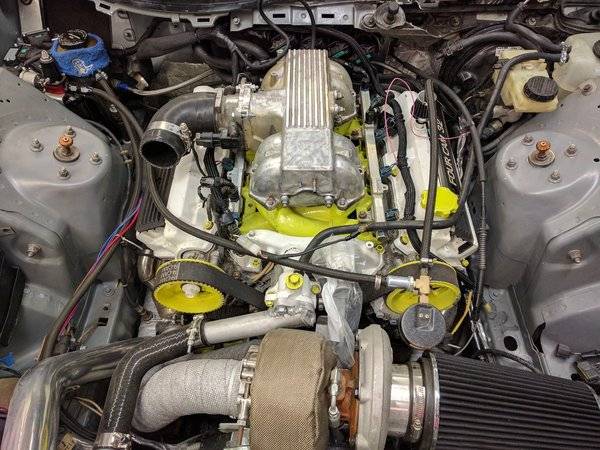

After nearly 3 solid weeks of studying, I now have my FAA Aircraft Dispatcher Certificate. So time restricting source number 1 gone. Now the issue is that my wife is back to work. I work Fri-Mon and wifey works Mon-Fri, so I am with Connor three days a week with zero days of overlap. Ordered a flywheel that was being "Shipped tomorrow" about 4 weeks ago. Throttle body, IC piping, BOV just need a few hours of work at the very most. The LQ4 COPs will 100% not work with my ECU, so I'm working on sourcing/cobbling together a new ignition setup. Other parts have been "shipping" for months from overseas. So many aspect of this build have been just waiting for parts. The interior is coming together and we hope to have something presentable next time I get out to the shop; the issue is that I have no idea when that will be.
Since ya'll like pictures. Here's the newest version of the MetSHO:

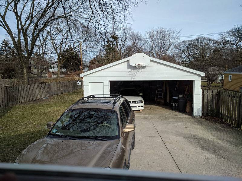

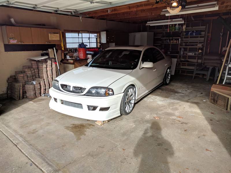

Car sat outside all winter under a pile of snow.
I didn't work on it a single day. All money and resources were directed towards finally buying a house.
Car is on level ground and not gravel, and has a power supply within 5 feet instead of 100 yards.
And yes, the bumper needs a lot of work to fit, but I just wanted an idea of what it will look like.
Great to see its under a roof my friend!
