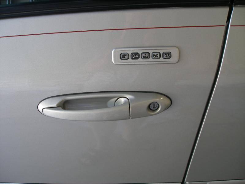

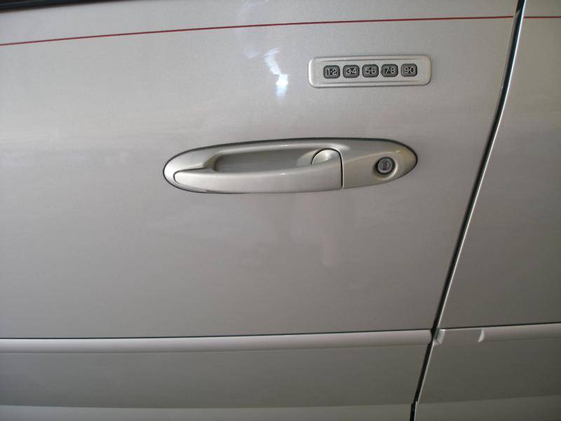

Okay, so it's part of the paint process that causes the orange peal effect.
Wet sanding is the usual way to correct this?
What does wet sanding do to the paint job? Strip the clear coat? Prepare the paint for oxidation?
pics are up
on the original post
What grit did you use ?
Mostly 2000. On the rougher areas, I started with 1500, then followed with 2000. Then Menzerna Power Gloss/wool pad, then Menzerna Super Intensive polish/green foam polishing pad, then Menzerna PO85rd/3M UK blue waffle finishing pad.
