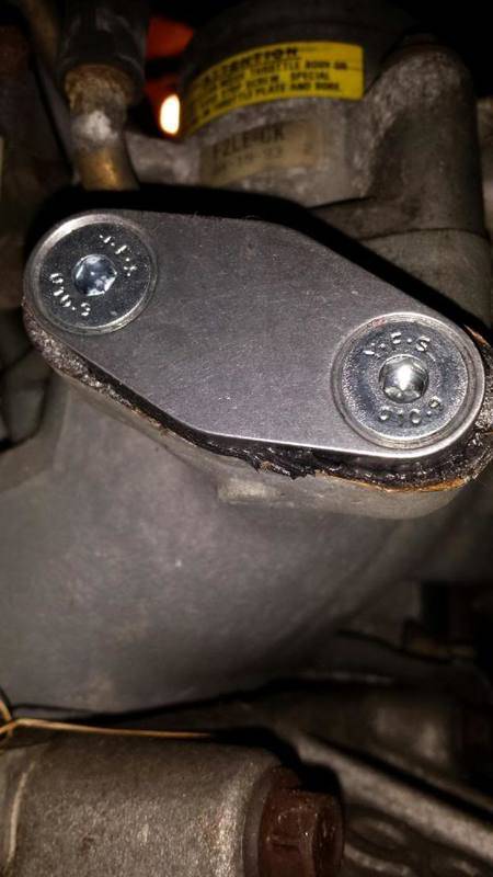

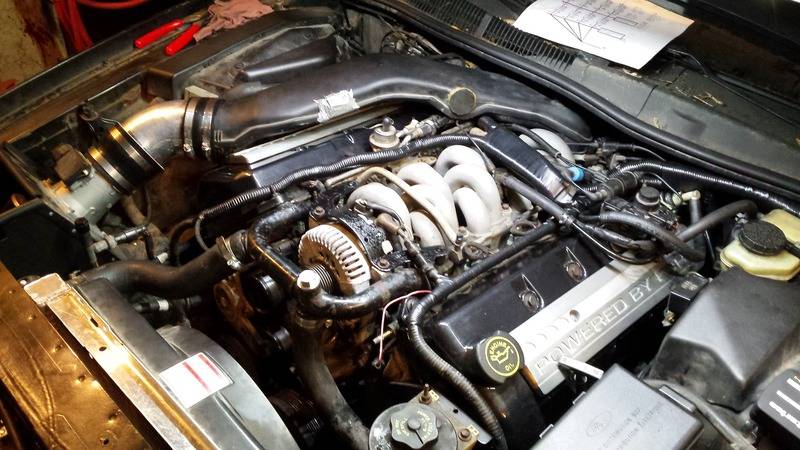

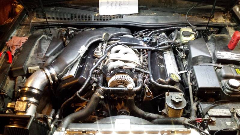

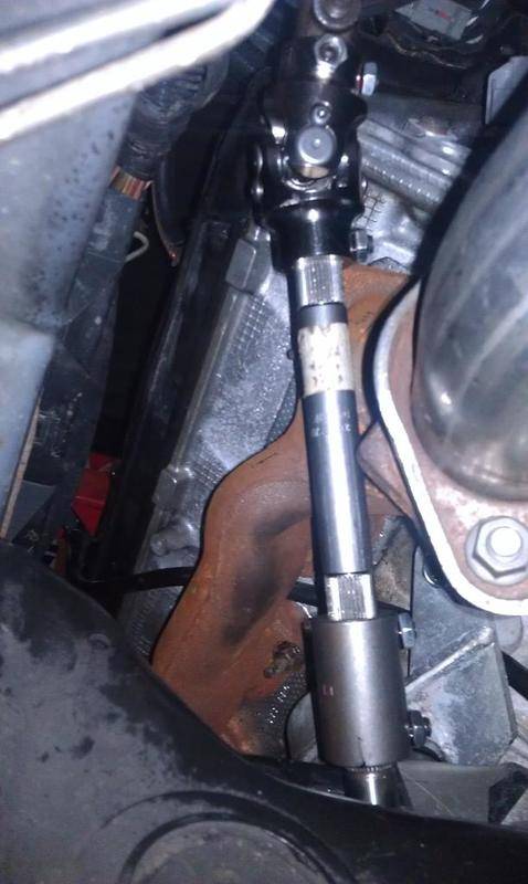

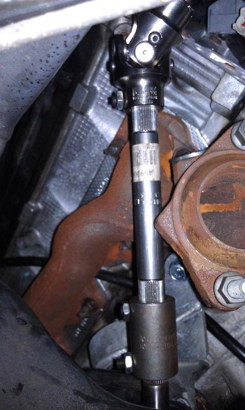

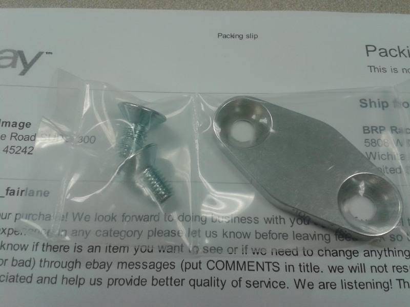

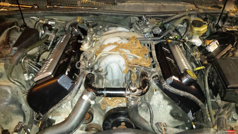

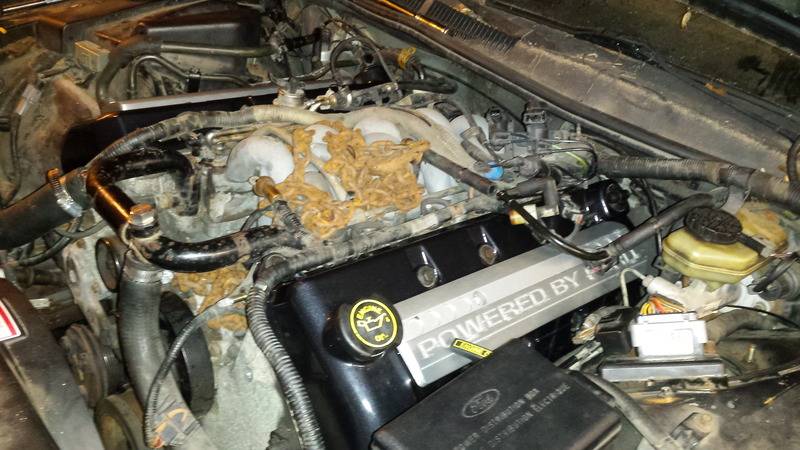

Ordered my EGR delete plate for the back of the intake off ebay, hoping it gets here before this weekend. I'd like to get the K-member back in its rightful home soon so I can get the steering shaft, p/s pump, rack, and hose in place and move on to the exhaust!
Some cool stuff has been happening slowly over the past few months!
My EGR delete for the intake
Installed

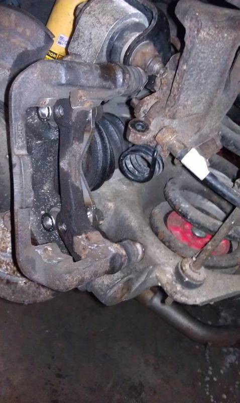

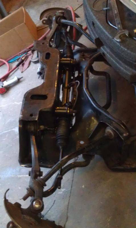

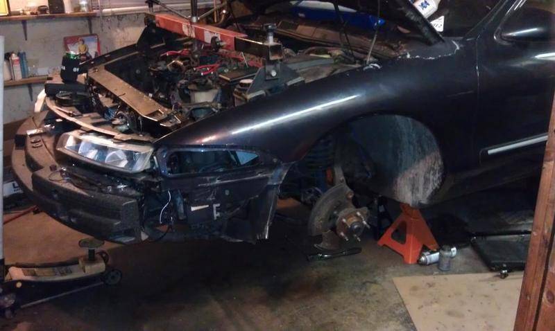

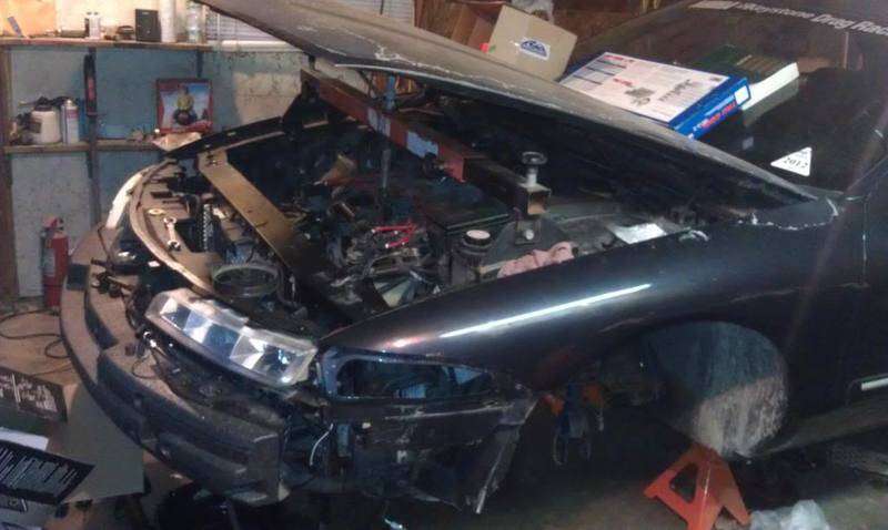

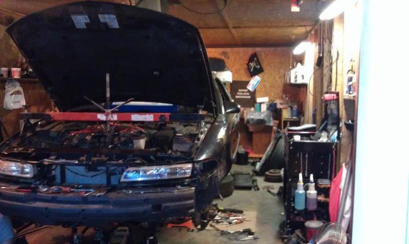

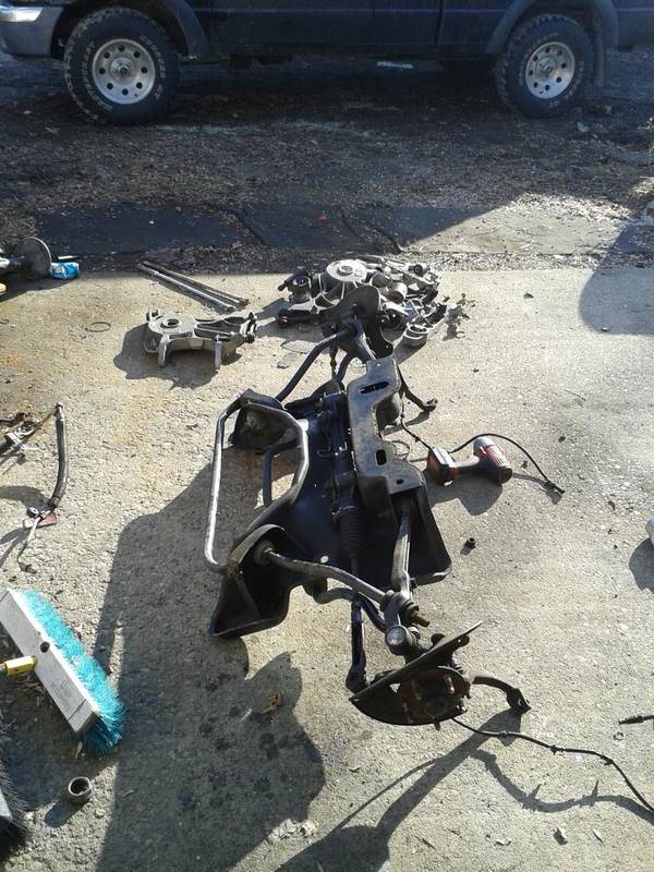

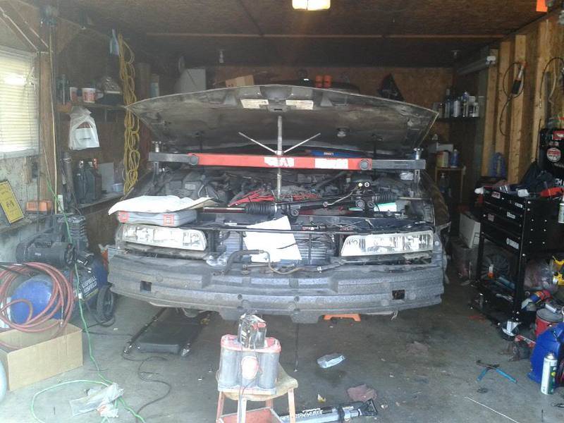

Got the front subframe yanked out, and ready for the old wore out power steering rack off to come off
Got the K member all cleaned up and ready to go back in, was waiting on rack to arrive.

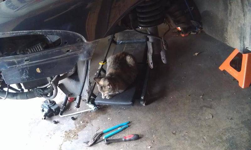

Lazy shop cat...

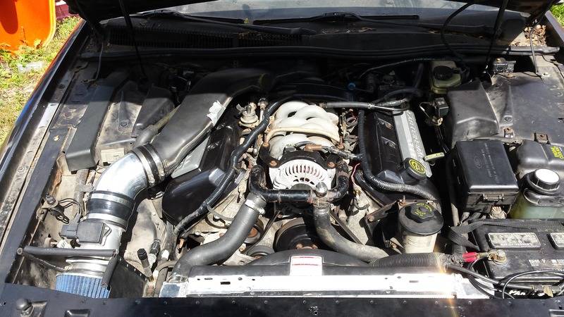

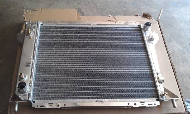

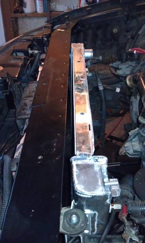

Then I found this on the interwebz
And it needed a lot of adjustments made to really fit right, but will work.
You can see its sitting in there tweaked. It's just how they're built. Had to shave down the lower rubber pads to half of their original thickness, and also tweak the holes in the fan shroud in order for it to line up perfectly w/ the radiator, but got all that sorted out.

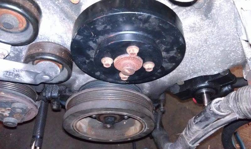

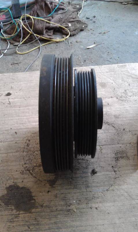

Now I will show some parts for the haters lol

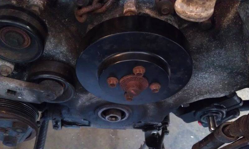

Yes I know. It's mine. If it breaks, its my fault. I know some of you dont like piggyback pullies.
Lazy shop cat is lazy

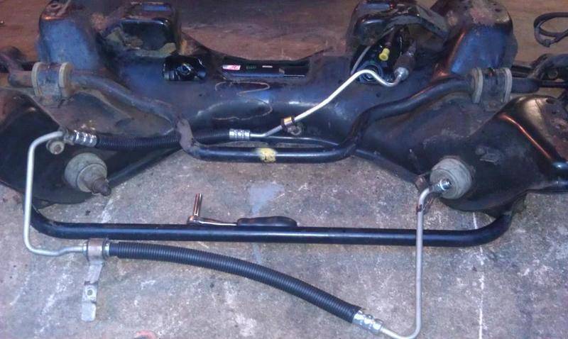

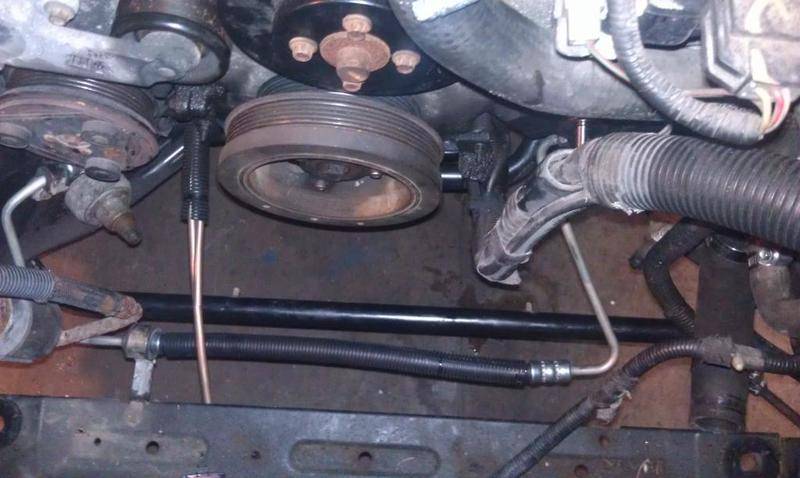

Well, except where I had to clearance the K member because the remanufactured rack had slightly different lines than the original. And I didnt remove all the old lines from my junk rack before I scrapped it. Whoops. Oh well, quick work w/ a carbide bit.
Rack installed, w/ urethane bushings. New high pressure line installed as well.
One last look at these beautiful parts before it goes back together and they become forgotten about...

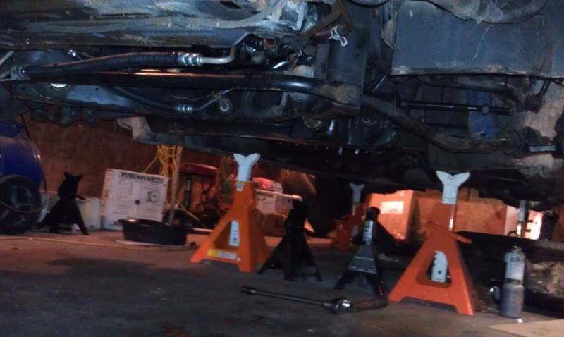

K member found its way back in the car!
You can see my alloy transmission lines. They are S.U.R & R lines. Which are great by the way if you do trans/brake lines!

Ohh yeah... look at that... it's glorious... all this time... now I will finally have Cobra manifolds/full exhaust w/ no cats and the steering mods to match! it's a good day!

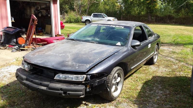

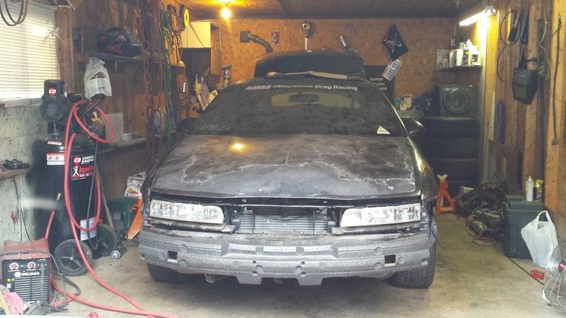

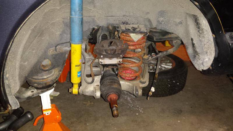

You have the IRS apart too?
No. Not yet. Didnt want to yank it apart if I didnt have a new gear to go back in it yet. Soon though. I will hopefully be making the exhaust sectional so I can remove it in pieces if need be. For reasons like the IRS.
Ah.... I saw the lower arms in one of the pics, looked like you had it apart.

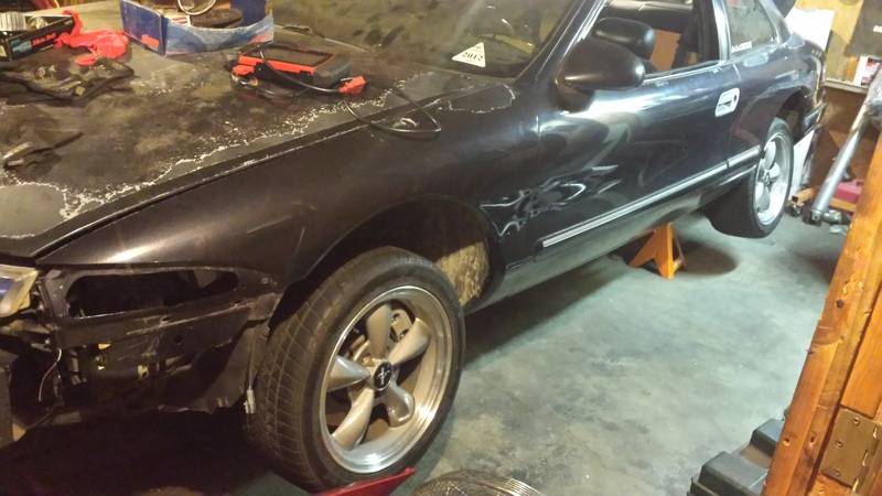

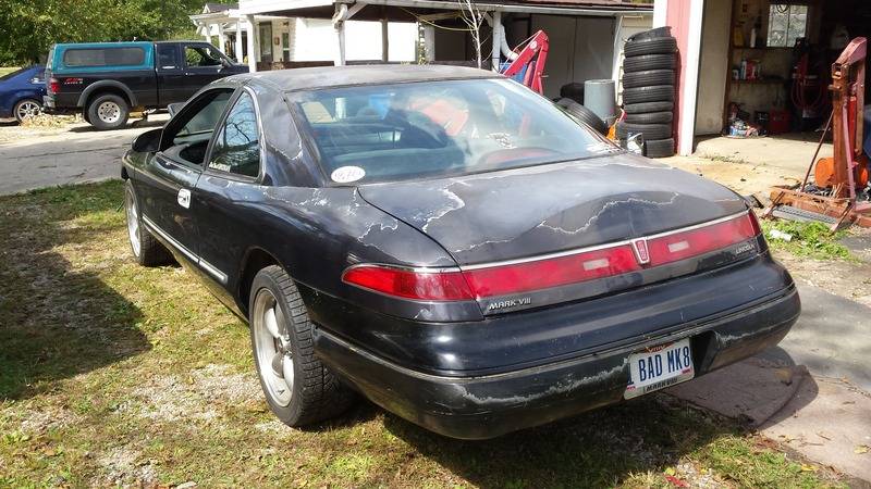

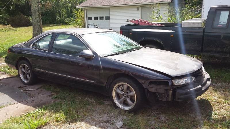

Ahh, the outside pic... yeah those are broken control arms from my parts car thats long gone. Car took a hard hit.
I think I was pirating what good bolts were left out of them.

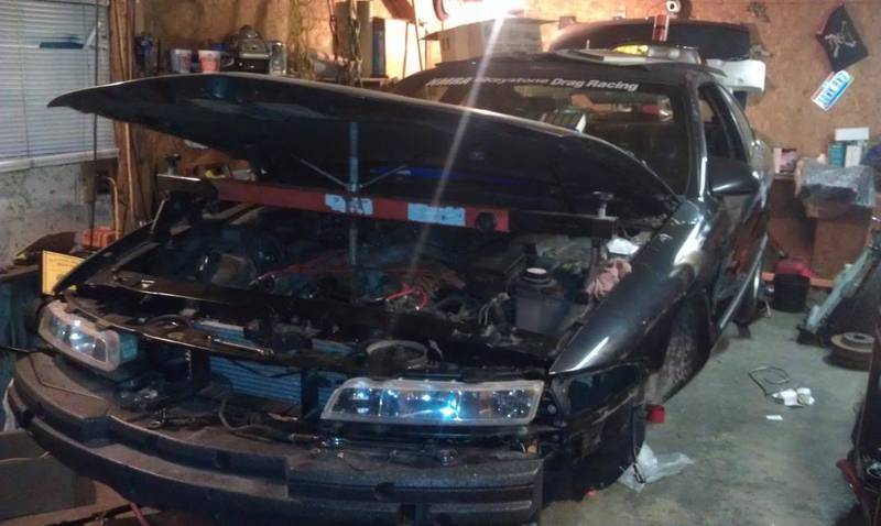

Will hopefully be working on this pile of parts again this weekend...
K member has to come back down for some adjustments to the motor mounts. Hopefully that will get squared away in a day. I'd really like to start focusing on the exhaust.

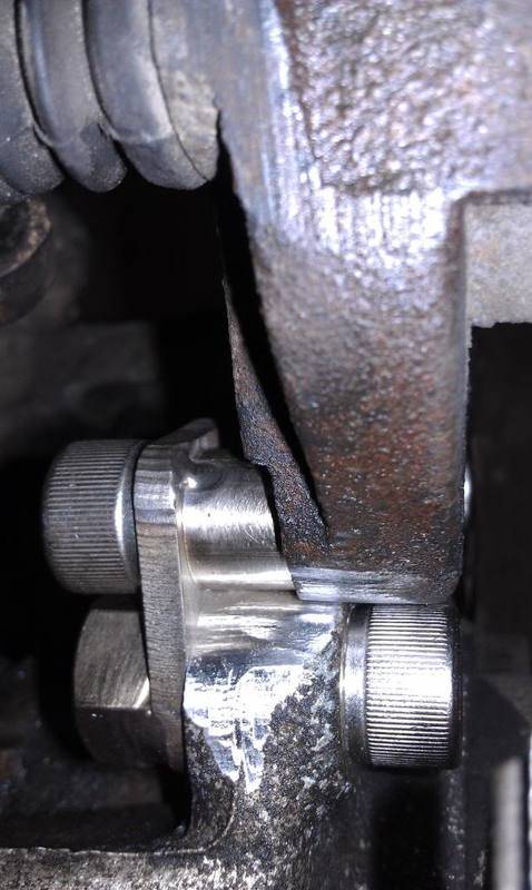

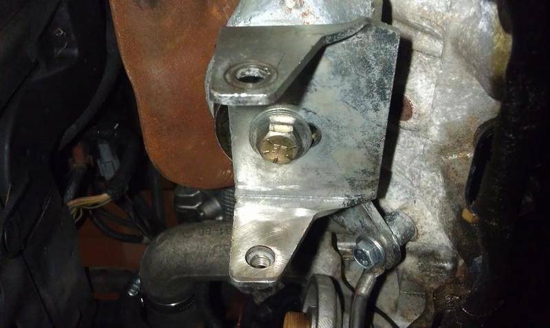

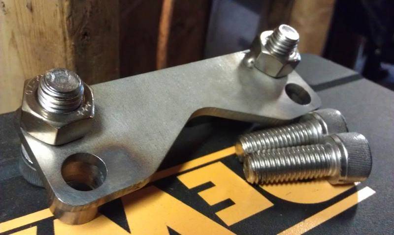

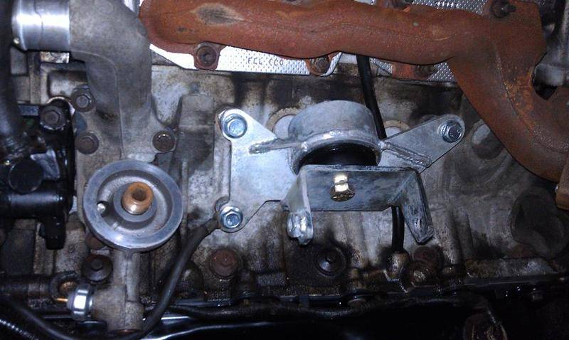

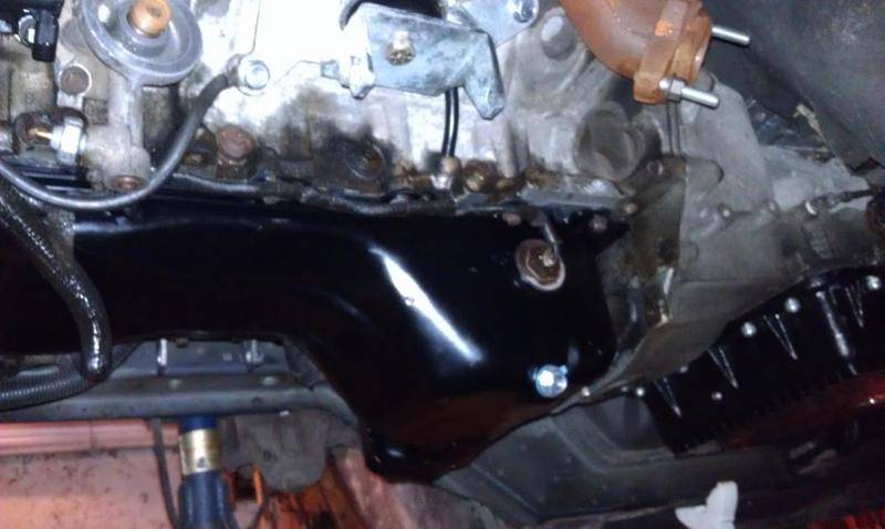

So, last I left off, I was having an issue w/ my TurboChuck motor mounts. I ended up having to slot the holes to let the bottom of the mount move inward. Took somewhere in the neighborhood of 1/4 to 3/8 of material out of the mount, and that made a huge difference. The went right together in the car, drivers side took a little convincing due to being in a bind, but eventually got it. So the engine and the K member have officially become one again. Now I can start focusing on exhaust, and other items.

Then, I added loctite to the threads, and attached this in place once and for all

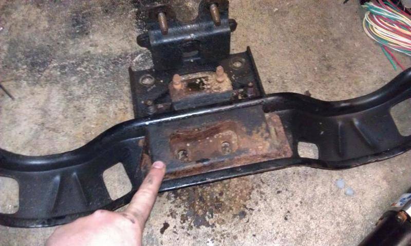

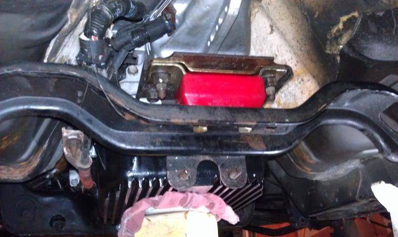

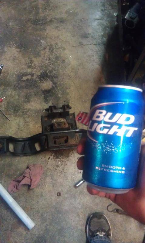

Next was to install the Energy suspension trans mount. Since I couldnt get any of the bolts loose under the car, I took the crossmember out. The weight in the center of the crossmember was shot, and the little balls were falling out of it. And, because racecar, I dont need it.
Had some motivation
Then it dissapeared, and the ES mount was on for a test fit
Threw it back up in the car with relative ease
And scratched something off the new list!

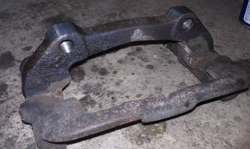

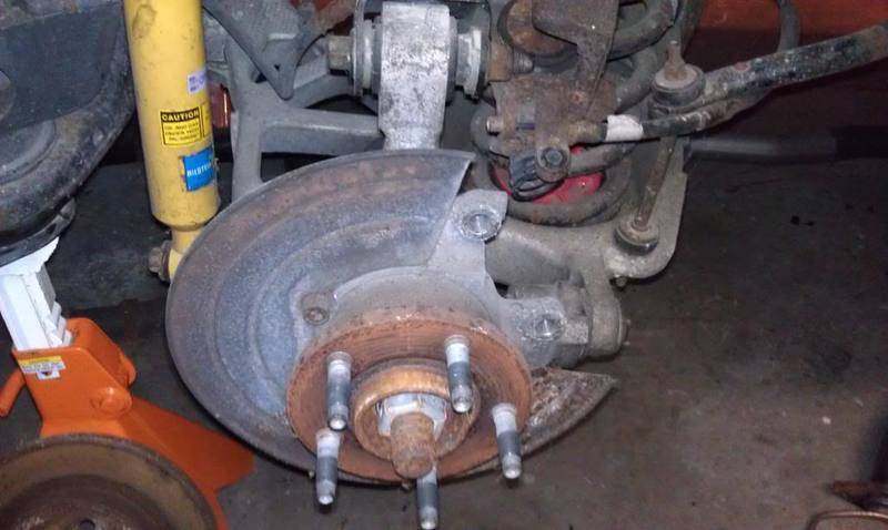

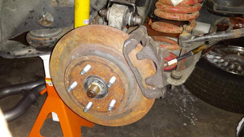

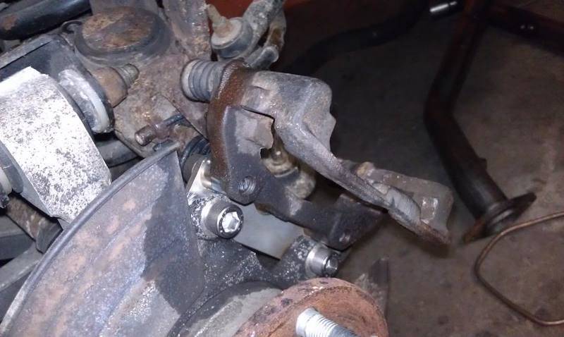

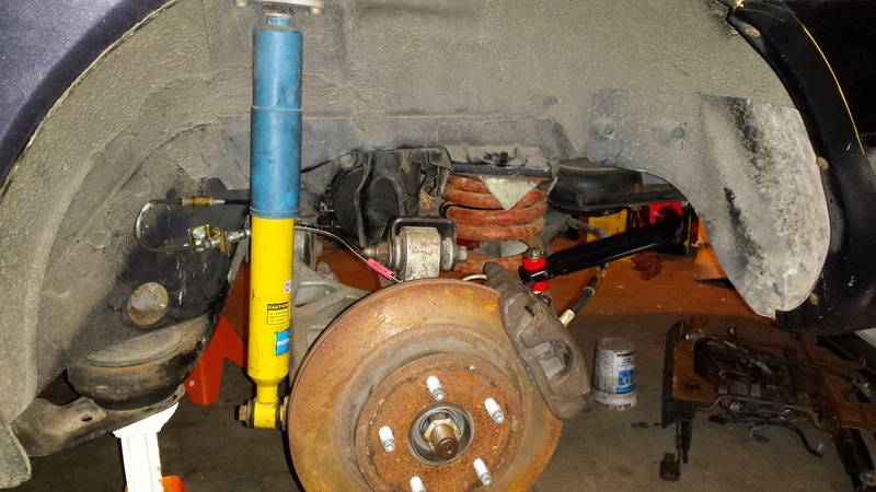

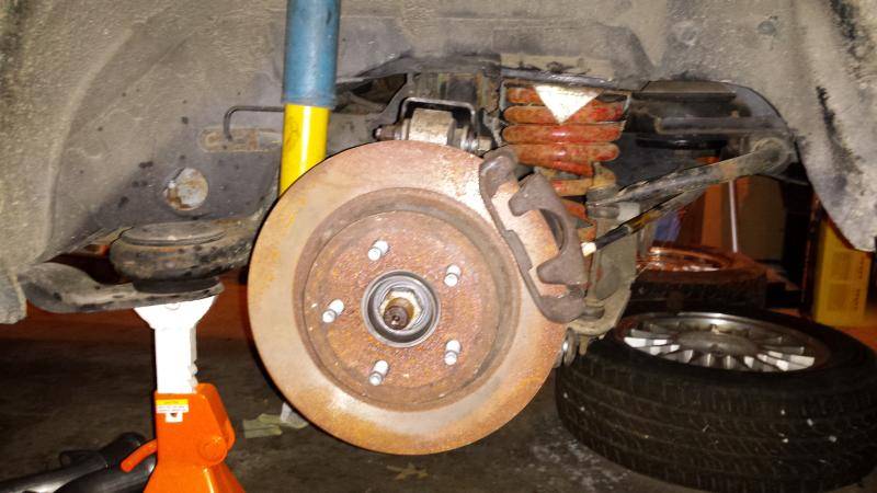

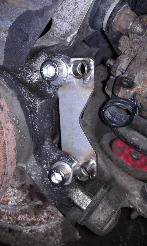

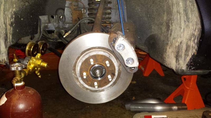

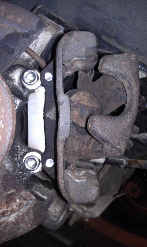

I did the mustang hub swap and also the swap to Cobra brakes and installed stainless braided lines

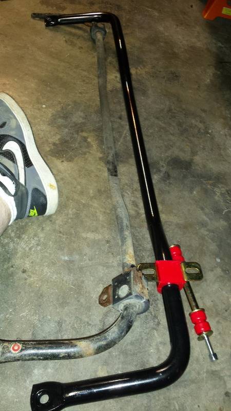

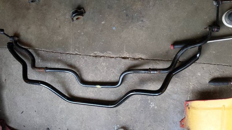

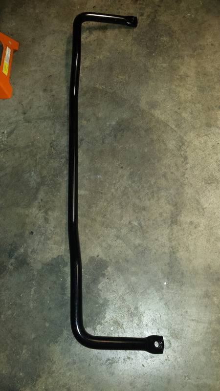

Oh I also happened to get some of those big heavy awesome sway bars :)

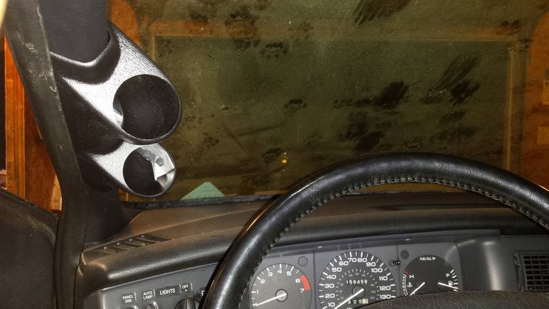

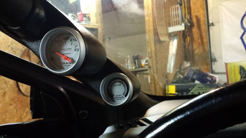

Installed the gauge pod for my trans temp gauge

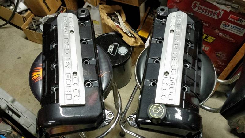

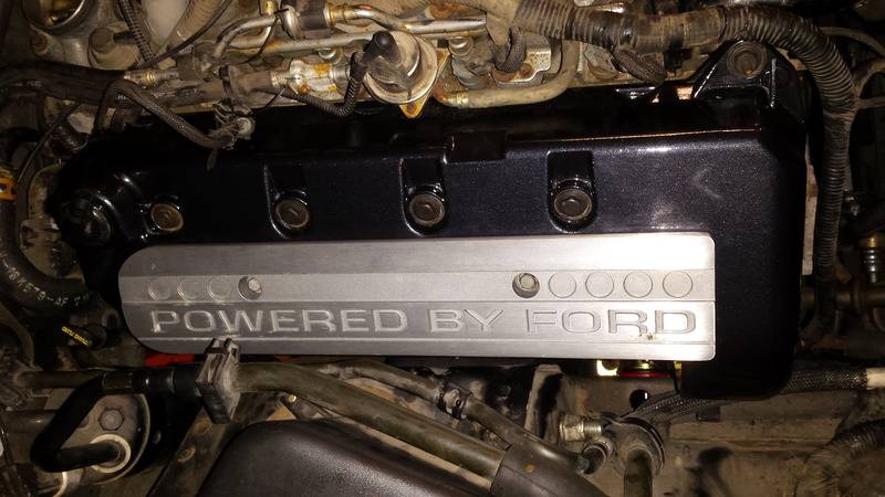

Also swapped to coil over plug and installed my cam covers that I painted to match the color of the car. And fancy Ford GT coil covers!

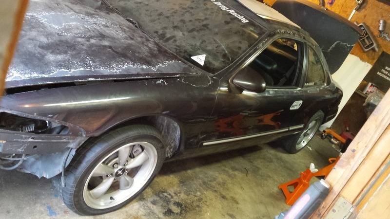

it sat on the ground for the first time in a LONG time

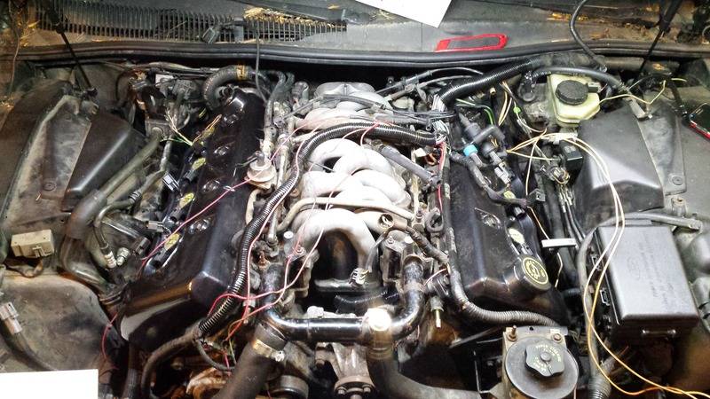

Since it was on the ground we were able to wire up the C.O.P. wiring

finished the gauge pod install. the AFR gauge is a dummy space holder.

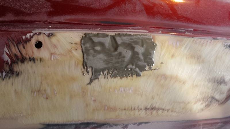

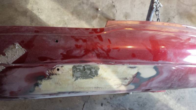

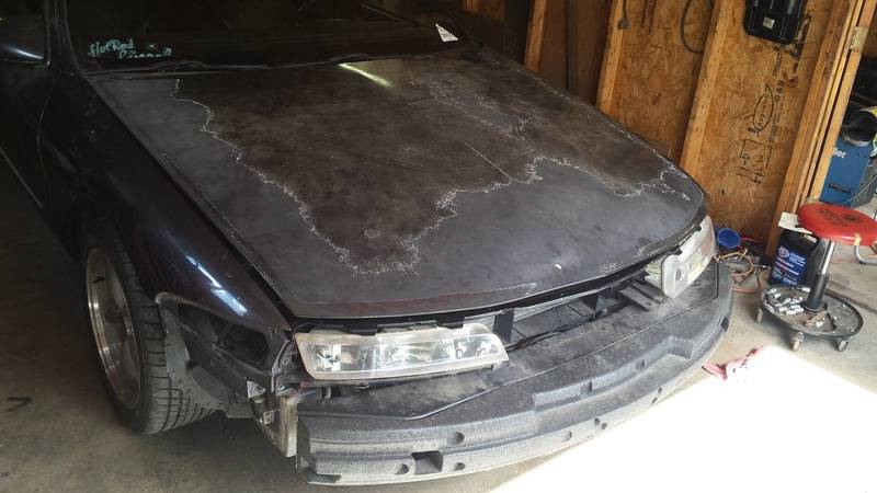

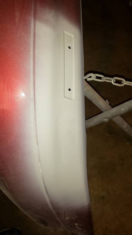

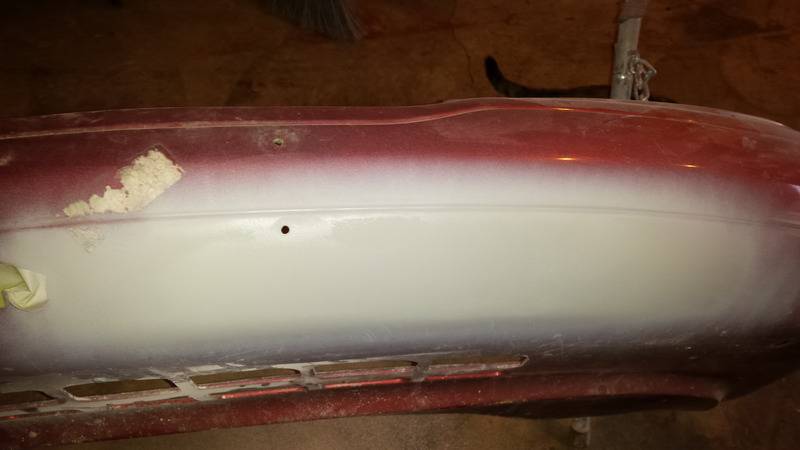

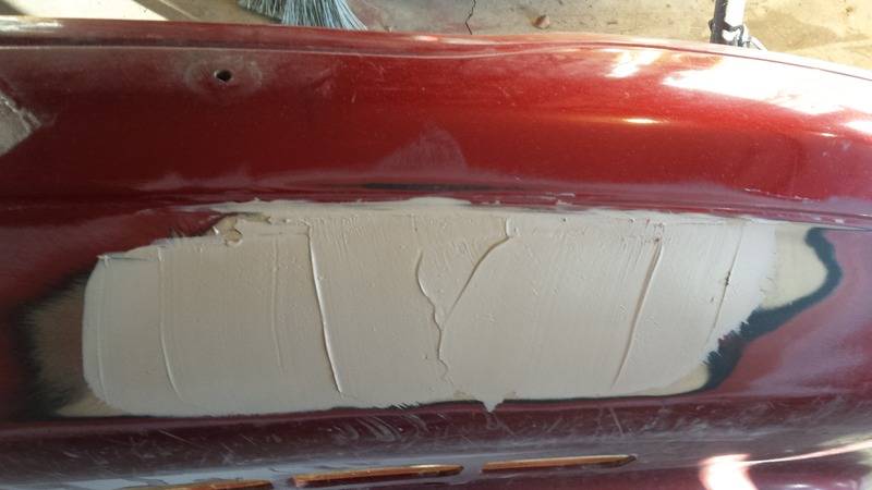

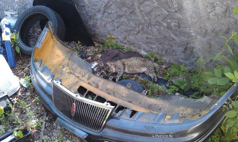

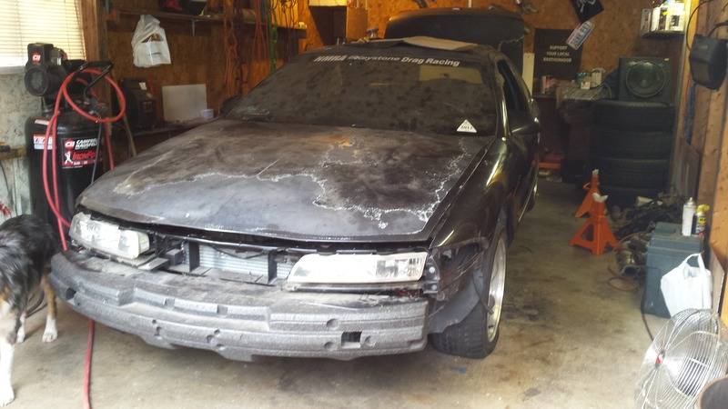

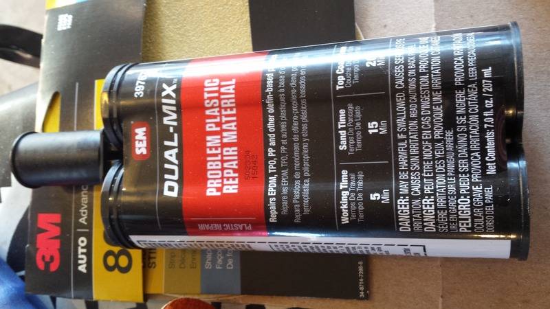

next we started repairing the front LSC bumper cover I got a while back.
this stuff is amazing

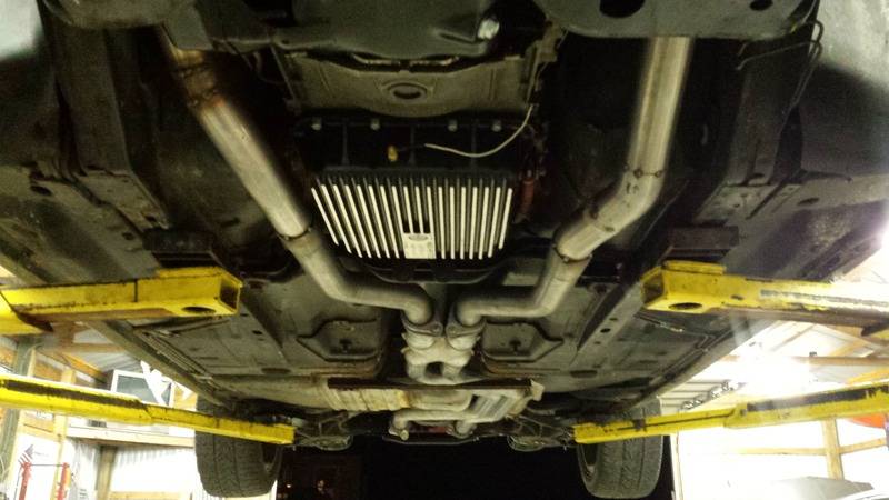

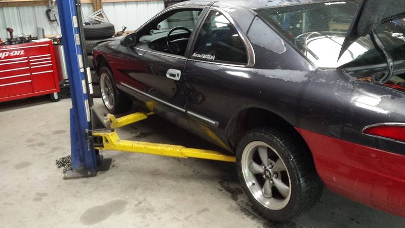

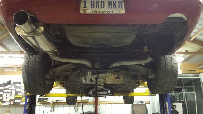

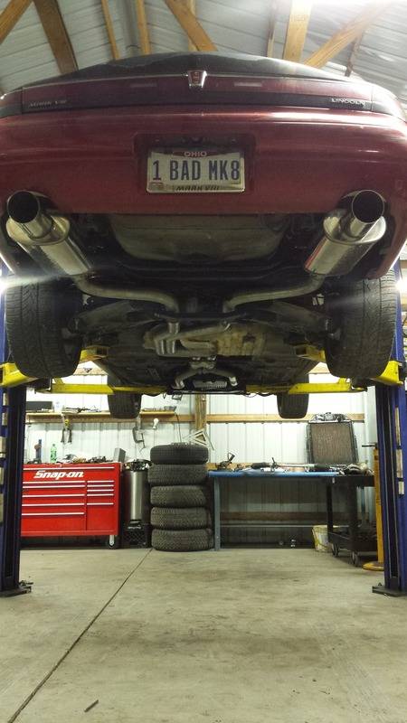

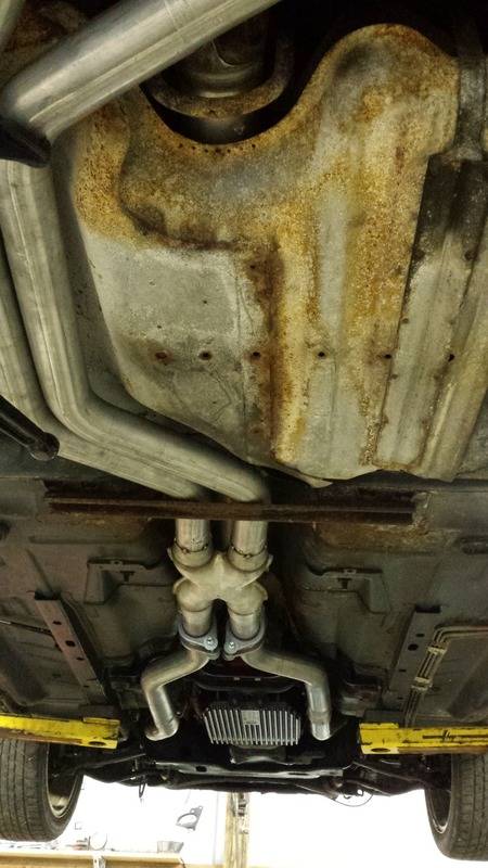

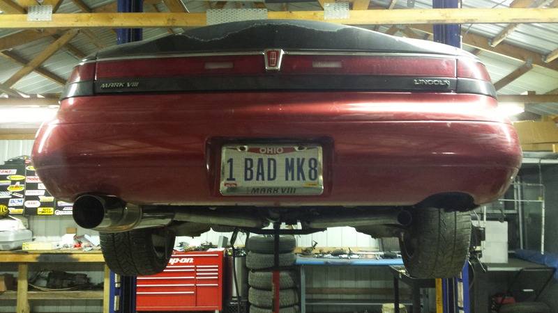

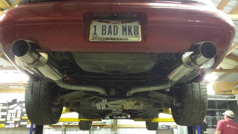

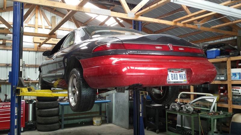

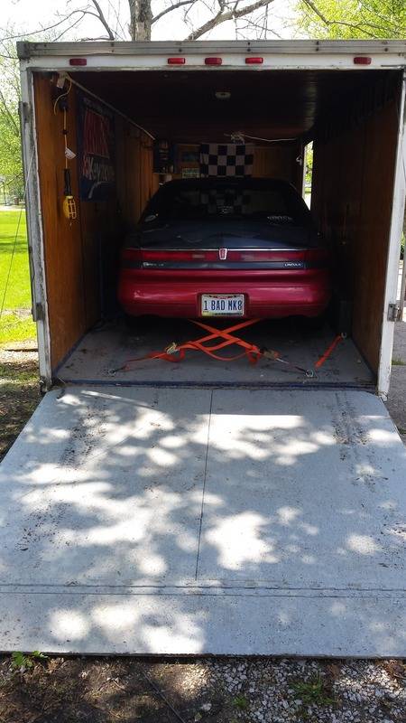

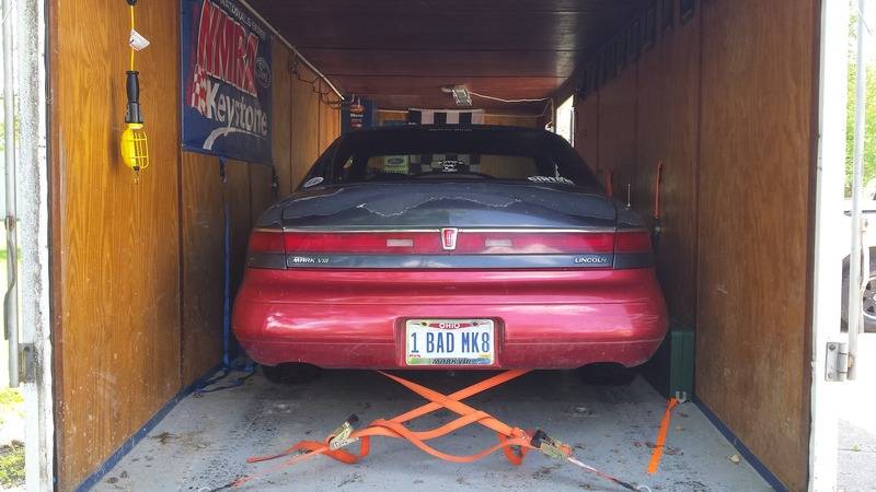

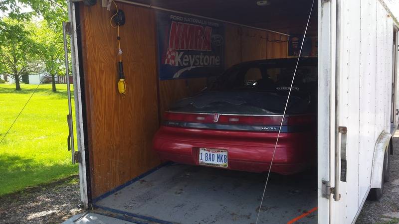

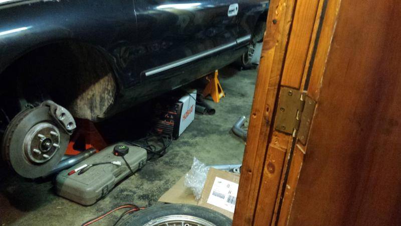

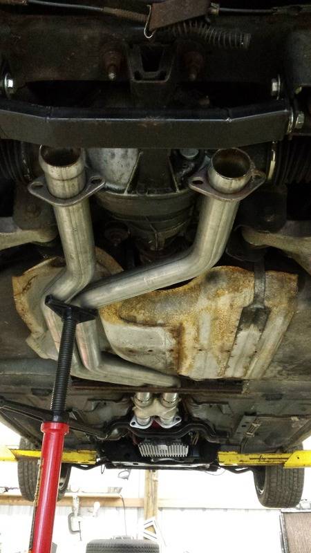

So there wasn't much to do now besides get the exhaust done so we loaded it up in my friends trailer and took it to another buddy's house who has a lift. This is more recent. So sunday I loaded the car in the garage and lifted it up and got things started.

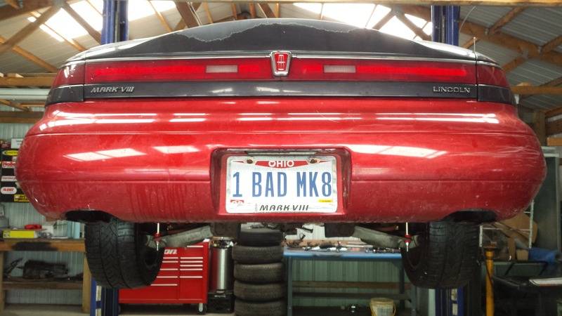

If you haven't noticed by now I swapped a rear LSC bumper on it too.. lol

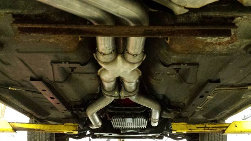

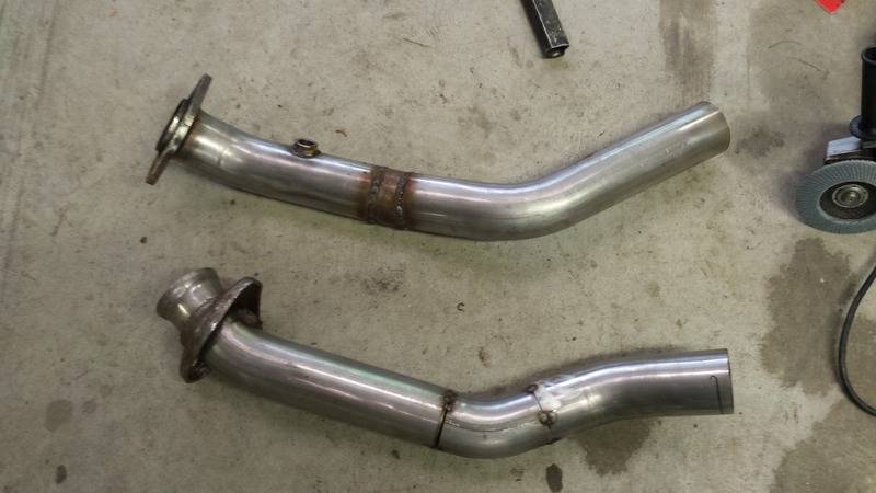

These flow tubes started as a JBA H pipe to a 4.6 GT. Heavily modified of course.
mocked up the midsection after welding the X in.
Tested the fit of the front flow tubes to the X
Got one muffler mounted... I used the stock hangers and flipped them from one side to the other. And then bent them a little.
then got everything fitted and tack welded. So its sort of "done" as far as exhaust goes.
going back this sunday to finish welding everything up and install the o2 sensors and flange gasket for the passenger side cobra manifold.
