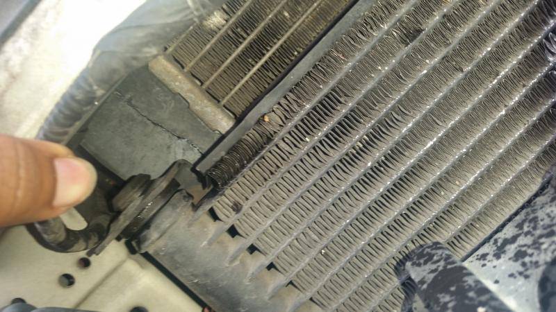

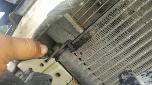

This thing is cracked causing my car to overheat

Looks like one of the tanks on the radiator. I don't think any type of plastic weld will hold up. Good news is a radiator is less than $150 new.
I looked on ford auto part giant website for the part and It was discontinued tasca doesn't have it either I believe rockauto has it but yall said they take a while to ship

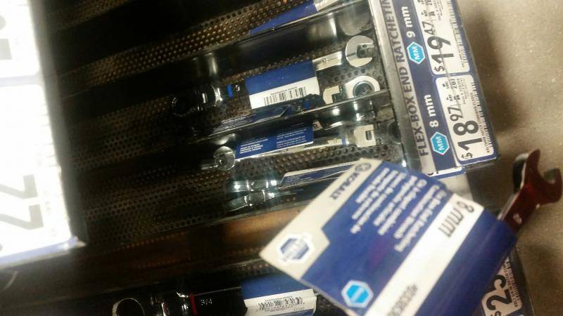

Nah. The radiators aren't hard to come by. You're looking at somewhere between $120-$150 for the radiator if you install it yourself. Personally, I would inspect the other cooling plastics. More than likely they will need replacing as well. As for the radiator... clear your schedule for the day. It's not a fun job. Don't be discouraged though, it can be done. I highly recommend getting an 8mm racheting wrench for this job though. If you don't, you'll be wishing you had.

Radiators cracking/failing on the LS is less common than the other cooling plastics failing. But LS radiator failure is far from unheard of.
You have not listed your particular year of LS, or it's engine size. All you have to do is Google search and plenty of radiator options will be listed. Such as this...

The radiators are one of VERY few exceptions to OEM for the LS. When you purchase your cooling hoses and plastic assembly's (including your Degas tank), be sure to use Motorcraft OEM replacement parts.

Don't forget that 8mm/5/16ths racheting wrench.

The $155 radiator at O'Reilly (it's a Murray) should be just about as good as any and will fit your 2005 V8. I would suspect that the Ford one (if you could get it) would be a little better, but probably not that much.
