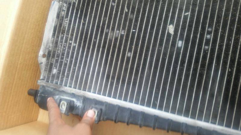

This thing is cracked causing my car to overheat
Its finish took me 8 hours that's not how it was supposed to take I just don't know what im doing and actually don't even like working on cars
Lol this morning it was driving me Crazy and I was getting delirious I thought the bumper had to come off I just needed some rest
uploadfromtaptalk1436993099083.jpg this is where the crack was at towards the top if any one has any questions let me know
