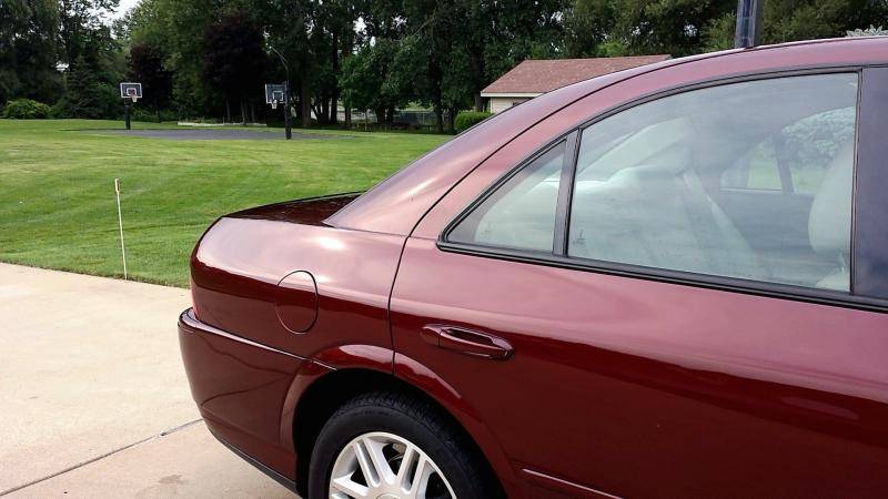

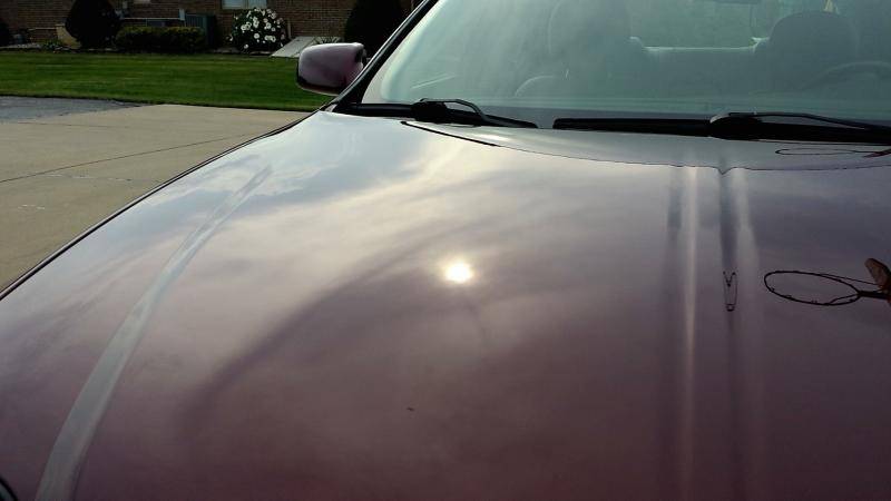

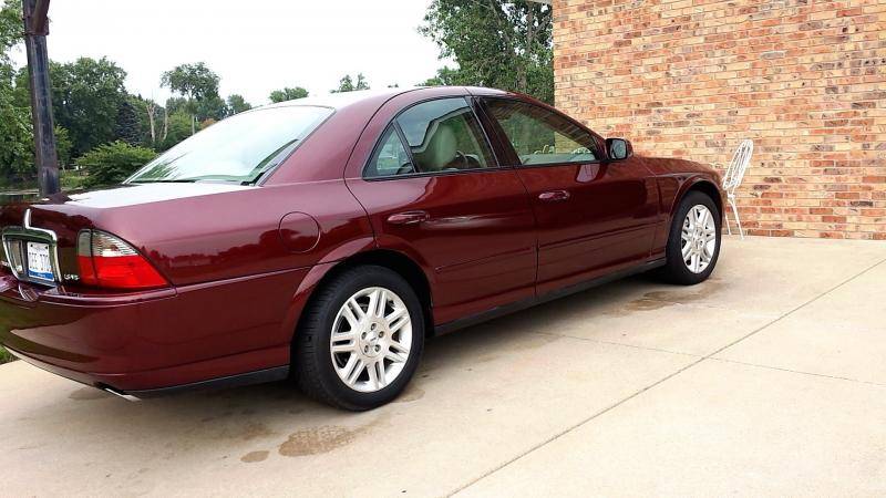

Gave her a bath last night, hit the wrecking yard for a ash tray today. After being told yesterday that one of their other yards (an hour away) had one, we headed down today. And of course, they don't even have a GenII :mad: But I was determined not to walk out with nothing, and I found a couple good strut caps, or what ever they car called, which they just gave to me. All cleaned, shined up and on the car now. There was an GenI LSE rear plate surround that appeared to be good, but unfortunately no good grills that I could use on my car.

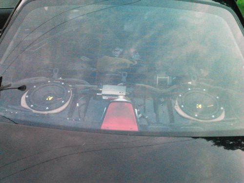

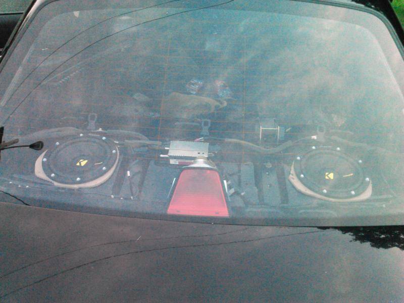

This weekend I put a pair of subs in the rear deck since both of mine were blown. There was maybe 20% of the surrounds left. Here's the real kicker: 8" round subs. I'd say I'm happy. Kicker 40CWD82, 200 watt RMS, dual coil 2ohm (gives me flexibility down the road), 7" hole.
Hidden from the outside without taking up trunk space. I'm using the factory amp for now, but I'm surprised it doesn't clip (amp pushed too hard), which is worse than bottoming out (sub pushed too hard). I'd say I'm happy
I almost threw my hands up and tore them out, thinking I did really shoddy work. I turned them on and there was an awful vibration/rattle/mini earthquake noise when they hit. I thought the 1/4" MDF adapters weren't strong enough. Nope, the car wasn't assembled yet and the high brake light is extraordinarily loose without the rest of the trim. I "dynomatted" the light, amp, and tuner with kitchen drawer liner just to be safe.
