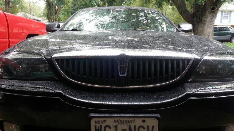

My spar urethane coating has worn off after a year. Must be the harsh winters here and I think Optimum PoweClean did a number on them too during my spring detail. Going to be trying something else.

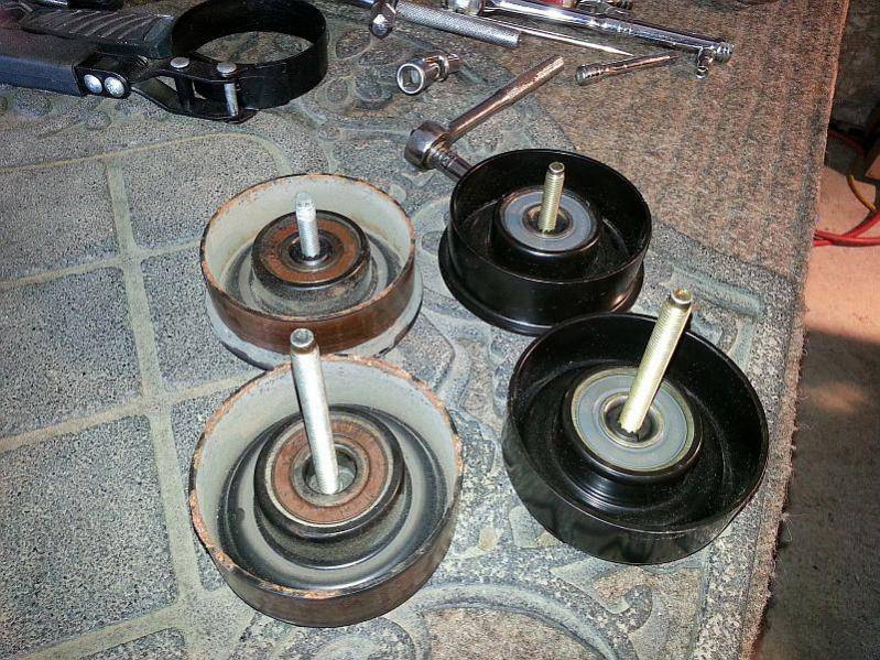

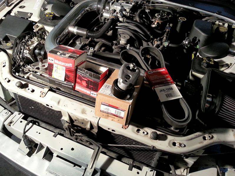

Changed out accessory drive belt system parts. runs much quieter now on fresh belt.
old bearings worn out. new tensioner pulley was smaller diameter than stock.

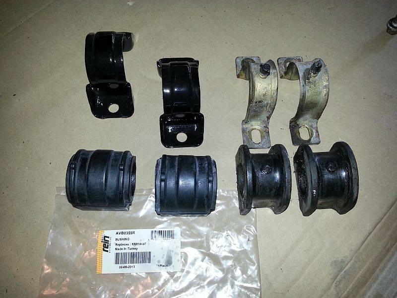

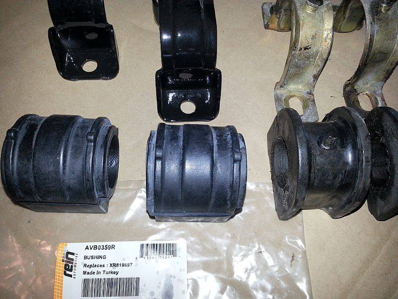

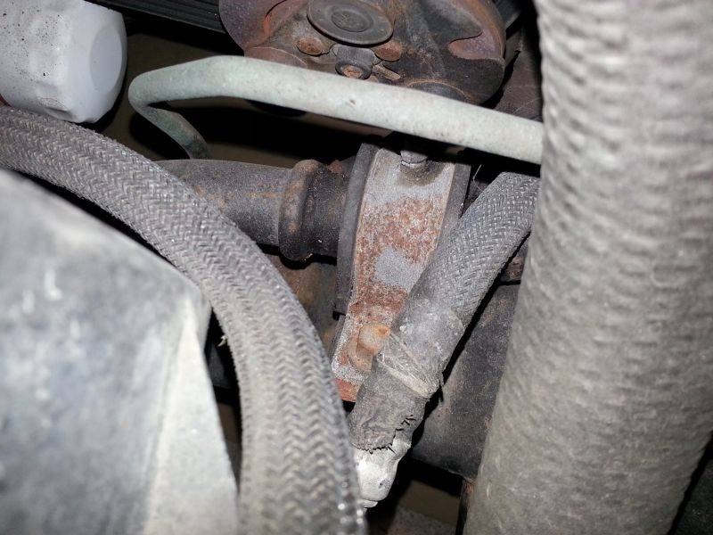

Removed the Universal Energy Suspension bracket and bushings as they are not a good fit.
Replaced with original brackets and REIN Jaguar bushings.
Fits like OEM. Bolt near the DCCV was a PITA again!

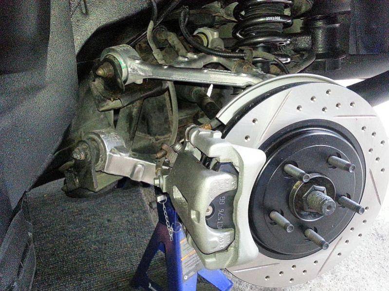

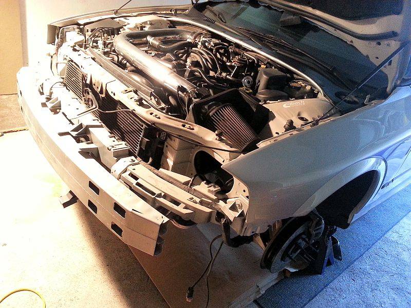

Front end is still apart somewhat.
Loosened up the Upper Control Arm nuts.
Second that.
thanks guys... I hope they last longer then a year !?!?! (we'll see)... I was able to buff his pretty smooth without the urethane (contemplated not even adding it) if they wear faster then mine (not so smooth), I may be on to something.
If so i'll try on a "not so perfect" polish, perhaps the urethane needs more to grab on to....hmmm
