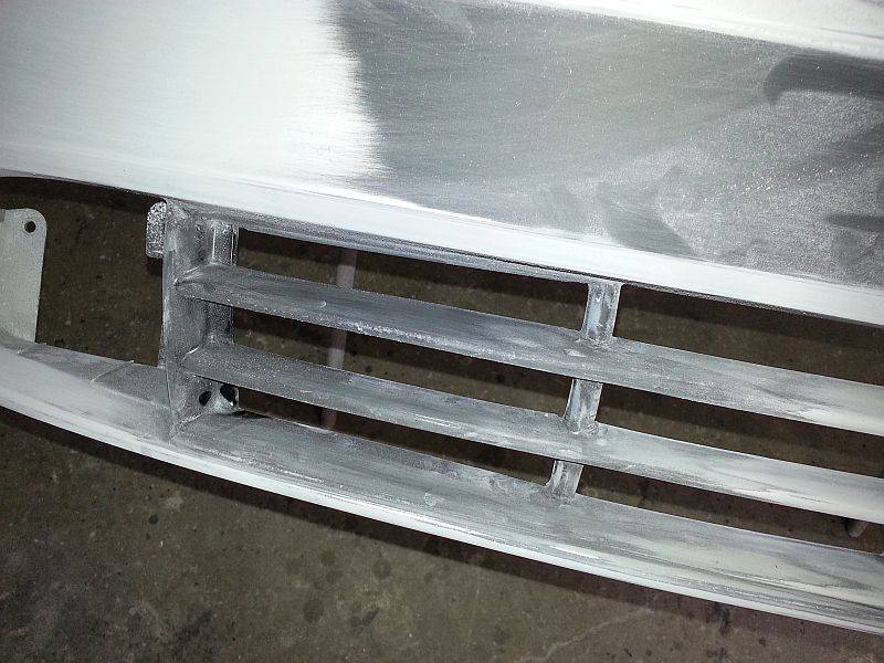

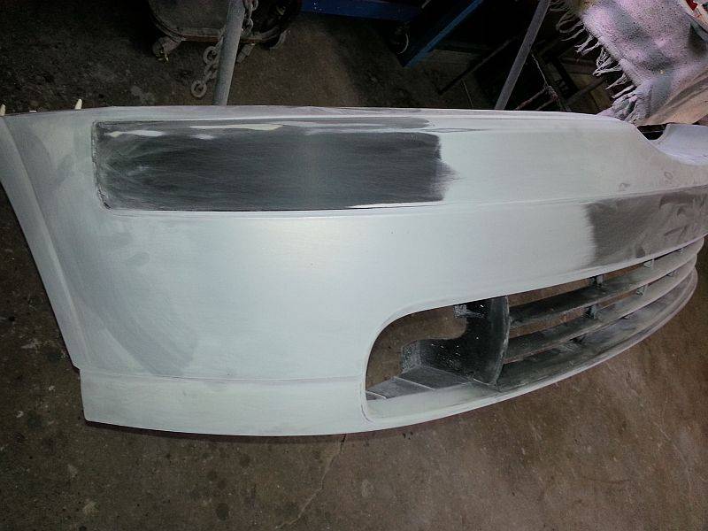

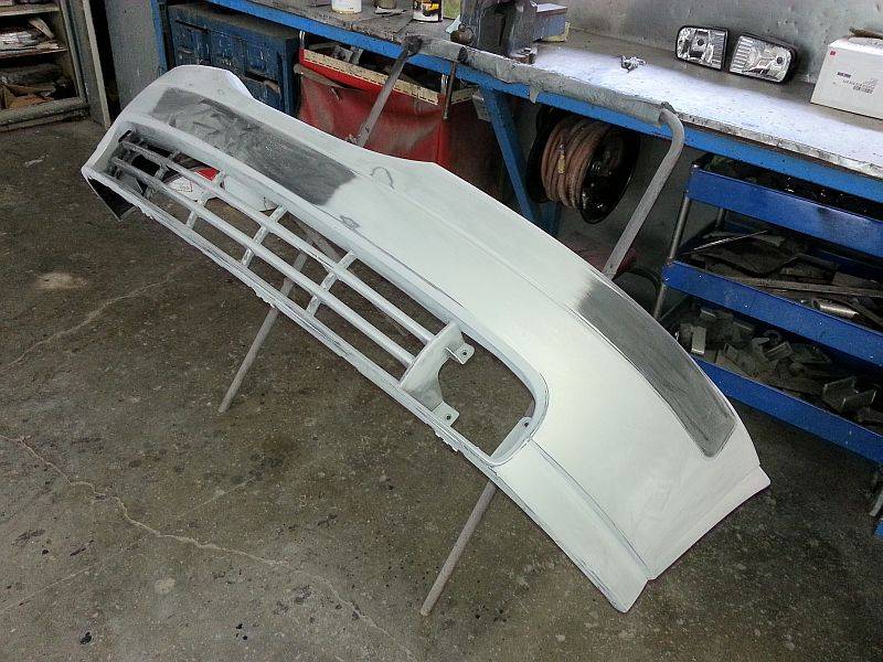

In progress ...
side markers DELETE, plate holes DELETE and tow hook cover being molded in as if it was never there.
other parts being worked on are the trunk lid, spoiler, rear surround color matching, McLaren grille.
Silver Frost Metallic color match done by means of sending out my gas door.
Should be all finished this upcoming week.

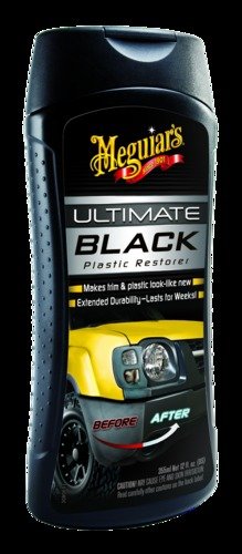

After that, I've had good luck with this for shine... not very greasy and seems to penetrate and stay a bit longer then your normal "shine".
